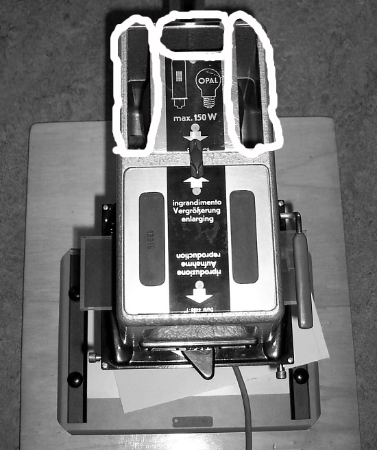

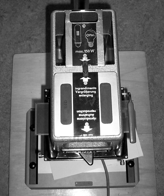

Sorry for the crappy photo but I hope you get the idea... Mine is an older Durst but in principle they look pretty similar to each other regardless of age. As you can see, there are a few holes in the top, in the upper part of the photo. Light and heat gets out of there, but I have not seen any problems with the light, as long as it doesn't fall onto the easel. Make something with a few small holes to let the heat out and you'll be fine.
Not sure I see them. I am guessing that your enlarger also has a mirror compartment in the front, and a light bulb compartment in the back, so we must be talking about the cover of the back compartment. Are the holes that you are taking about round or prolonged?

Sorry for not answering straight away - I've been on a trip. Yep, the holes are the elongated ones on the left, right and top side in the upper part of the (crappy) photo. See below. And the construction in the lower part is the same as yours with a mirror box and a condensor lens in it. Hope it helps you a bit further along, otherwise get back.

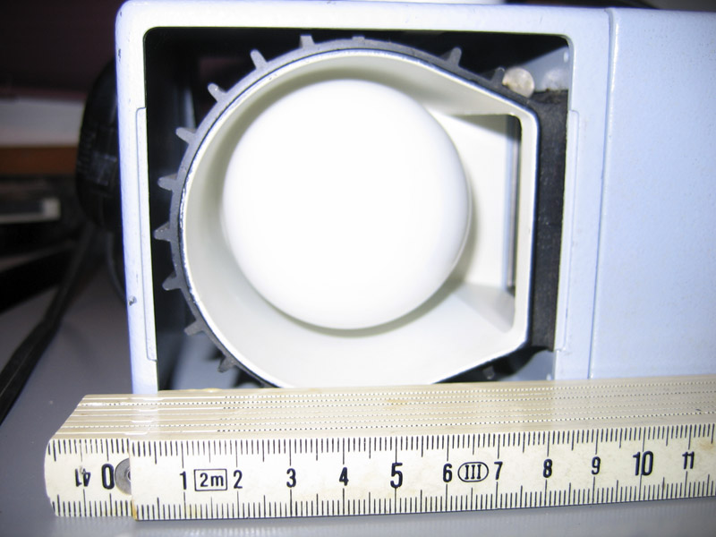

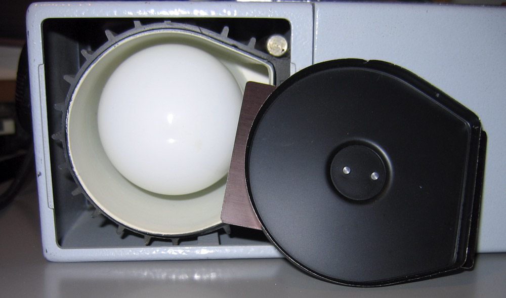

I have an M600, here are some snaps. Mine doesn't have the red locking tab, but otherwise looks similar to yours. My cover has no holes. The ruler is in cm., divide by 2.54 if you are in the US.

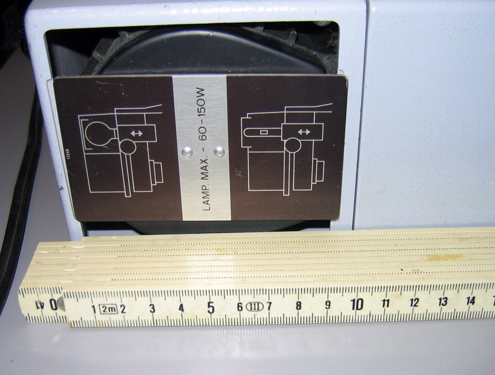

Forgot to include the shot showing the inside of the cover...

Aha, thanks a bunch, that's informative. I see that M600's lamp compartment has a "lip" (i.e. a protruding border), around which the cover snaps securely, thus trapping the light. The M700's heat sink that houses the lamp does not this lip, so I can't imagine a cover that would shut the light inside. On the other hand, I'm glad that M700's bulb compartment is squarish: it would be harder making a cover for the irregular shape of the M600.
I'm having a bit of a problem with making a cover myself. I've made one out of a tin cookie box, using some aluminum foil as a "gasket", to achieve a better contact. It fits pretty snugly, BUT in the total darkness I can see quite a bit of light leaking *down* from under the lid: this light ends up shining on the paper for enlargements bigger than 5x7 (for 5x7 the reflected light is just next to the paper easel, but doesn't reach the paper).
I wonder if I can use some kind of heat resistant rubber as a gasket between the cover and the heat sink?.. Any ideas what kind of rubber I can use for this?
