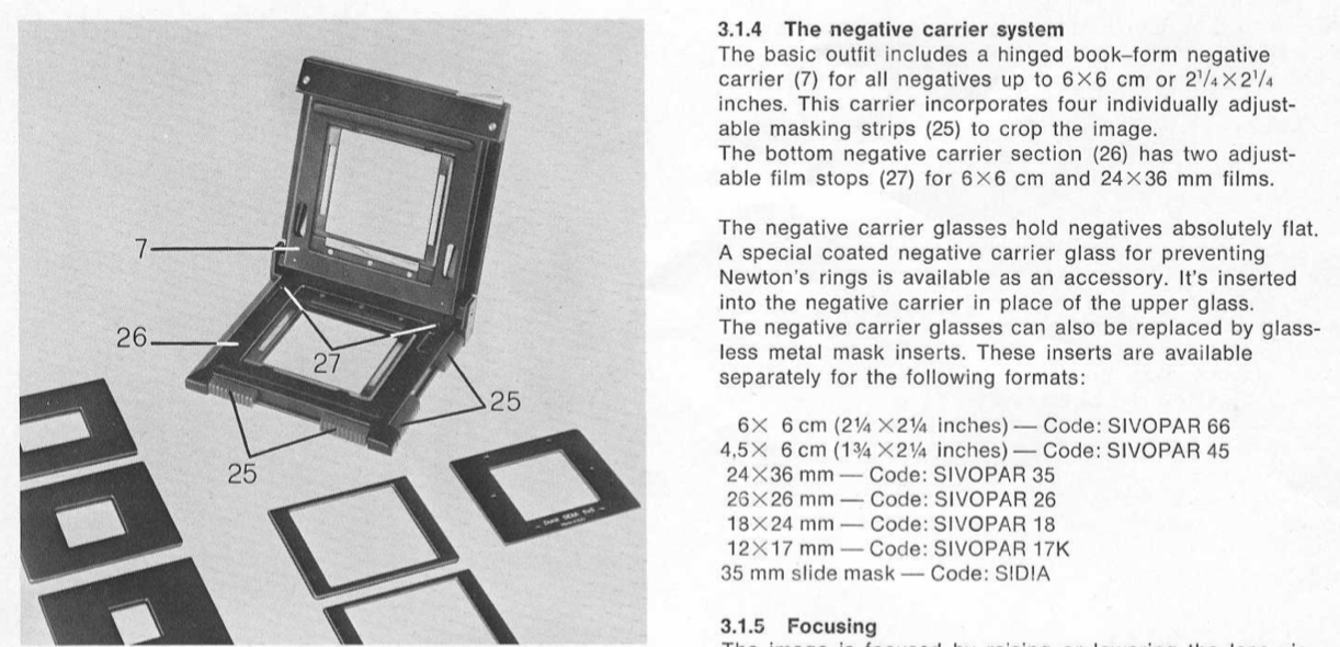

AN glass always goes just on the top. NEVER on the bottom.This picture is from M605 manual.
Thanks for pointing that out! I was miss leaded by the two types of AN glass that i have, but after your comment i have reviewed their description and yes you are correct the AN glass is only for the upper part of this carrier.
Apparently the guy who sold me my Durst AC707 included AN glass for another negative carrier type which can have glass on both sides.
