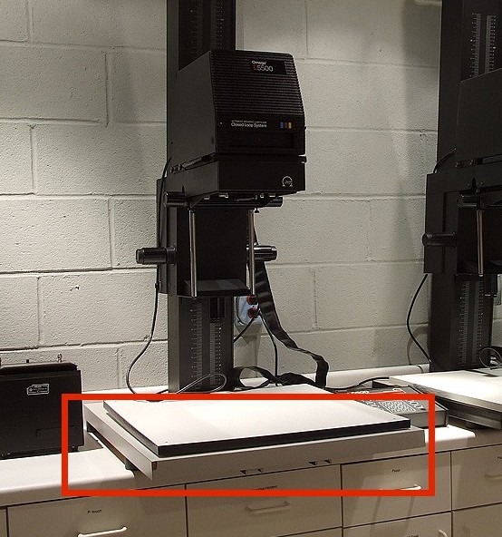

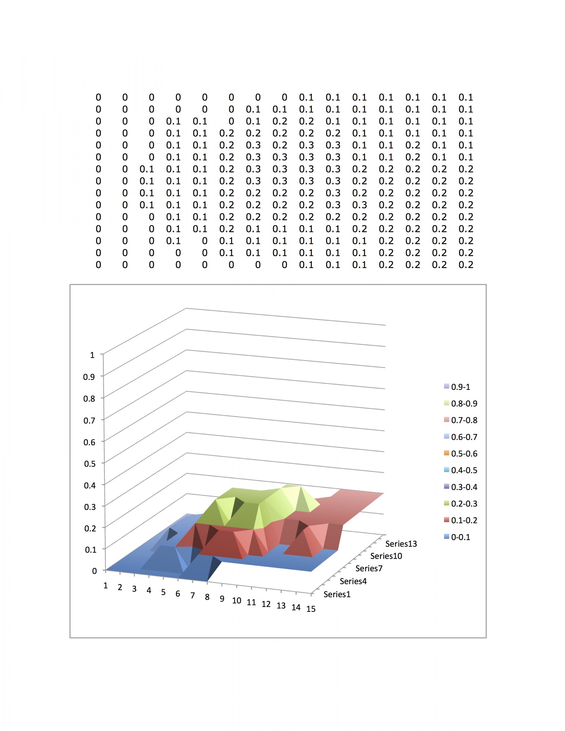

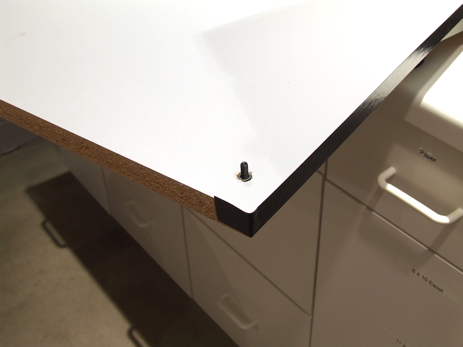

If the lens-to-negative alignment is out, the shims under the baseboard will need to be quite large. You could make a 'false baseboard' with adjustable feet like below. However, if the lens field is curved also (as seen in the last image), simple planar baseboard corrections will not make the situation entirely in focus.
