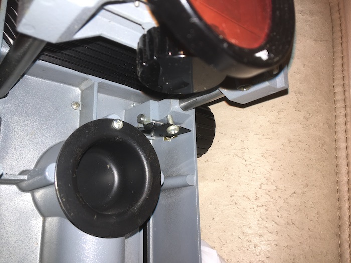

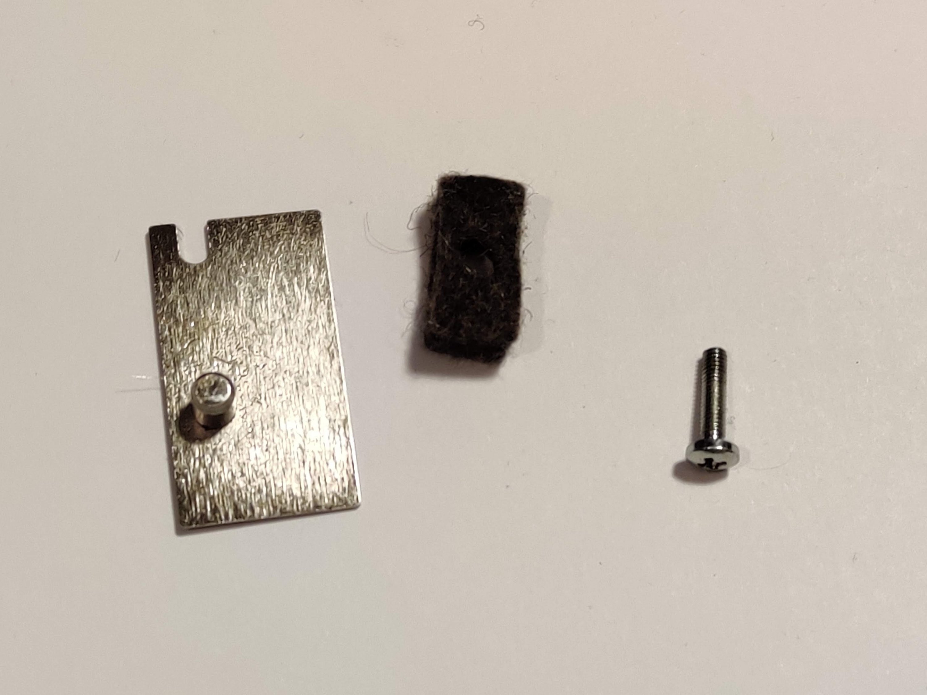

I recently picked up a Durst M605 Color from a friend and was messing around with it a little before assembling it. I essentially got it new in the box, so some things were a little stiff so I was trying to figure out how to loosen the focusing mechanism. In the manual, on the 10th page, it mentions a screw underneath the friction drive and mentions loosening it to adjust the amount of friction it has. Only problem is a loosened it a little too much and the screw ended up falling out along with two other pieces. I'm not quite sure where the two other pieces go, so if anyone out there has an M605 and could send me a photo of their focusing mechanism, that would be great!

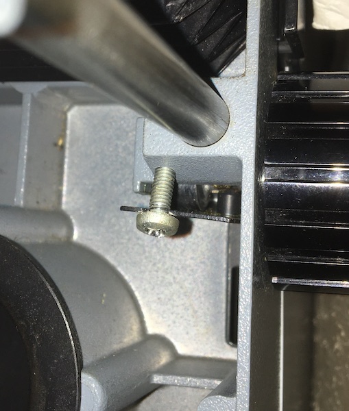

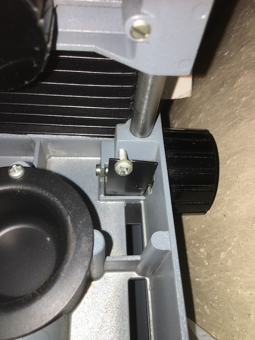

The slot goes up, and left, the bottom goes behind the ridge in the body casting and the protruding pin goes toward the shaft, In looking at my pictures, I'm not precisely sure where the felt pad goes, I think it must go under the pin. My enlarger is a M-601, but the mechanism looks the same. I hope this helps. BTW, mine has a color head, so has a cover where the lamp goes on a B&W unit.
I can make additional pics if you need.

Got it! Thanks a ton! This was puzzling me all day.
