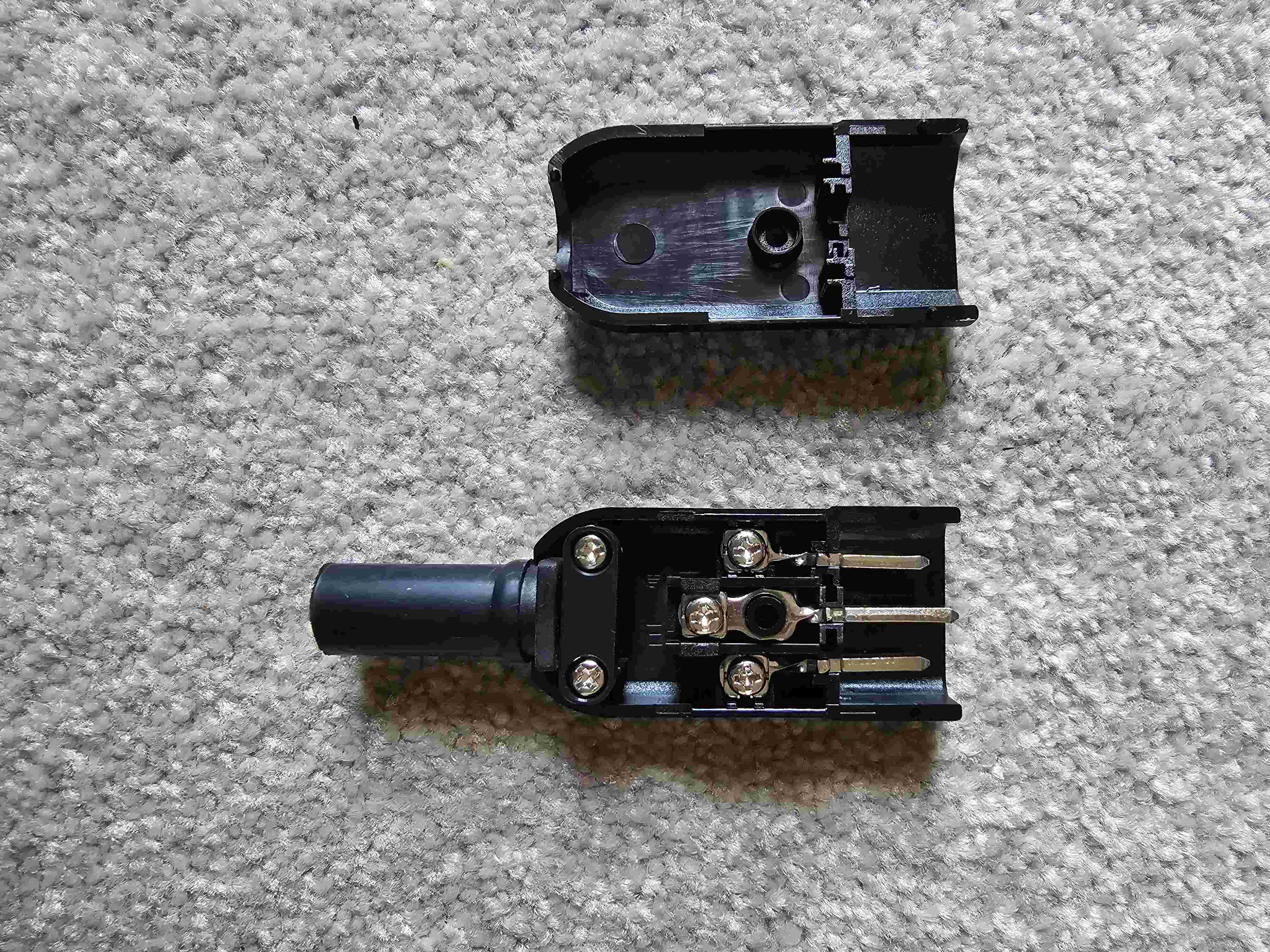

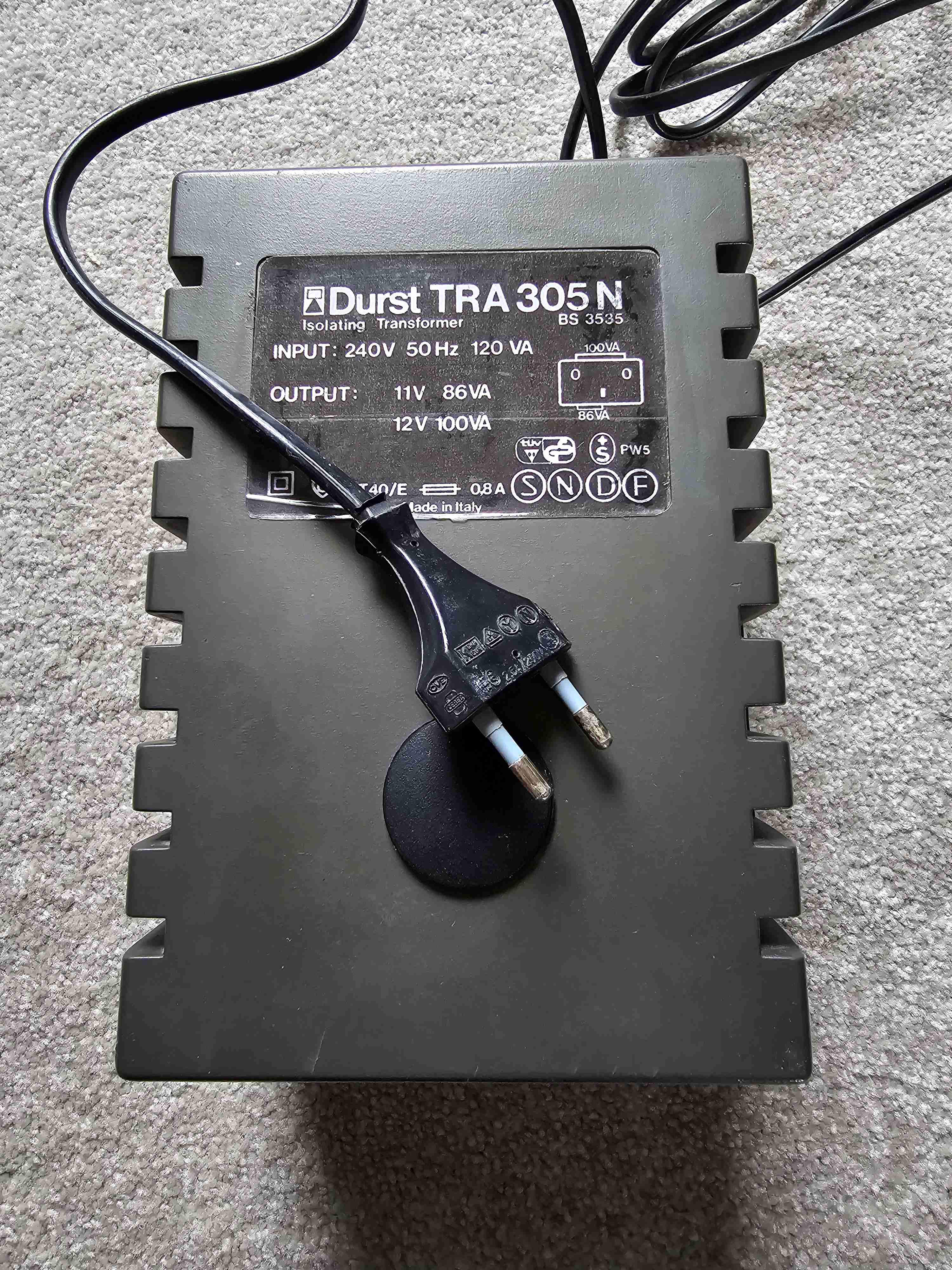

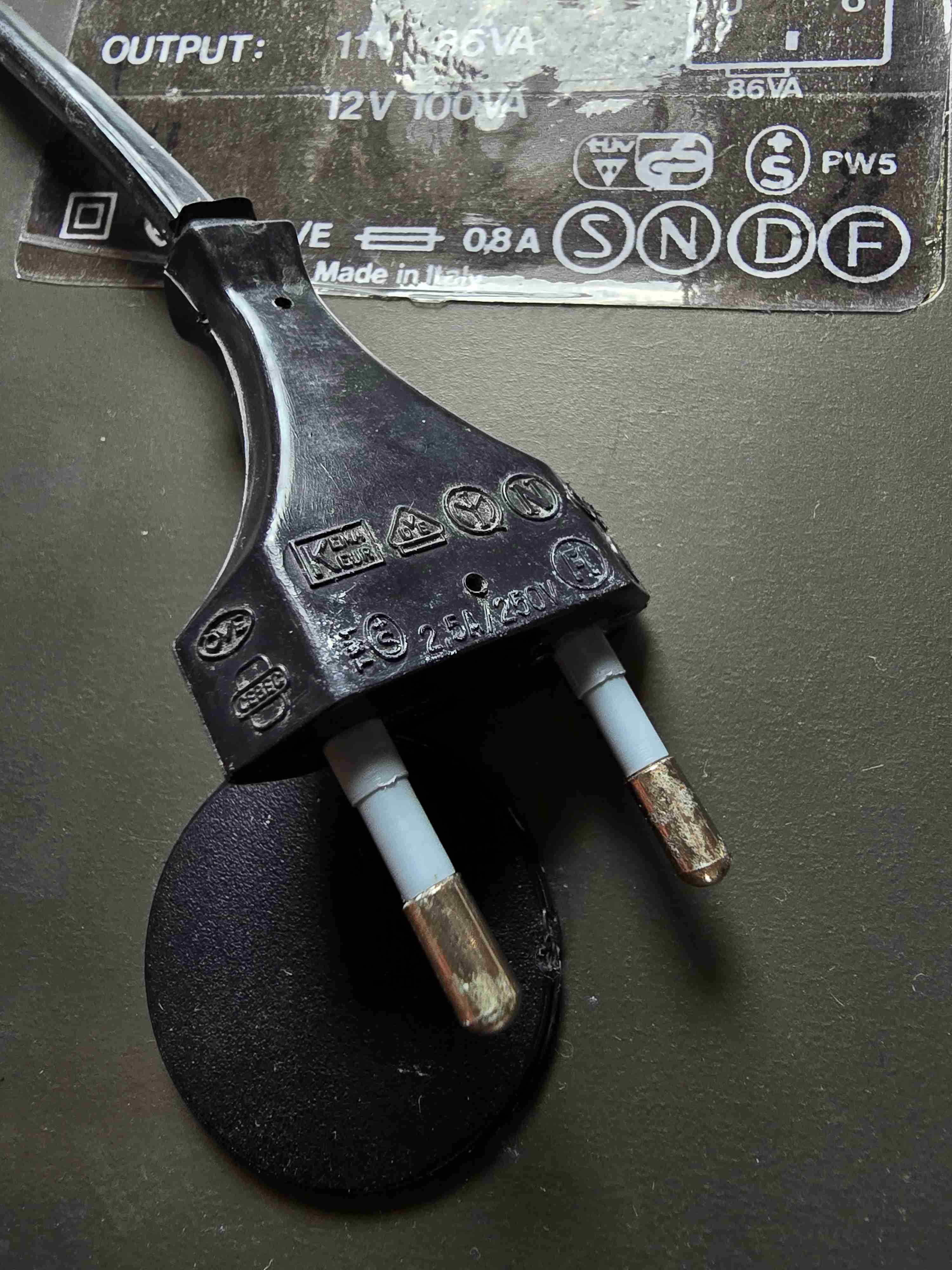

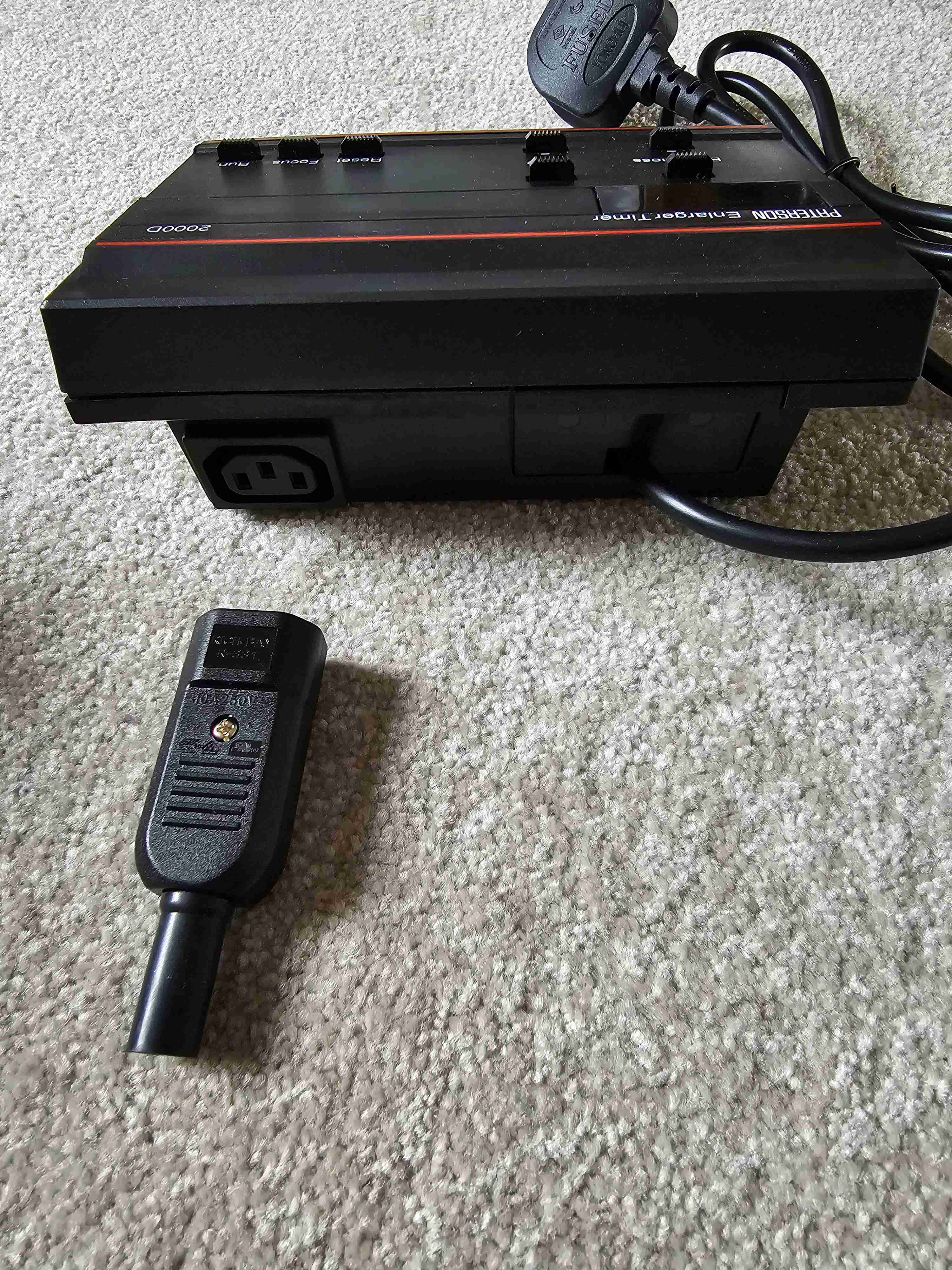

Hi guys, thanks for all the responses. Apologies, it probably would've been clearer if I'd included photos first so here you go!
The first two are the transformer with a moulded 2 prong plug which I assume is a europlug but curiously the transformer seems to be to a BS standard? Either way I'm guessing it doesn't have a ground wire. The transformer is a plastic housing, as suggested, and has a double insulation mark on the label. The third/fourth photo is the timer with the socket on the LHS and as you can see I have a 'kettle' lead adapter to take wiring. I guess the crux of my question is, can I cut the transformer plug off and wire it in to the kettle adapter or do I have to look at a complicated set of adapters / new transformer?
Apologies for the dumb questions but I'm not an electrical genius as you can probably tell. Just don't want to start cutting things and do some irreparable damage to the enlarger. Or me.
Again any further advice appreciated.

You can wire those up in any responsible way you prefer. Just connect only L and N, and leave safety GND disconnected. I'd take a trip to the local hardware store. Personally I prefer to keep the original connectors in place and buy or make an adapter.

Thanks Koraks. Yes, adapters may be the best way, at least at first. Unfortunately can't seem to get a single adapter that'll take the europlug straight to the kettle socket so will need to use the two step approach I think. Failing that I'll try rewiring. What's the worst that can happen!
Anyway, thanks for your help.
