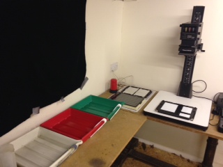

Hello, this is my first post, nice to meet you all!
Having not been in a darkroom since I left college 8 years ago I'm a little rusty so bear with me.
I've been given a Durst M605 Colour enlarger and other darkroom equipment by a friend and set it up yesterday to make B&W prints. I had it all ready to go and on the first test strip the timer stopped working halfway through. I changed the fuse in the plug and all worked fine again. Made a few prints successfully. Then when making a new test strip, when pressing the button on the timer to expose for a few seconds the enlarger bulb didn't light up. The timer seems to be working still (it has a little red light and which comes back on after the set exposure time) so I think the bulb in the enlarger head may have gone.
I downloaded the manual but can't work out how to get to the bulb! Having looked in other threads it seems that I need a 100w tungsten halogen bulb. Does it need to be a certain size? Does anyone know where I can get one in London (or online?)
Any tips much appreciated! Thank you.

If you look at the top of the head, there should be a panel retained by one or two "screws". Give them a quarter/half turn and the panel should just lift off.
As for the lamp, expensive, but on most high streets: Dead Link Removed
Silverprint may well have stock, or you could try a specialist lighting store - Go for a Xenophot rather than a long-life lamp (shouldn't be more than £3-£4 each).

Thank you! I thought it would be a screw bulb instead of the 2 pins, so this is really helpful.
I'll have another look at the head this evening, I figured it must be fairly straight forward but I was worried about breaking it!

I like your darkroom! People seem to think that you need a particular timer that costs hundreds of dollars, an uber-expensive Schneider lens, or fancy trays and easels. No, you don't. I get by w/ an old Nikkor, some inexpensive cat litter trays for processing, and some push pins in my baseboard to keep the enlarging paper from shifting. No complaints so far on my print quality.
