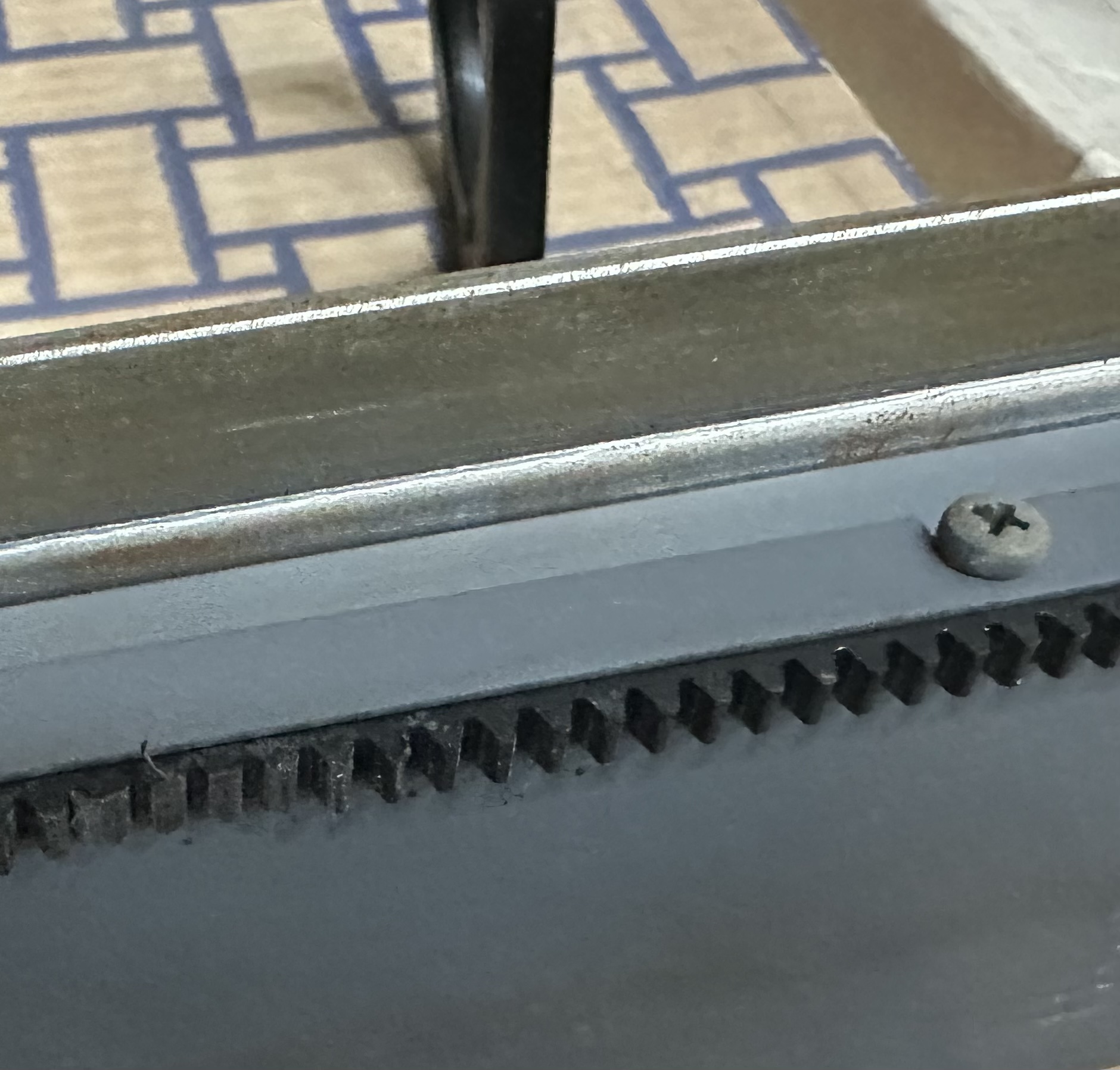

Does anyone know if this rubber track material (or something else) is available for replacement? I received the M601 enlarger as part of a darkroom lot and I’d like to get it repaired if at all possible, and I’d like to do so without cannibalising another enlarger.

That’s a great idea, unfortunately, it’s damaged like the pic in multiple places top to bottom and I imagine I would lose ~50% of the travel at that point.

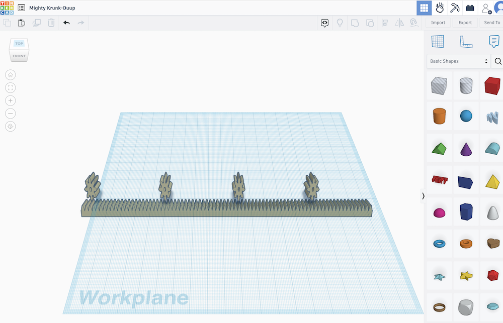

Just to see what happens I opened up free TinkerCad and an editable rack and pinion from Thingiverse. Making an appropriate rack looks doable with minimum prior experience:

I can handle basic CAD design and have ordered my own PCBs from JLC on many occasions. Didn’t know they were also in the 3D printing business, that’s pretty cool.
Knowing this is called “rack” might help with finding something pre-made if I can get some decent measurements from a section.

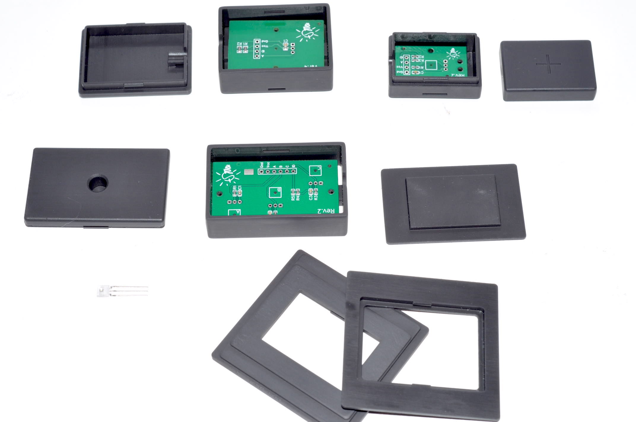

I was very impressed by the 3d printing JLC did for my shutter/meter tester. The parts don't even look like 3d printing.

Interested in your tester, is this an open source project? I built an Arduino tester recently but it’s not reliable at speeds above 1/60.
The plans are all on GitHub. The physical part is open source but the creator provides the Arduino software only as a hex file.
However, his firmware is excellent. He duplicates most functions of the discontinued Kyoritsu tester.
look at my simple shutter tester on this site. It uses an Arduino, measures shutter curtain travel correctly and measures speeds well above 1/1000s. Gives averages, deviation, flash sync etc.
