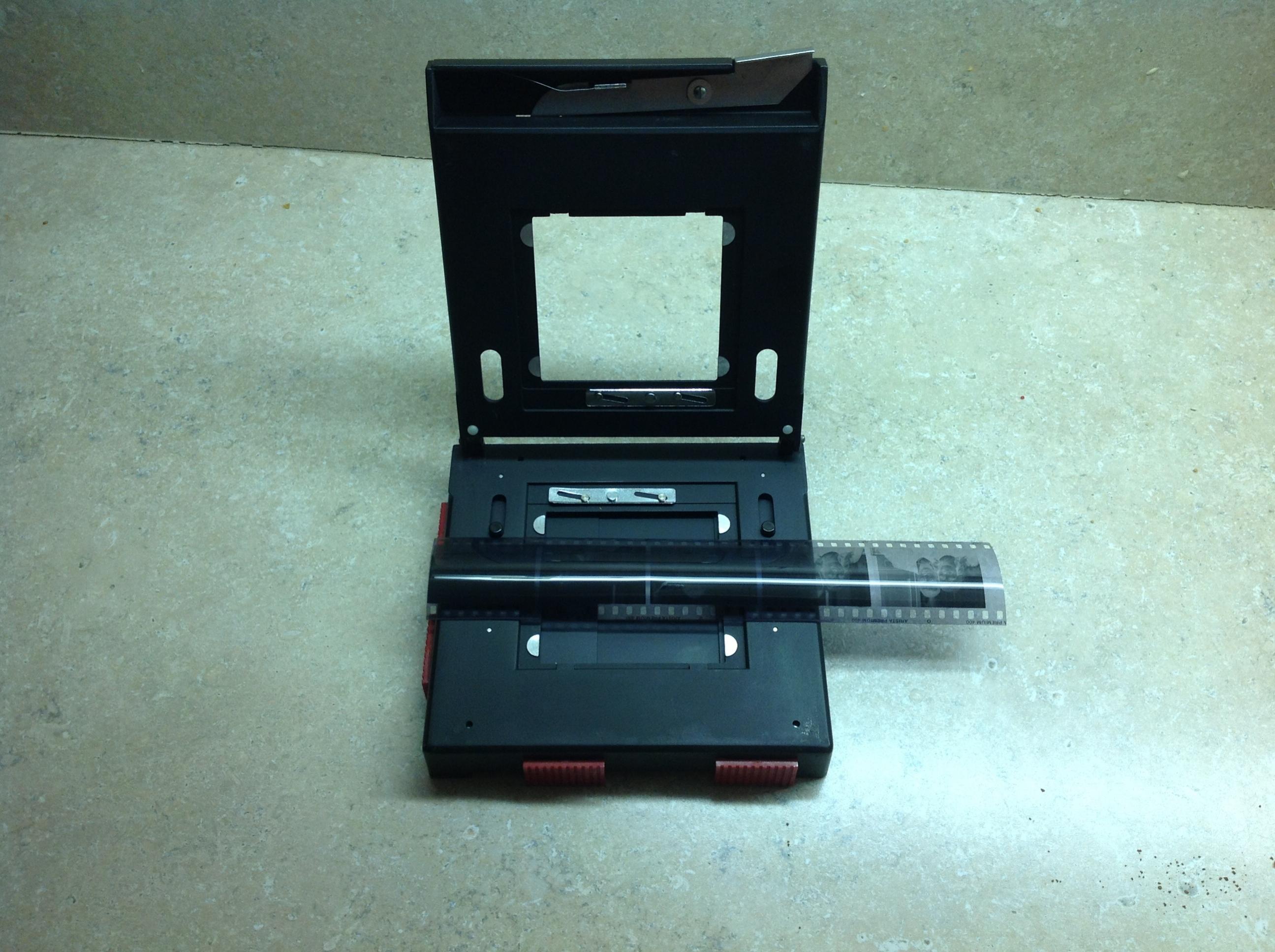

My, new to me, Durst 601 CLS-66 did not come with glass or proper inserts in the Sivoneg carrier. I'm checking if glass can be "cut to fit" at the local glass shop.
I'm unfamiliar with the Durst Sivoneg. I don't see film guides. So to use the Sivoneg with two glasses you just carefully center the negative strip so the masking blades can evenly cover the film edges? Is that how it works?
If I can't get glass installed locally will a carrier on the 605 work in my 601. BTW, the 601 is light tight, impressive.
I'm looking for the correct Sivopar inserts for 35, 6x645 or 6x6. Are they installed on the bottom of the bookform Sivoneg with the glass left on top?
What is the collective experience, likes and dislikes, related to using the Sivoneg?

The carrier I have for my 601 is a blue/grey metal unit with red plastic bits to move the masking blades. There should be two black plastic pieces sticking up from the rear of the lower section. These are the negative guides which slide forward or back for 35mm or 6x6. I have glass in the lower section and a 6x6 mask above. For 35mm you could do the same, or use masks top and bottom for a glassless carrier. The glass I use came from a carrier for a different model enlarger, but it was the right size. Have a look around on eBay, etc and you may be lucky.

Alex, I'll look for registration pins on the lower section of the bookform Sivoneg. My carrier was configured for slides and is charcoal in color.

For the 601 you can use the masking carrier or 35mm or 6X6 glassless carriers, I dont know if Durst made a 6.45 for the 601. I use the masking carrier, when using 35mm I tape over the bottom glass so I can center the negative without having to check to see if I am centered.

PHD, so the bottom glass results in no registration pins. You eyeball centering the neg strip or use your tape method.

I am pretty sure my carrier does not have pins, the masking blades move freeley which is why I just use tape. If you really wanted to get fancy you can ask the glass shop to frost one bottom glass insert for 35mm and have one unfrosted for 6X6 or for that matter another frosted for 6X45. I had considered doing this but too lazy to find the time to hunt up a shop. Also not sure what it would cost.

PDH, I can visualize it now. You leave a 35mm sized window and mask most of the bottom of the glass with tape.

If you use the SIVOPAR 35 with top and bottom inserts is there space to get black lines using the masking strips?
Do most folks like to use glassless inserts vs the universal carrier?

When you enlarge 35mm using a Sivoneg carrier, do you slide the two posts down as pictured in the photo?

When I got home I check, mine has the pins that slide, tI was thinking of pins that worked with mask blades to set 35mm. The reason I use tape is the pins only mask horazontaly, by taping I can mask to just the right size. I recalled using the pins when I first got the Durst but found it a slow process for 35mm. I know that there is a glassless 35mm for the 601, seen a few over the years on ebay, just never bid on one.

Back to the picture of the carrier. Do you move the pins on the bottom of the Sironeg down for 135 and back up for 6x6?

The two posts that stick up are adjustable film stops for 6x6 cm and 24x36 cm. A better description was found in the M605 booklet.
The film stops slide up and down to accommodate the size film.

eBay UK has lots of Durst parts as these enlargers were sold extensively here. Item 221173456625 is a 6x6 insert ending 13 Jan and sitting at 99pence (2 USD?). 221173403111 is a pair of 35mm inserts at 5.50UKP (10 USD?) ends 13Jan. I don't see other inserts at the moment, but they appear quite regularly. Your carrier is the same as mine, but different colour. Inserts or glass sit in and are held by sliding catch. Glass needs a bevel all round to fit.

I missed this thread earlier, somewhere I have some spare glass. The problem is the thickness as it can no longer be sold direct to the public, 2mm is the minimum thickness. I still have a small supply of 1.5mm gl;ass which is ideal for these neg carriers.
My preference with Dursts is to use glass on the bottom and the metal frame in the top. I made my own 35mm masks back in the 1970's and still use them today. It was very simple to do using thin aluminium.
