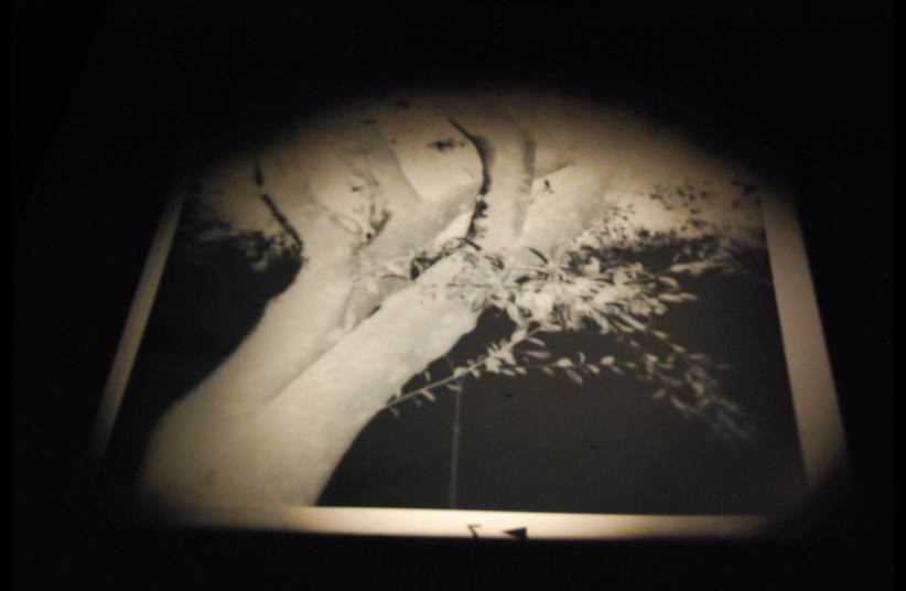

I have just bought a Durst M601 enlarger. Mounted it and started playing with it.
It came with two lenses: 50mm and 105mm.
With 35mm I have no problems, image looks ok but the problem is when I try it for 6x6 negatives.

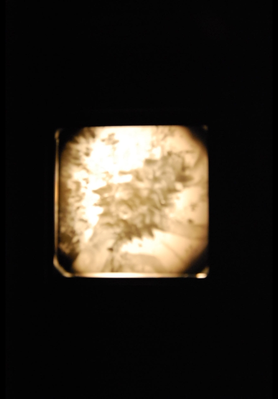

I think the condenser light is not covering fully 6x6, I have mounted it as the manual says (curved face to curved face). This is how it looks without lens:
And how the enlargement looks (with the 105) I've tried minimum and maxim size, still the same:

Some info on photo.net here:
Just to clarify, the 'square' condensor is called a "Sivocon 80" (it's written on the side). The 'round' one is a "Sivocon 50" and has the same square frame as the 80.
For 6x6 you use two 80's, with the curved surfaces facing each other. For 35 mm you use one 80 and one 50, again with the curved surfaces facing each other. I actually put the 50 on the bottom, not the top, which gives you a little bit more light, but the illumination is even whichever way up you have them.
You can use the 6x6 setup for 35 mm, but the light level will be lower and you'll have longer printing times. The 35 mm setup leaves the corners of a 6x6 frame very dark.
So you are missing one of the two Sivocon-80's needed?
There's two on German ebay right now, shipping ww.

Thank you, exactly that's my problem. Unfortunately the manual misses this information. Probably the person before used it only for 35mm, the seller on eBay missed this information, somebody will get a bad review :smile:.
