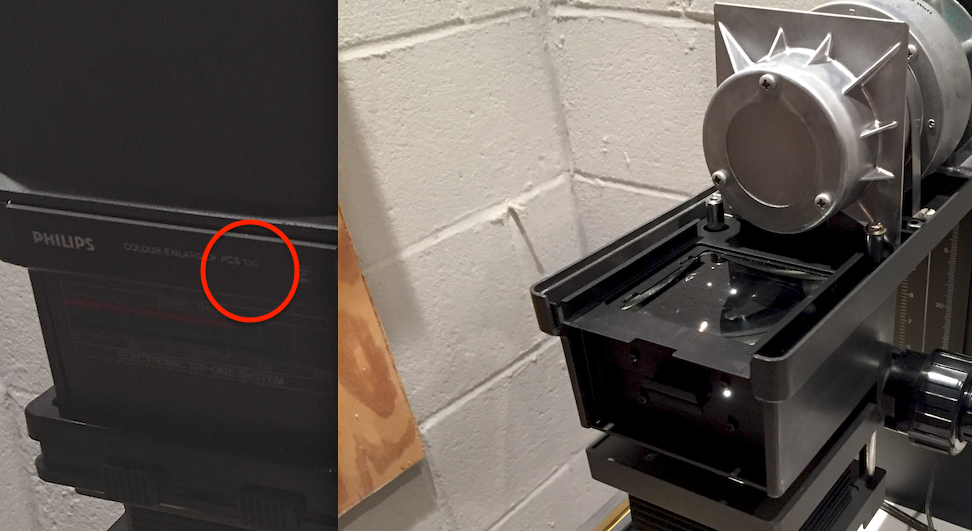

By the cord it looks like you have a PCS 150. Is that correct? My PCS 150 shows "130" on the front also, but this may be because the light sources between the two are interchangeable. See in the picture the PCS 150 light source in my enlarger with "130" on the front.
If you can convert yours back to the PCS 130 (light bulb), it won't require a power supply any more.

Oh, thanks! I appreciate it!
I might try this and see how I get along with it!
