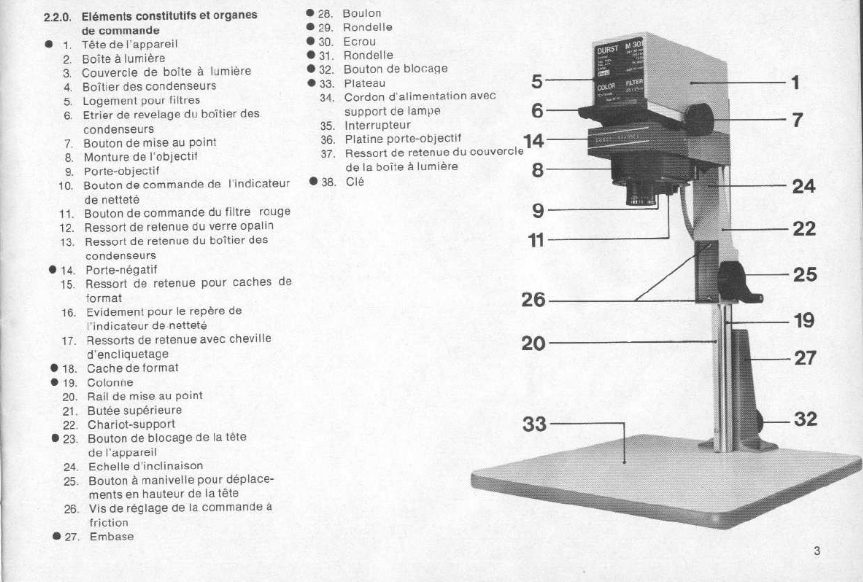

I have the opportunity to buy a good Durst M301.
I didn't buy it for time been because :
- I didn't see any film carrier. Does the film go into the head just like that ? Is there any problem with the flatness of the film, if the negativ isn't kept flat by a film masque ?
- I couldn't understand how the contrast filters can be used, where to place them. There is, above the film, like a little "door" that can be lifted. The filters go there inside ?
I would be grateful for informations about this twoo questions.

But here you can see that the filter drawer is at #5:
removed account4
Jun 21, 2003
29,832
Thanks for the manual AgX!
Hi Valentin
I think I have an M601, which is similar to the 301. .. you will see where #5 is pointing, that is a pull out drawer where small filters go. Mine had a small insert so filters cold easily be put inside the enlarger, but I stopped using it, I currently have a kodak polymax filter set that has a small dispenser that clamps onto the enlarger lens and the filters slide into that. The #6 is pointing to the negative carrier. I am not sure if all the Dursts have a GLASS carrier, or if all these models are able to take 35mm AND 6x6 ( or if it is just the 601 ) but the whole carrier pulls out. There may be sliding masks for the negative and it has fancy (read $$$$ ) anti-newton rings / special glass. Make sure when you purchase this, it contains ALL of the condensers. There may be several of them that go inside the head in different configurations to spread or compress the light for the larger and smaller negatives. Like with everything OLD, sometimes things get misplaced or orphaned. If it has the glass carrier, it will keep your film very flat. Its authentic Durst name is Silvogla if / when you buy the seller inspects the glass and there are no issues with it. Sometimes they can get damaged.

Thank you for your answer !
There is no filter drawer... the no.5 to the enlarger I saw is like a small "door" that you can lift and than.... no drawer !
Also, no film holder...
