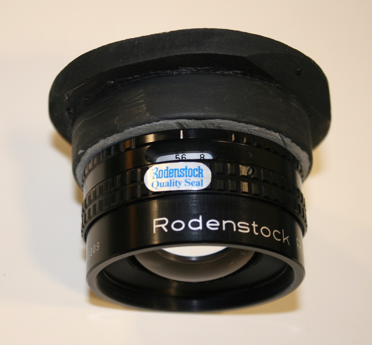

It is. I bought a Rodagon 150mm a while ago and ran into the same problem. I solved it for a few euros with a piece of plastic sewer pipe with a rubber 50mm fitting. Works like a charm! If you're interested I can make photo's. I guess the problem is that across the world sewer systems differ in sizes, so I have no idea whether this would be available in Australia.

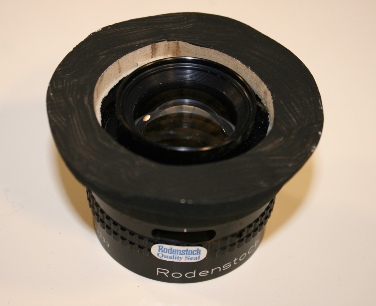

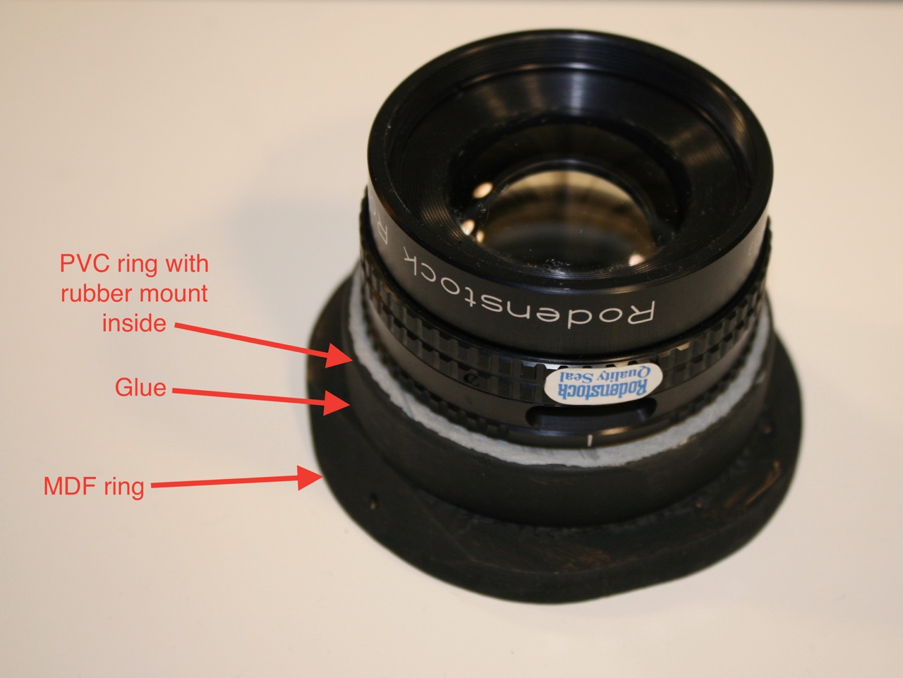

I use a PVC sewer or water lead connection, to connect 2 50mm pipes. See:
https://www.installand.nl/shop/leid...t-3100105000?gclid=CJajiajSx9ECFccp0wode5gH3Q
- sorry, it's in Dutch, but the picture gives you an idea what to look for -
Cut off one of the thick rings at the end. Make sure the cut is nice flat and level. The ring has a rubber on the inside. The lens thread goes in the rubber. Not a true screw mount but it holds the lens very tight and level.
I made a round board that fits in the mount of the enlarger out of MDF. The PVC ring is glued to the MDF board. Once the glue is dry and solid, make the whole thing (somewhat) black.
I know, it looks ugly, but it works very well!

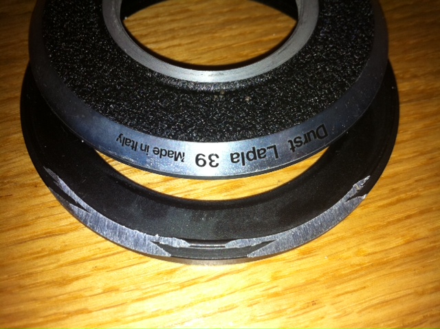

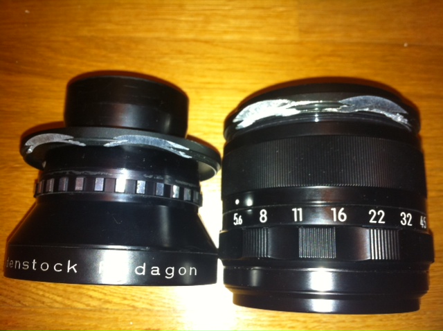

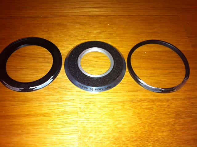

I'd suggest everyone looking for the right Lapla lens board to buy a filter aluminium step down ring: you should take the outer diameter of the lensboard that in most Durst enlarger is mm. 77 and for the interior the retaining thread lens size (in this case mm. 50). In my case I bought a 77-58 step down ring for my 210 Rodagon, a 77-52 and 52-50 for my 150 EL-Nikkor and for the 210 EL-nikkor I bought a 77-72 step down all for less than 15$. You'll have to file 45 degrees in 2 retaining pins/screw positions. 15 minutes work, very precise and cheap. If you need some extension you can look for some threaded extension tubes available in many lenghts at few more $ (10-15 on that site) to screw within the step down ring and the lens or between two step down rings.
Added pics of Rodagon 210 and EL-Nikkor 210 with this ring and a Lapla 39 plate for comparison.

Main advantage of this DIY solution is that's easy to mantain the parallelism on mounted lenses with the main structure.
