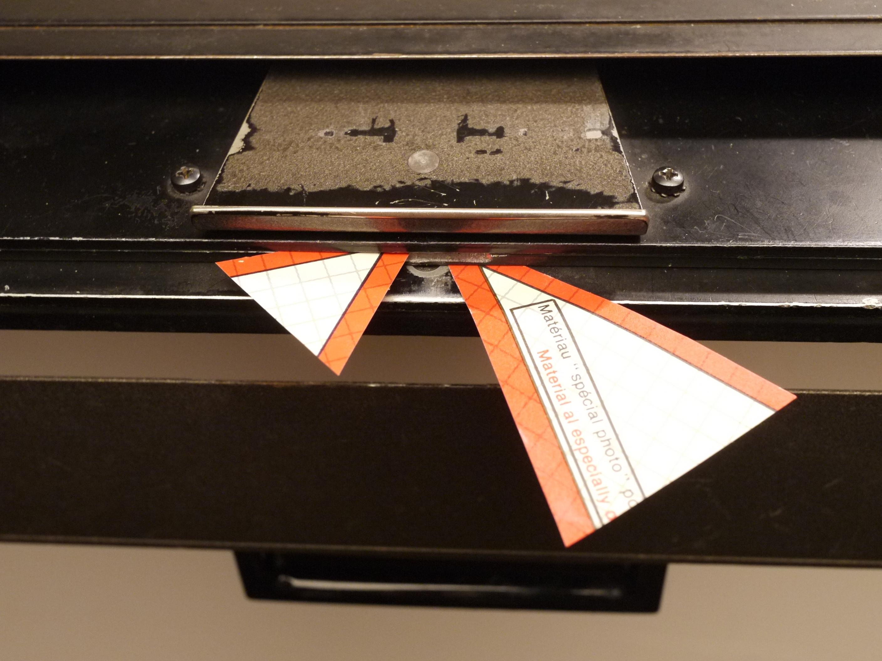

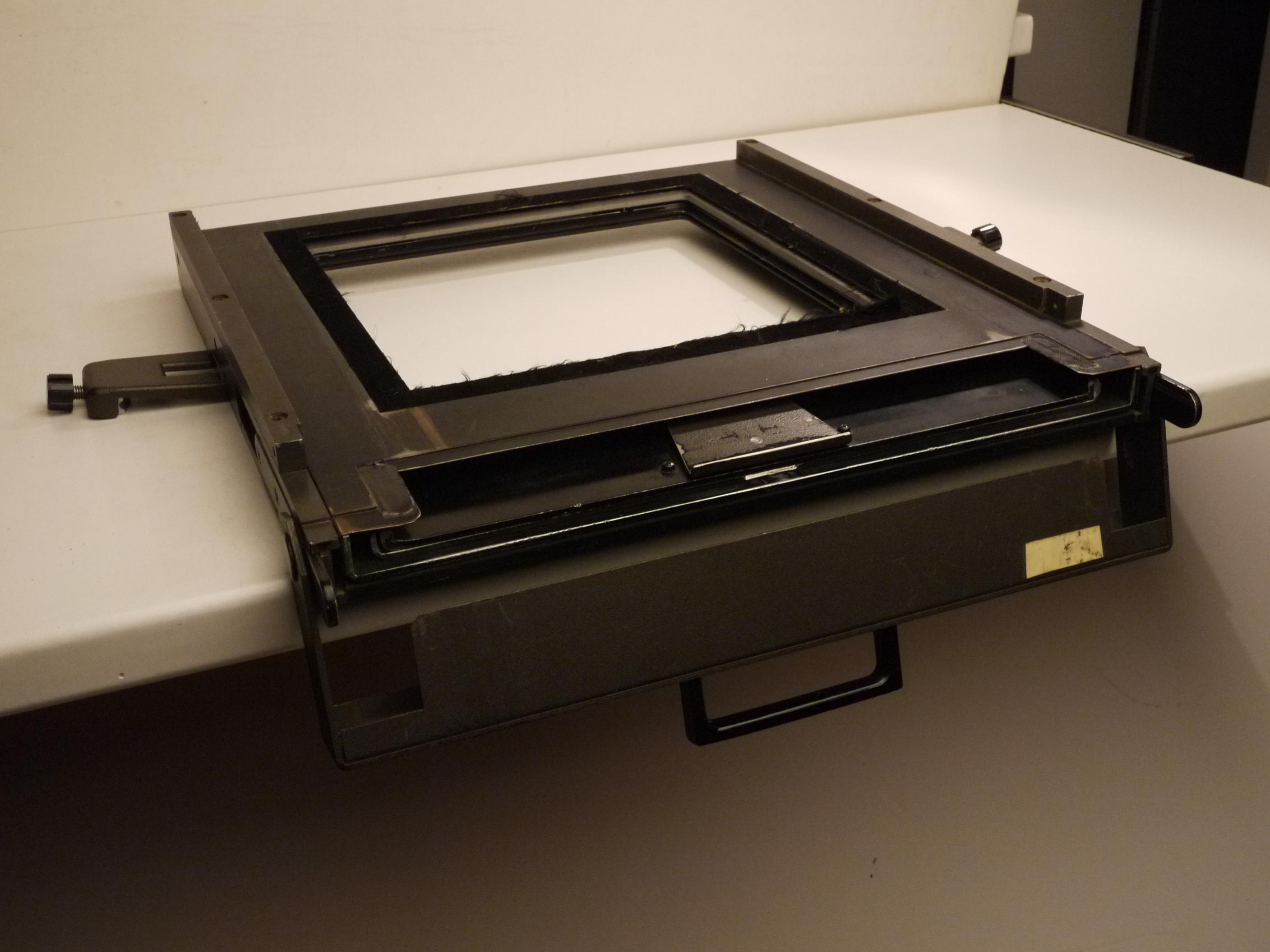

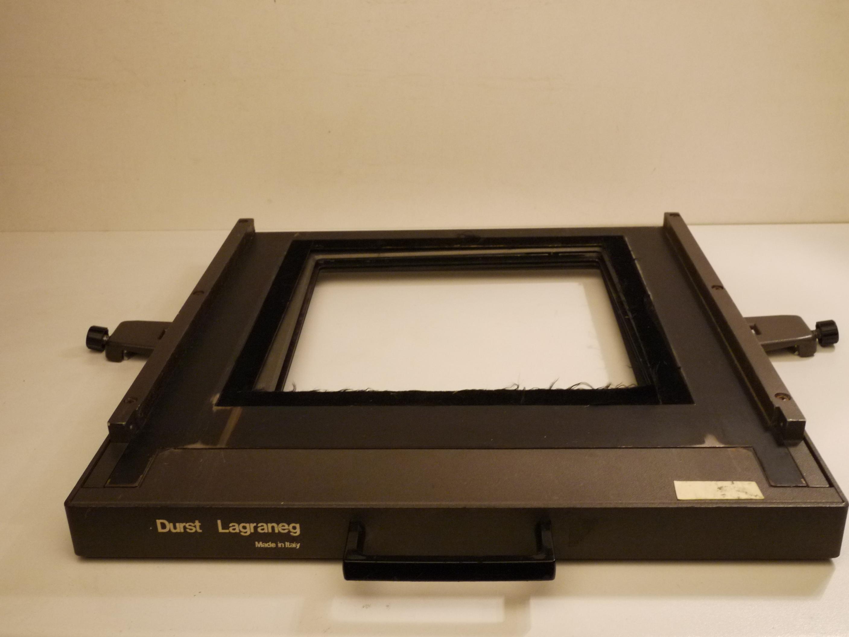

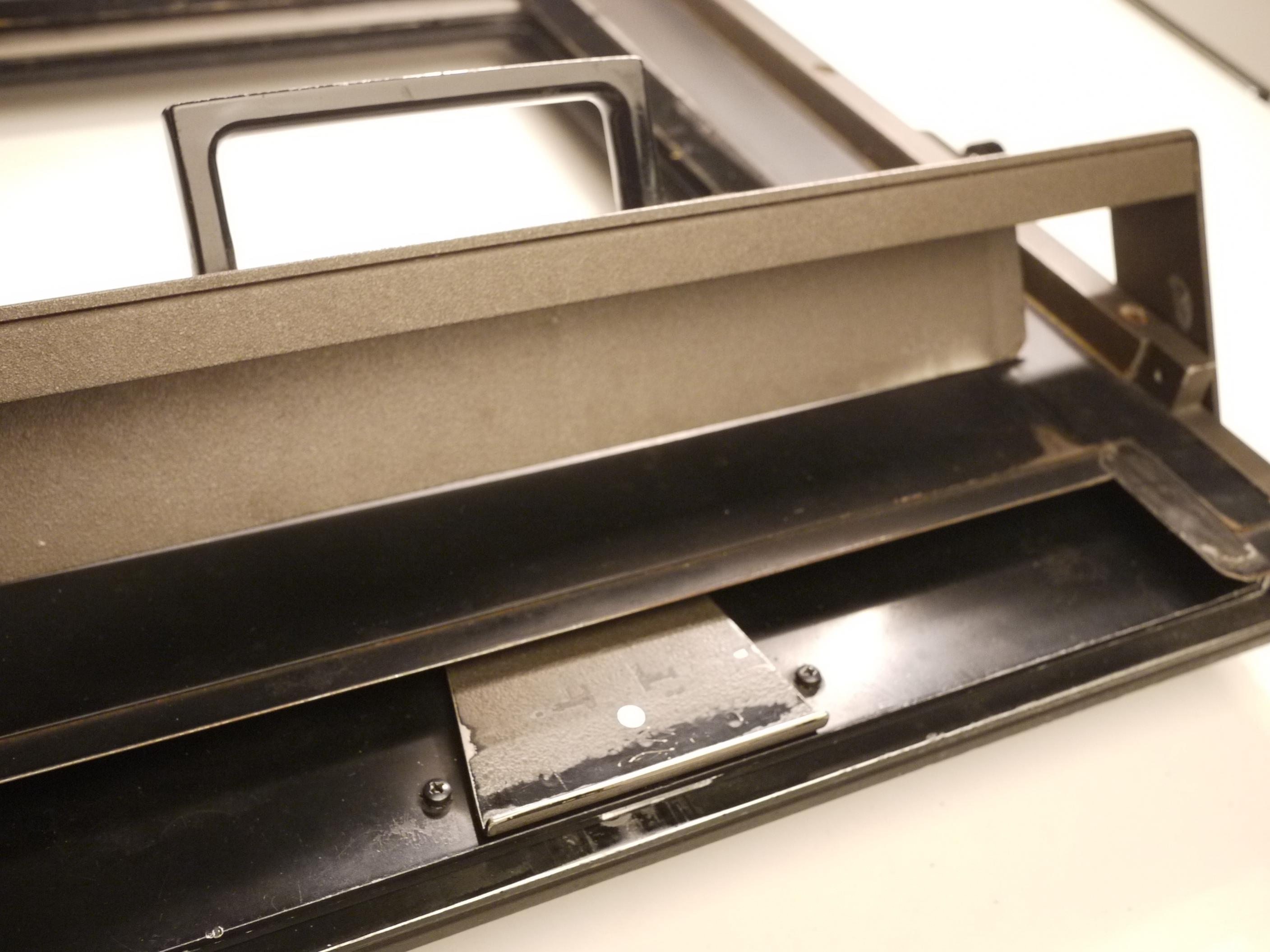

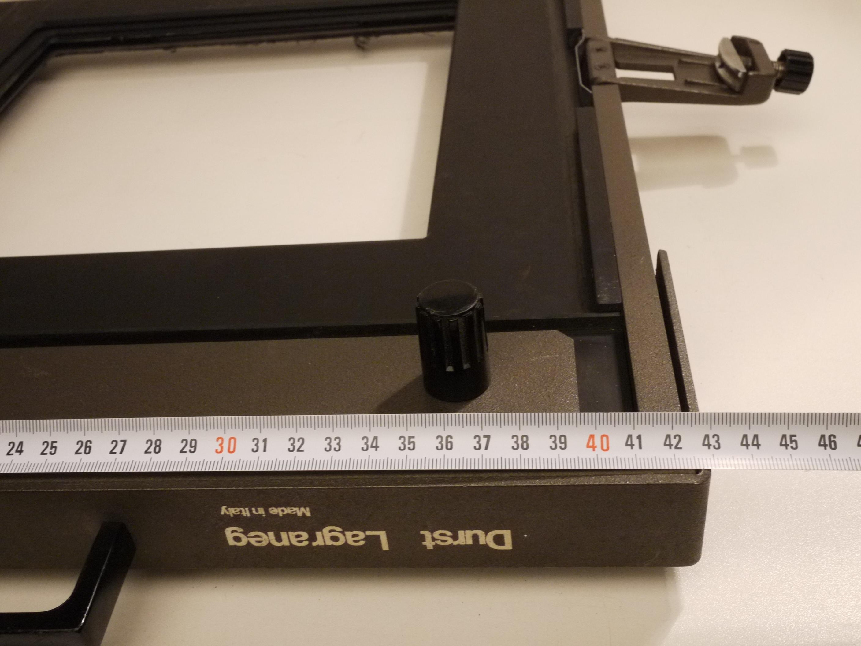

Sorry I wasn't clear enough: I have a LAGRANEG, but from a photo I saw on Jen Jensen's website, it seems identical to a LARANEG. Below, are a few photos I took of my LAGRANEG today (basically the same ones I've posted on LFP, plus two more).
The second photo is of the bottom side of the unit and it shows one of the two plastic lock-down knobs used to secure an internal frame which can be slid around a bit, allowing you to re-position the image on the easel (since you can't rotate the entire negative carrier as you could on, say, an Omega 4x5).
As well, I'd guess that this holder is part of a pin-register system. Would you agree?
There's an insert or carrier stuck inside this monster's mouth, from what I can gather. You can see the problem in the last photo —I photographed it with some paper arrows I inserted to make it easier to see the two levels of metal. Would you know how I can extract it without hurting the equipment?

From the pictures it looks like a Laraneg that has some modifications such that it will fit on a L184 chassis. (It does fit on your enlarger, yes?) Instructions for the Laraneg are in the L1840 manual.( http://www.jollinger.com/photo/cam-coll/manuals/enlargers/durst/Durst_Laborator_1840.pdf )
Push the negative holder in slightly against the spring, then the locking lever should spring up and the negative holder will come out.
If you need registration, there may be pins inside the negative holder, but you will need to locate the appropriate Durst punch.

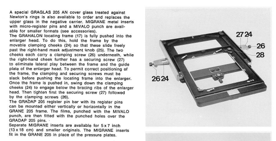

The Lagraneg looks like an early version of the Laraneg, or a later version of the Grane 205 that was used on the L184. I have attached an excerpt from the L184 manual detailing the Grane 205. Interesting how the name GRANE morphed into LA grane G.
Your Lagraneg looks complete, except for possibly the glass. Just clean it and use it!
