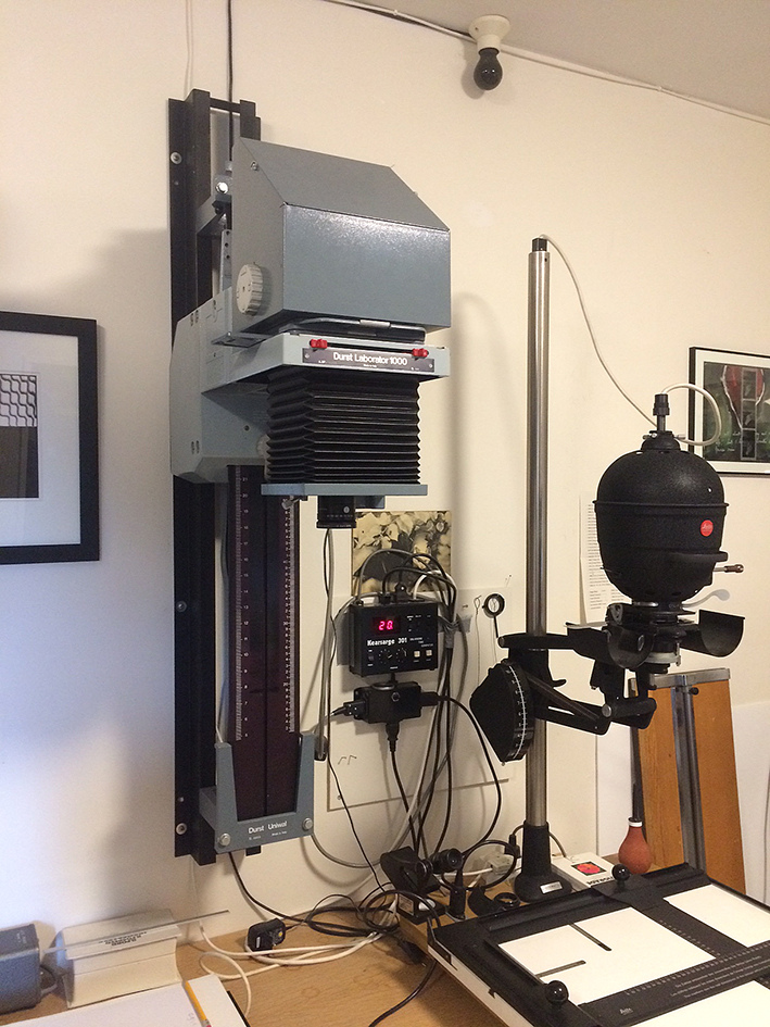

OMG! Just realised you can tilt the head on these. Ive had mine with condenser head for a couple of years now and couldn't see how the head could tilt, so thought it couldn't. Guess I should of read the instructions. Must see what other amazing things it does, might find out how the condenser lenses operate
.http://vanhuyckphoto.com/DurstL1000Manual.pdf
Hilo
Apr 19, 2011
917
Paul, the head has two positions, one being about 10cm higher.
The original post dates back almost 15 years ago, things have changed. You find the L1000 in Europe quite easily and never much higher than € 200. It is an underrated enlarger, mostly because when in it's basic configuration it is a limited enlarger. Very small for a 4x5, which is nice when you only want to do smallish prints. It often lacks the vertical positioned filter drawer, a heat glass between lamp house and mirror house. The condensers can have some damage because it is easy to make a mistake with them. The mirror can have problems because when you open up that part this mirror tends to fly out like a frisbee . . . For absolute even illumination you need these very big opal lamps, that is the most critical problem. Some have modified to led lamps. So, all in all, when you don't have time to collect these parts (took me two years), I would say don't get this enlarger. On the other hand, with some patience, you will find everything and at the right prices. Then you have a simple and fantastic 4x5 enlarger.
I got one for free about five years ago. I liked it's modest size and metal built. It took me awhile to learn what I write above, I come from Leitz Focomats and they're very different. I got two more L1000, always at very low prices. So I got all these parts and the best part I got is the wall mount. That changes this enlarger 100 percent. I also managed to get a supply of the large opal bulbs. From all the extra parts I built a second L1000 which I gave away to a group of photography students who are using it to the max.
awty
Jul 24, 2016
3,639
Australia
Oh really! Thats awesome, really struggling for height at times.
Broke the mirror when it first arrived, should have warning stickers.
The wall stand looks great, will keep an eye open for one, but any large format enlarger is very rare in these parts. I paid more in postage for mine.
Hilo
Apr 19, 2011
917
The higher position is indicated on page 7 of that manual: using the holes 15 will raise the head . . . very simple and effective.
