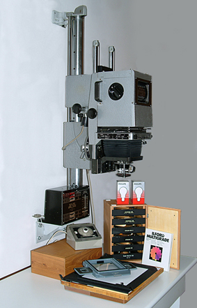

Is it like this one?
Trond

Trond, its exactly like that. Cheers.
I picked it up this evening.
Came with two condensers (if thats what the big glass domes are called) and one 135mm f5.6 Schneider - Kreuznach Componon lens.
All seems to work fine apart from missing the neg carrier.

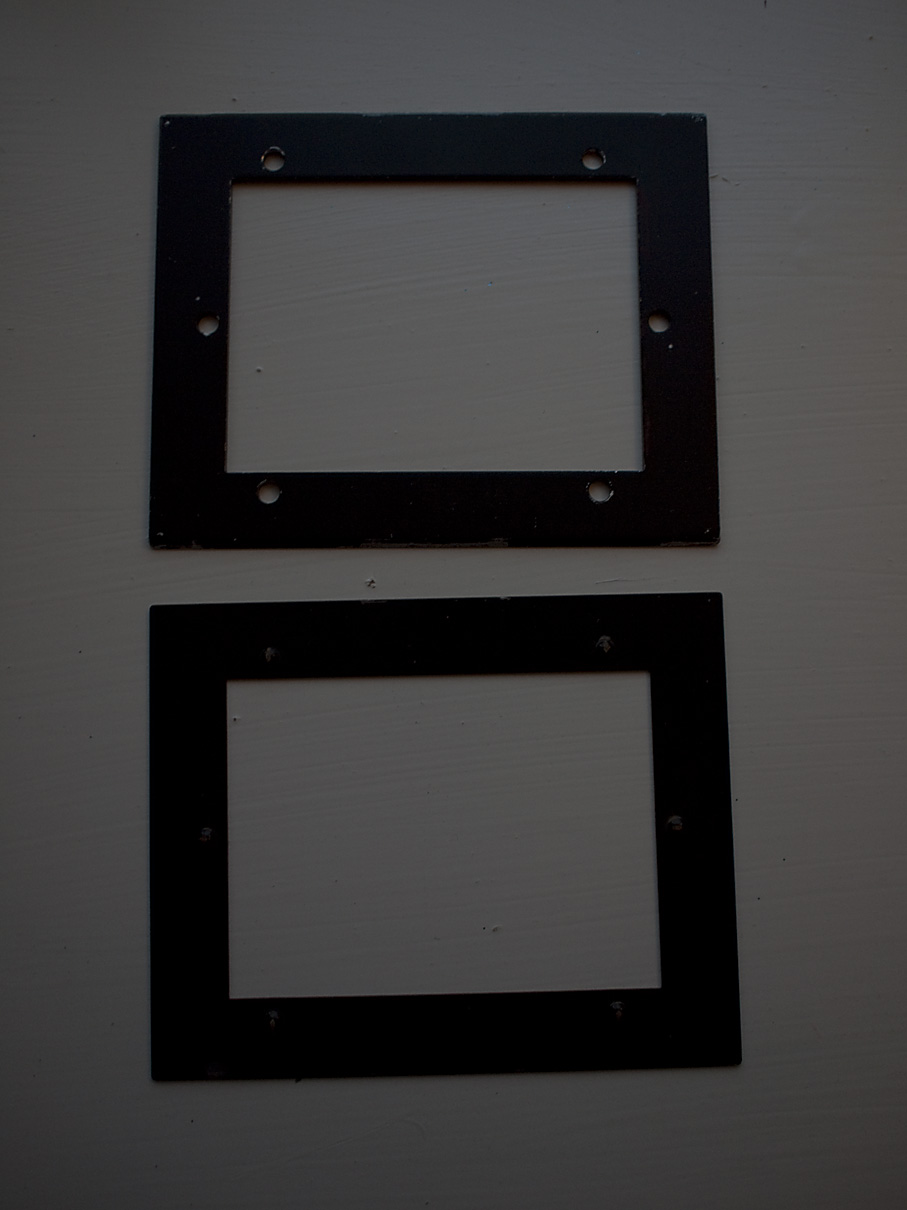

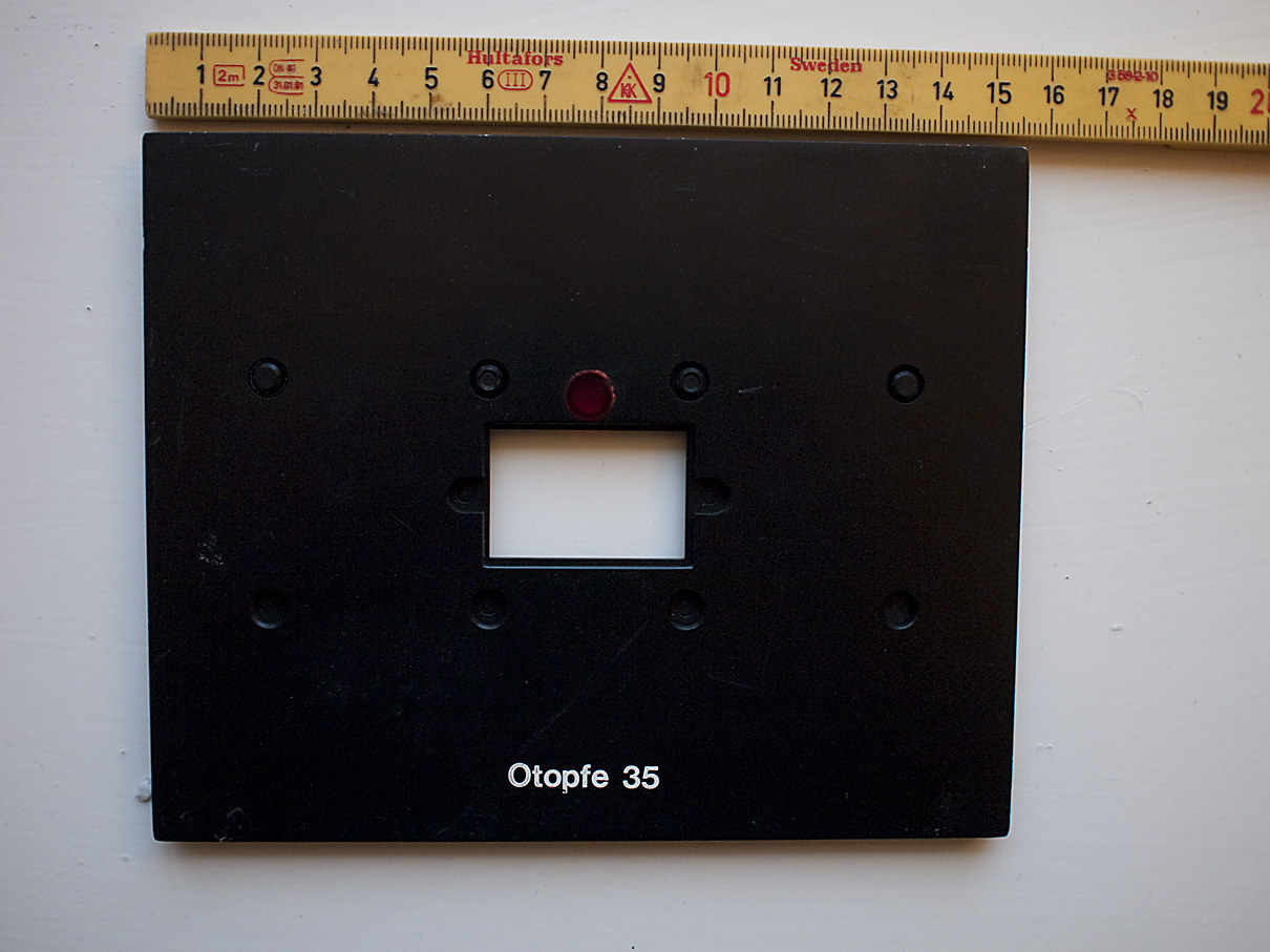

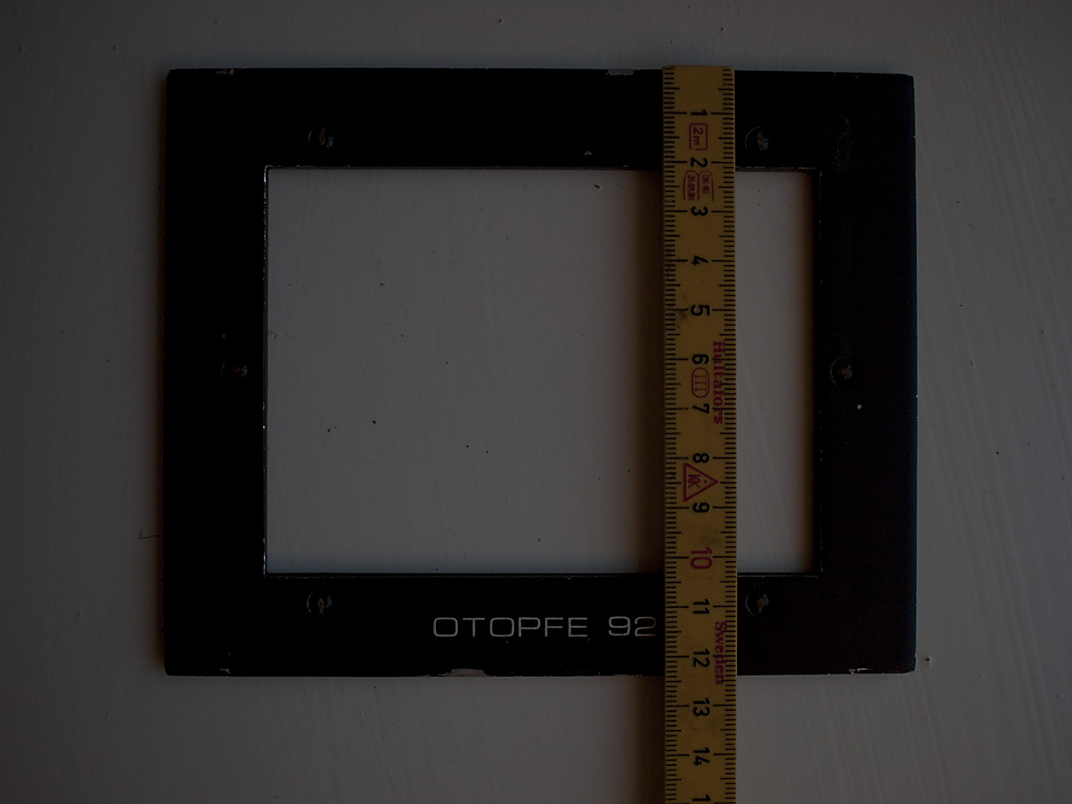

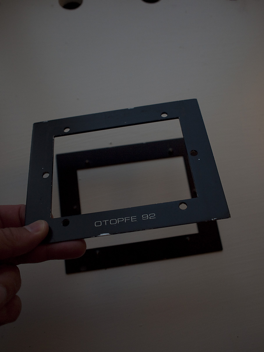

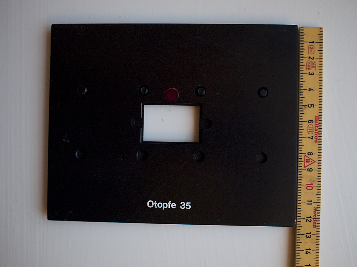

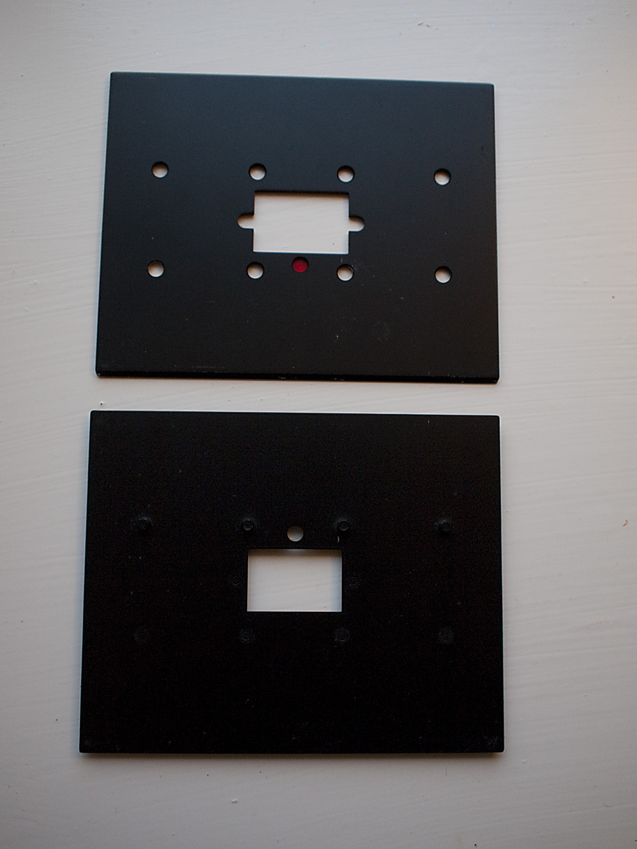

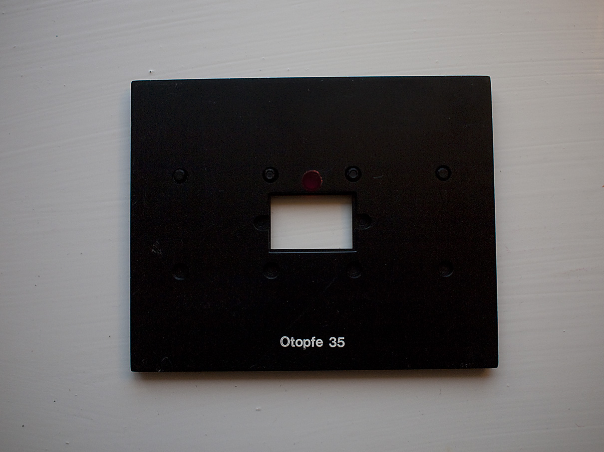

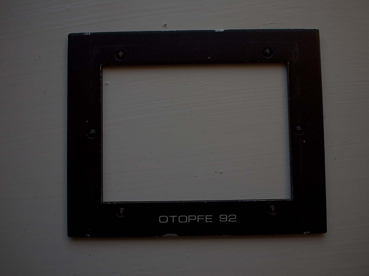

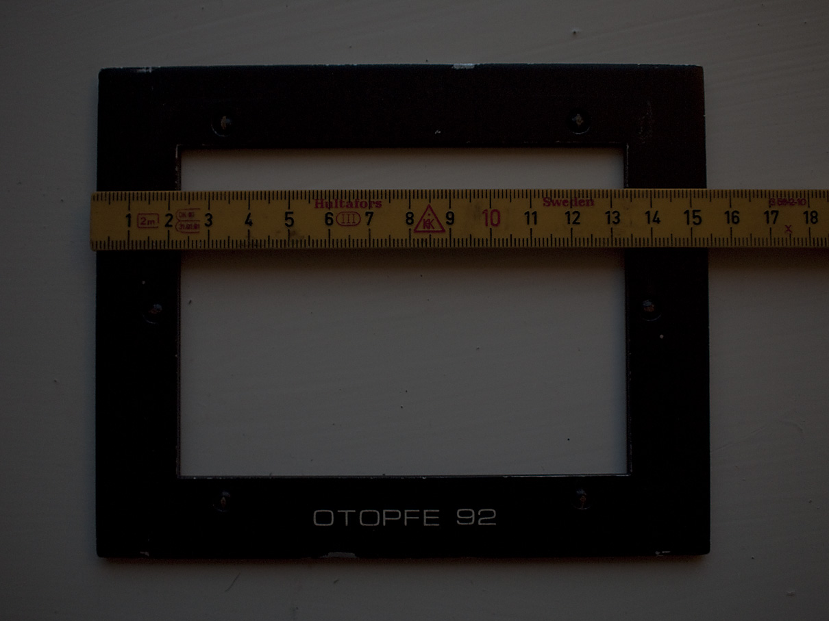

I just got the pictures of the Laborator 54 neg. carriers (35 mm and 9x12 cm).
Trond

Hi Trond,
Are those carriers or masks? They look way too thin for my enlarger unless they sit in a further holder/carrier that then sits in the enlarger head. Theres a gap of a bout 2.75cm for the carrier.
And its a solid head so doesnt flex to fit the carrier, it would just slide stright in.
I'll take some images a bit later of the enlarger.
Oh and thank your friend for me for the images.
