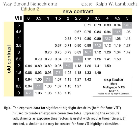

You need to make yourself a table such as the graph attached.
You'll find how to make it here:
Dead Link Removed
Scroll down to 'Paper exposure Compensation'.

Take a look at my graph in post #8. My tables adjust for the speed differences at Zone VII or VIII density. The 'auto' function in enlargers and filter sets adjust for the speed differences at the speed point density.
It's unlikely to help. On the other hand, as Marco says, I might be too picky. After all, I optimize print exposure to 1/12 f/stop and print contrast to 1/4 (sometimes 1/8) grade. To me, any larger of a difference and the print screams for help. Others may be more tolerant.
