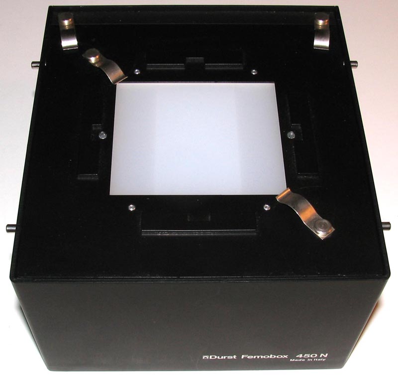

......What is the squarish area with metal guides and two clips on the top of the 4x5 Femobox? Am I missing something that goes there? .......
I wish I had a picture, but from your description, I think you’re talking about the metal spring clips that hold the Femoneg in place.
As long as you don't mind a picture taken with a camera-that-uses-no-film, then here you go:
It's about a 3.5" square section inside the raised pieces around the input window, and those inner two clips are clearly meant to hold down whatever goes there. The upper two clips are the one that hold the guts to the Femobox in place.
Duncan

.....It's about a 3.5" square section inside the raised pieces around the input window, and those inner two clips are clearly meant to hold down whatever goes there. The upper two clips are the one that hold the guts to the Femobox in place.....
I'm looking at my Femobox now, and it is slightly different, with no raised areas around the upper diffuser. To be honest, I don't know exactly what that area on your Femobox was designed for. Several years ago I did have an old Femobox for the 8x10 Durst enlarger, and I remember that it had some type of clips on top (but no raised edges), and I thought the clips were there to hold a supplemental diffuser that I didn't have. So I never thought any more about it, until now.
I think you'll find the clips are for holding a secondary diffuser or ND filter in place - At least, that was what I was told when I picked mine up last summer.

OK, makes sense as a place for optional things to go, but that means I'm not missing anything critical to normal work, right? My head actually has an adjustable ND filter built in, along with the 3 color filters, but I assume this same box might get used with heads that don't have that feature.
