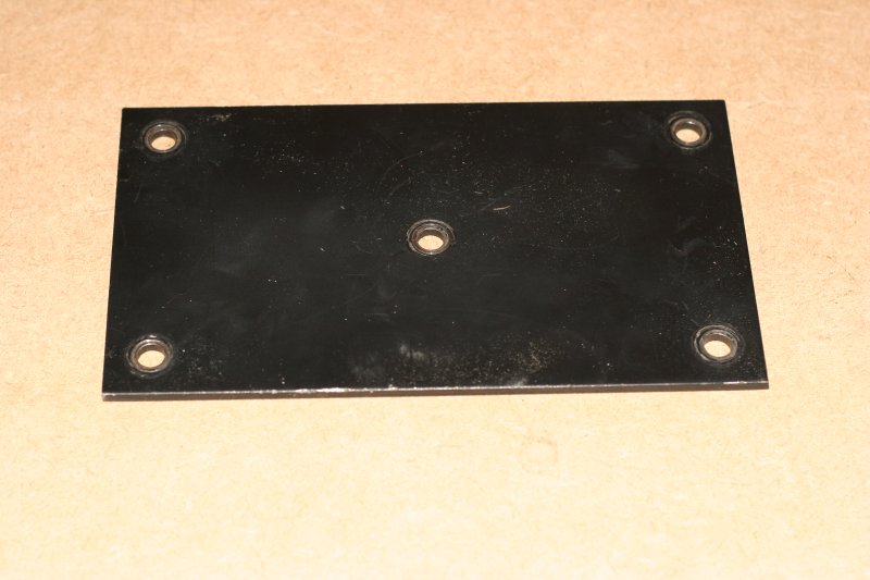

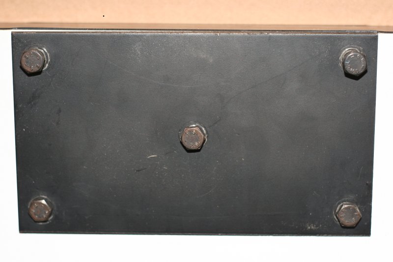

I have an L1200 Pictograph without a baseboard and I'm trying to make a replacement. Given it's size and weight, however, I want to make sure that the board I construct will be sturdy enough. Because my darkroom is temporary I am not able nor am I interested in wall mounting it at this time.
So far I'm thinking about buying two pieces of 3/4" MDF, gluing them together, and then laminating them. I have been looking through the manual for the enlarger and I've noticed in one of the pictures that there appears to be a supporting plate beneath the baseboard where the enlarger mounts. Can anyone with an L1200 confirm this? I've also thought about running some angle iron along the bottom of the board to prevent any flex over time.
