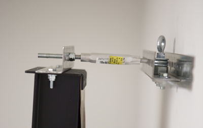

I would not trust the detents as a true reference point!! It's most likely that you have inadvertently moved the head out of alignment. I would also check the mounting bolts just to be sure the column is still tight to the baseboard.
An alignment tool is a must in my opinion. And as an aside it's worth noting that the adjustments on the enlarger can not correct out every plane. You will need to use shims. I use strips if sheet film. At the top of the column, I put a turnbuckle, to aid in adjustment.
