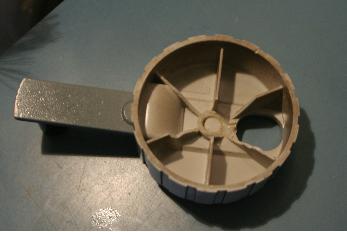

The attached are front and underside view of the height adjuster knob( the centre bit on the underside cracket and hence why it fell off)

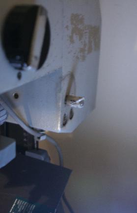

The side view shows the metal rod that the knob was fixed to (can see all thenplastic left on it)

Can you mate the knob to the shaft easily, and are there any pieces missing?
If the plastic on the shaft is not cracked, scrub the glaze off with fine sandpaper, clean it with Ronsonol lighter fluid. Clean the inside of the knob with the lighter fluid, let dry and use JB Weld epoxy to glue it back together. You will need a piece of wood to support the knob for a day until the epoxy cures.
I'm not sure if the knob was a press fit on the shaft or if it was molded in place.
Your other option is to break the plastic off the shaft, measure the diameter, it might be 6 or 8mm, definitely a metric size, and find a replacement one that is held on with set screws.
.....break the plastic off the shaft, measure the diameter, it might be 6 or 8mm, definitely a metric size, and find a replacement one that is held on with set screws.
This would be your easiest option. Ideally find the exact replacement knob. Or find any knob to fit the metal shaft.

It doesn't look like there's enough there to glue the knob back in place.

i measure the bit of the metal that is visible on the thrird image it is 8-9mm in diameter (this is without taking into account all the plastic still left on the metal) . The inside part of the knob (see middle image) the plastic shaft that the metal went into is the bit that broke over (guess age affected it) therefore there is nothing for the metal tube to go into now or hold onto. The inside depth of the knob is 2.3cm.

~6mm = 1/4" Largish knobs are available with a brass insert threaded for that size inexpensively. If the hole in the knob is a little large/small drill it out or use something like JBWeld to fasten it. You wouldn't even have to remove the shaft
You would have to use enough epoxy to fillet the collar on the shaft to the back of the knob. The problem is it's not that easy when the shaft is horizontal and the area you need to work in is "blind". If you can remove the shaft from the housing, doing it is dead easy. You could email Durst USA and see if that knob is available as part without the shaft. If it is then it is a press fit onto the shaft. The focus adjust knob on my Ce1000 is very similar and looks like it was molded onto the shaft.

The shaft will probably have to be remove to effect a repair - If it is like the Durst enlargers I've worked with in the past, the only thing to stop the shaft coming out is a small pin through a gear. A small pinpunch and toffee hammer will get the pin out, and as the shaft is withdrawn, some small shim washers will drop out. Note where the washers came from, and which way round the gear was mounted.

Get a Knob with the 1/4" diameter hole! You won't have to remove the shaft.
Mix the epoxy, put some in the hole of the knob and put it in place. Use slow curing epoxy it's stronger, let it cure overnight.
Wham, Bam done.
So simple even I can do it. Most epoxy is mixed 1:1 so a 1/4" dab of both tubes, mix it with a toothpick or the like & off you go. No man required.
Use a piece of aluminum foil or waxed paper over the shaft first that way any squeeze out won't get all over the enlarger. Just push the foil/paper onto the shaft.
