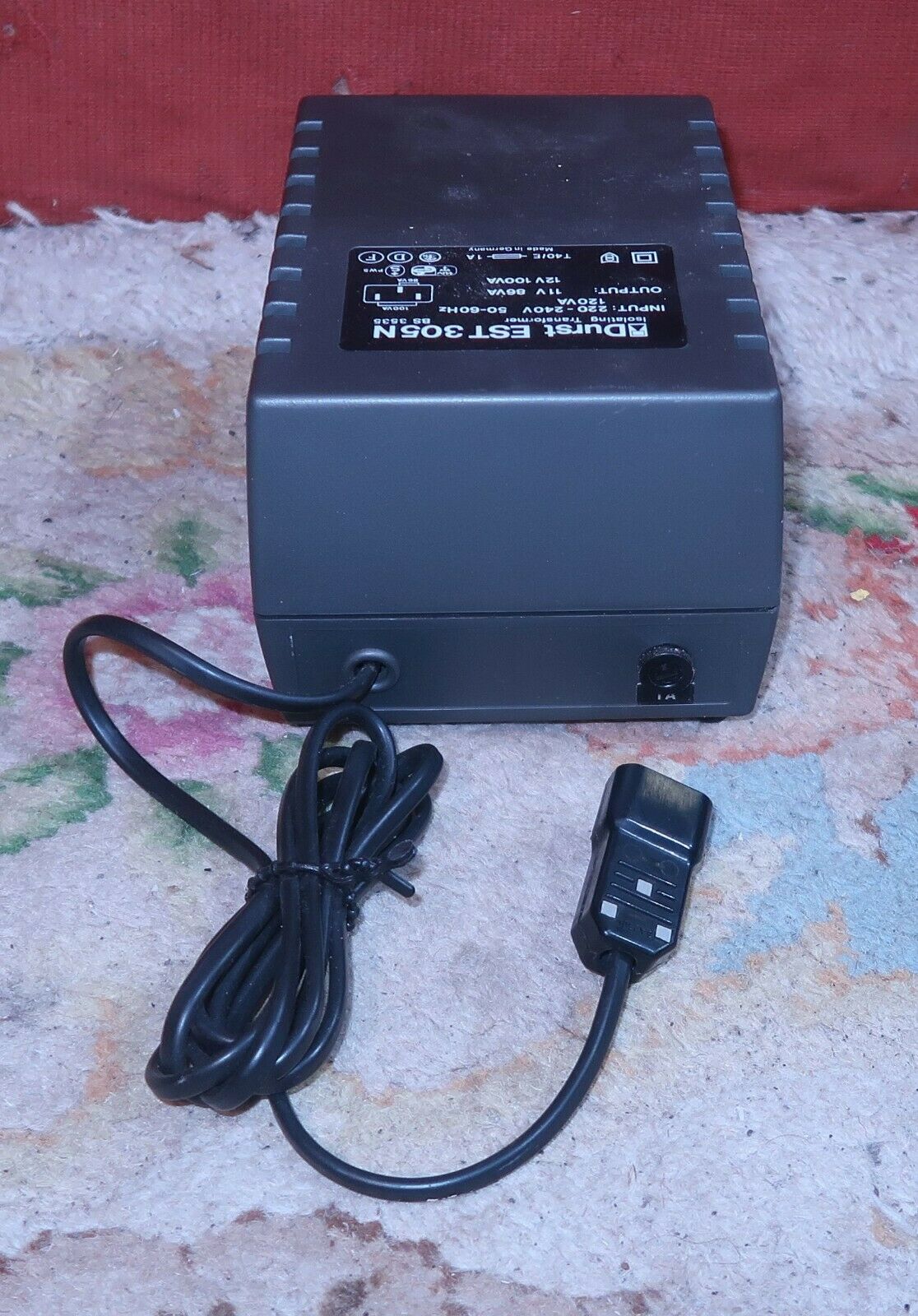

One more thing. Does anyone know what this connection is? It looks like what the enlarger plugs into but there's the same on the other side. On my TRA it has a UK plug in its place.

I can't comment on the stability of the output, but capacitors do have a lifespan and they then become a weak link in the power supply.
If you're worried about it and capable, then you can replace the capacitors (probably electrolytic) with new versions.
The connector is a shrouded IEC plug, similar to the cables used in kettles and heavy duty electrical equipment because it carries an earth as well as live and neutral.

At first sight yes, but
-) that cable is for the connection to the mains. And there is no mains wall-outlet with such connector. These connectors are only used at devices themselves.
(An exception to this rule may be propriatary cable dividers, as these connectors are smaller than the round continental european 3-plug mains connectors.)
-) that transformner is double insulated and does not need earthing, it thus has in other configurations only a 2-plug "Euro" mains plug.
The connector in question may be an outdated 2-plug version, but still then it could not be connected to wall-outlets.
I am puzzled...
An IEC cable with a 3-pin 13A plug on one end and an IEC male plug on the other will fit to the cable shown above. A very common cable and method of extending reach.
The transformer may be insulated and in a plastic case, but it will have a through-earth because it is connecting to a metal enlarger chassis. So the chassis earth will need to pass through inside the PSU case to common earth. That's why it has a 3-pin connector and not a 2-pin connector.
2-pin Euro plugs are used where the case of mains powered equipment is plastic, so cannot become live in the event of an internal wiring fault.
If the OP can post a picture of the connector from the opposite side, then we'll see it's 3-pin IEC. You can see the wiring diagram of the plug on the top label.
Mike
-) Yes, as I indicated in my post one may use such connectors also to extend cables.
But why would Durst use such connector on a device wich is intented to be connected to a wall-outlet (or same connector at a timer) ? But the screw holes are sealed, what one would not find at a tinkerer mounting that connector.
-) A metal casing etc. of device powered by a dividing transformer (as in this case) does not need an earthing. One may consider such though for earthing static electricity.
We're assuming Durst fitted the connector......it is possible that someone else fitted the IEC connector......i've done it myself on occasion.
Mike
Hi thanks for the information everyone. It looks like an IEC connection but I've asked the eBay seller for more photos of it to be sure. I've seen other Durst transformers with them on so it's a possibility that they were made by Durst like this but I'm not sure why if that was the case.
