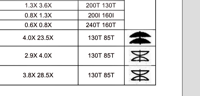

I agree, I saw a position sheet in the Durst USA site that shows two condensers both convex side up.
