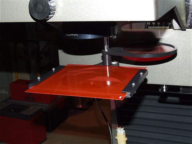

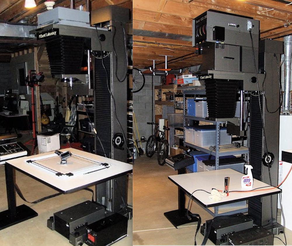

I think there was a time when a popular modification of these enlargers was to fit a Cold Light head. I'm glad I converted mine back to the dichroic head.
This is the under-lens filter holder I made. I used that for a year or so while I got all the parts to get the dichroic head working.
