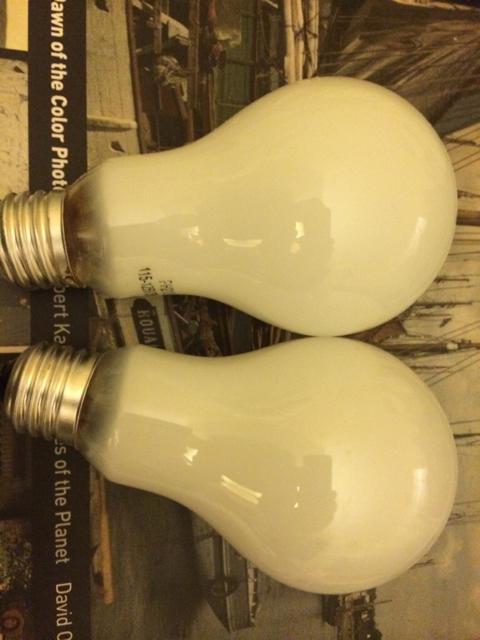

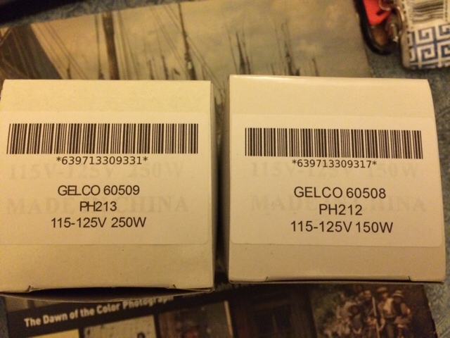

Sorry my memory is slipping a bit. The bulbs are actually 150w and 250w. It's the 250watt bulb that has the very short life span.
The 250w is a ph213 and the 150w is a ph212.
ImageUploadedByTapatalk1417172784.123325.jpgImageUploadedByTapatalk1417172902.662667.jpg
I got them from 1000bulbs.com online for about $1 each looking at my old emails. The same site also sells the Thomas Duplex sox35 bulb for about $36 or so, great deal vs buying the $100 version from the manufacturer.
You can use smaller bulbs if printing at smaller sizes so exposure times are not crazy short which also lets you not close down the lens aperture all the way and add diffraction to the mix.
The bigger wattage bulbs help a lot with big prints but gets hot quickly.
