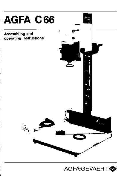

I have an Agfa C66 with I believe is the same machine made for Agfa by Durst - it also had a built in probe/meter function. I took off the cover - removed the boards for the meter/probe circuits - used the remaining transformer to run power directly to the head. I have it plugged into a normal enlarger timer and has worked fine for me for a number of years. I would not recommend that you do this unless you are comfortable around circuits and rewiring - getting an electrical engineer or electrician to help would be something I would strongly recommend.

You really just need a power supply that matches the bulb in the head. The Agfa C66 looks like this attachment.
