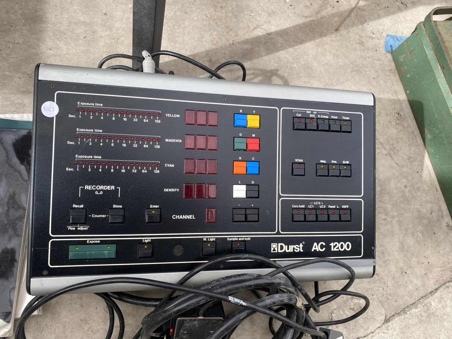

So I saw this at auction, thought it was fascinating and bought it. :blink:
Can someone explain to me what exactly it does, what equipment it would need to hook up to for it to serve its purpose and more importantly is it still a viable instrument (let's assume it works)?
No need to question my sanity, my wife already addressed that question :smile:
It look like this:

I believe it combines a controller for the enlarger with the functionality of the stand-alone PCM 1001.
You would use the controller with your AC 1200 4x5 enlarger, for color printing. The VCNA function is nice if you have a video monitor to use for pre-imaging the filter pack.
You could let us know if you need the rest of the enlarger, to use it as a stand-alone analyzer.

I also have the AC1200 controller and AC1201 colour head. You should have the ET2000 PSU too.
Sadly, mine doesn't work anymore. It did when i received it but after a while it just stopped and despite sending to a well-known enlarger repair guy, he was unable to revive it.
It's a shame because the AC1201 head has a shutter in it to improve exposure accuracy.
Hopefully yours has been in use recently.

Unlike the VCNA that I am used to (Omega D5500), which automatically sets the filtration in the head with motors, the head of the AC1200 enlarger is fully manual. So the filtration values have to be set manually by reading the controller box. I don't see why those values could not be transferred to the color head of any enlarger.

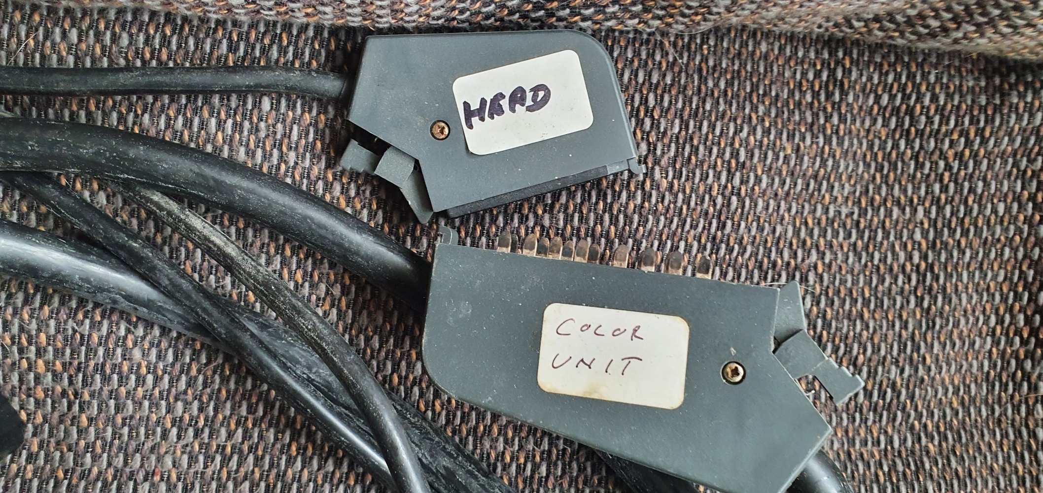

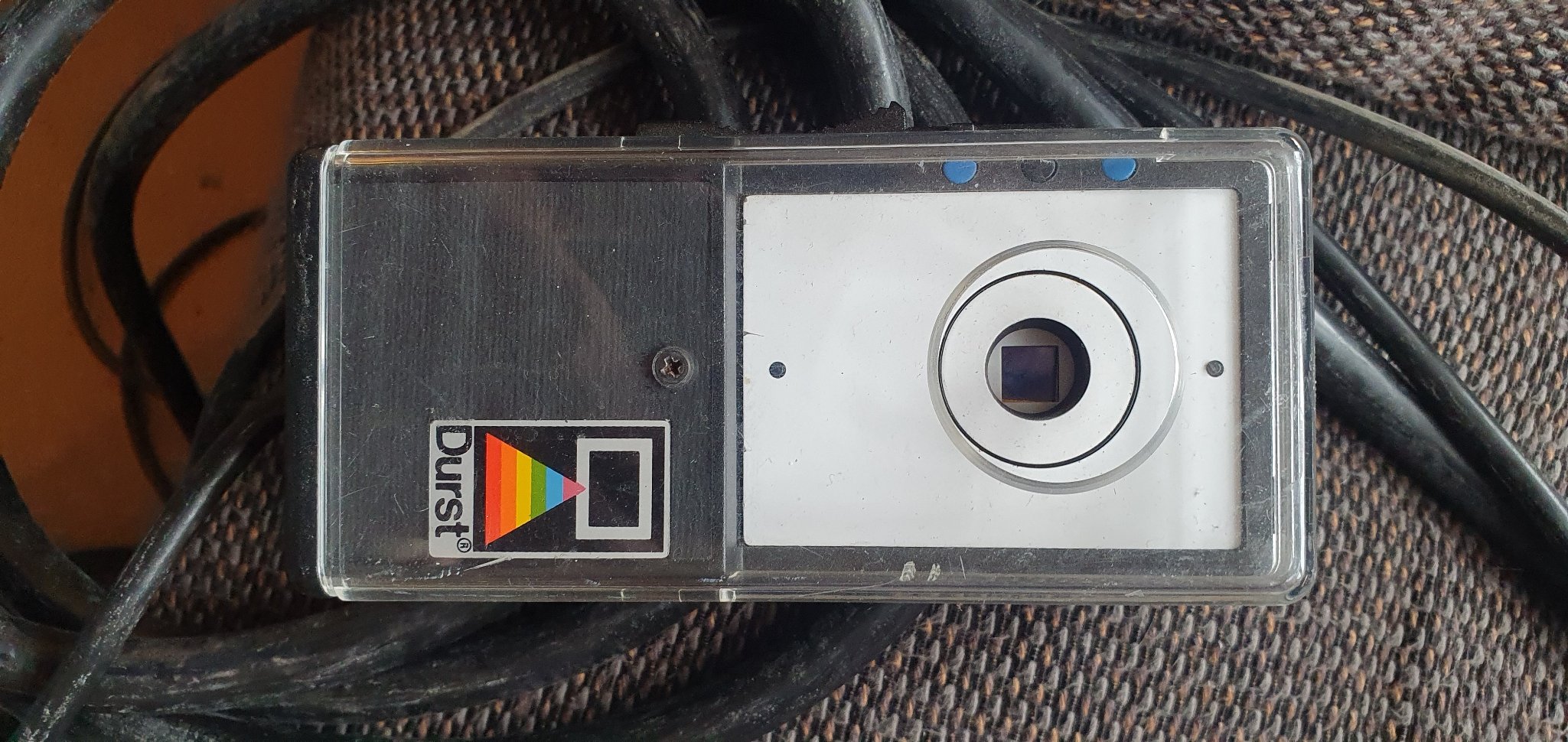

So here's what came with it.

But is anyone not surprised to find out that there isn't a place for a power supply, absolutely nowhere that one would be plugged in to the unit or exit the unit.
More research is necessary!
Ideas are welcomed :D

From memory (mines packed away since it's not working) there's a cable from the controller to the PSU....like a large scart multi-plug.
Then there's a cable from the head to the PSU too, so the controller activates the PSU for the lamp and shutter in the head.
Looks like yours could come from the automated processor rather than the AC1201 like mine?
Mike
