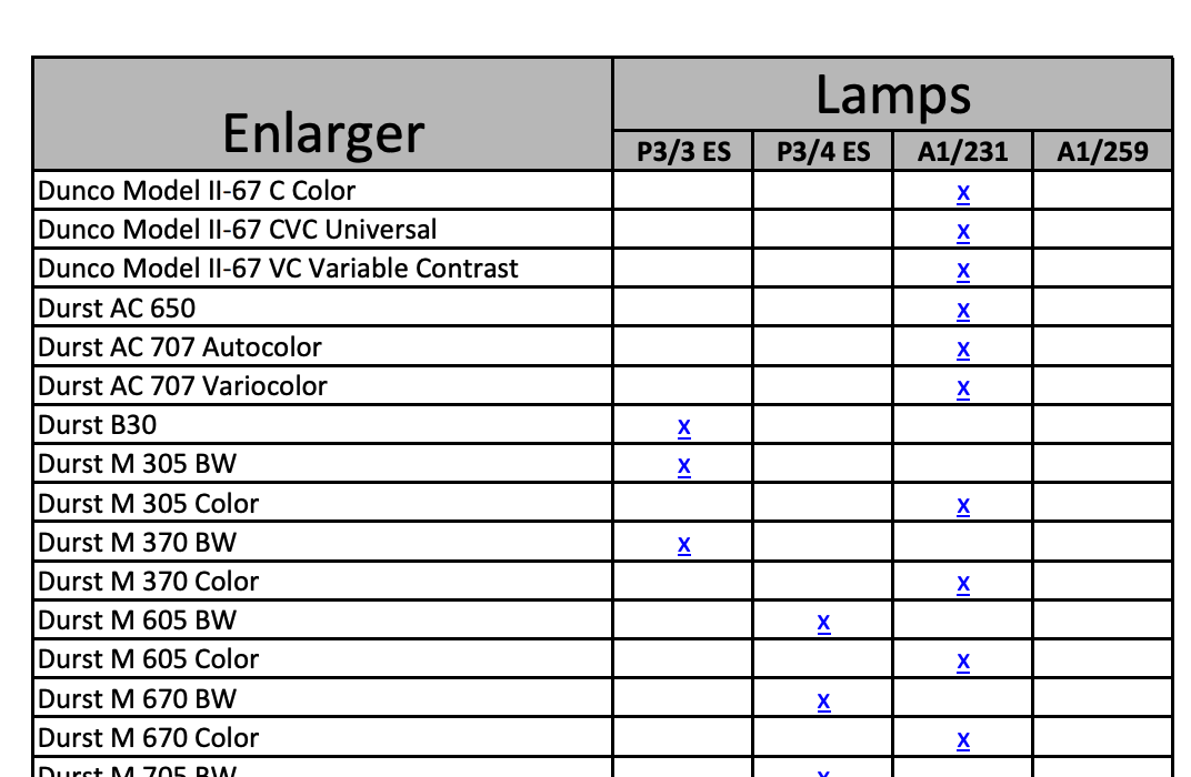

This is what I used.

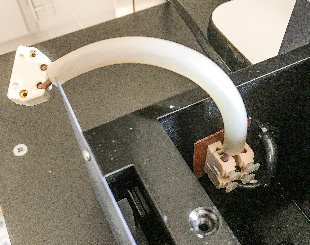

I have had my Durst enlarger since the 1980s. Had to replace the bulb two pin socket twice. The last time the light was flickering due to the corroded connector.
I gave up on replacing the socket, and have replaced it with two small lengths of tinned brass tube soldered to the wires and pins of the light bulb.
Only problem is if the bulb goes I will have to dig out the soldering iron to replace it. Not a great problem though.
BobUK
Oct 13, 2021
586
England, UK
Just had a look at ebay UK. DFB Sound and Light have socket G6.35 item code 355834337078 priced at £2.99 free postage.
At those prices you could buy a couple of spares for the future.
Disconnect the power supply.
Cut the old socket off, and solder the new one in place, plus some heat shrink insulating tube over the joints.
Before buying check for yourself that that is the correct socket for your lamp.
If you are anything like me you will put the spares away in a safe place, and promptly forget where.

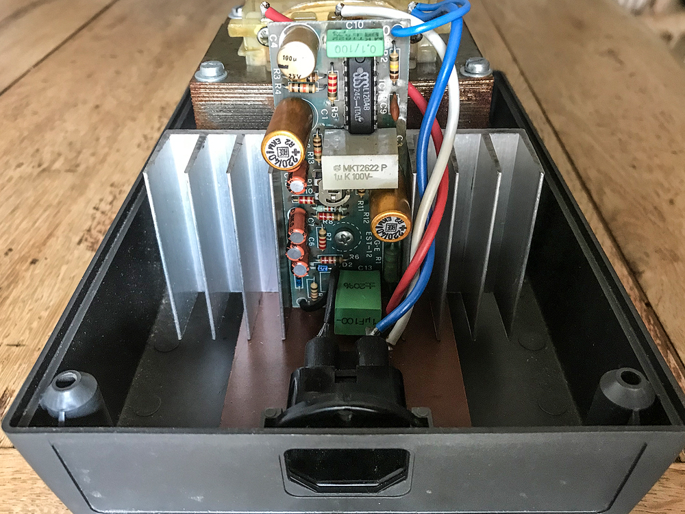

Reply to Koraks:
"The unregulated TRA305N doesn't have a 'voltage output circuit'; there's nothing to repair."
See attached pic. this is a circuit ??

koraks
Nov 29, 2018
26,679
Europe
Yes I had a look at that – however it states 75 Watt Max.
Does it?
I don't see it. Anyway, that socket should work fine.
Yes, you're correct. So that's a stabilized supply. Sorry for not having checked your earlier assumption that it was a non-stabilized unit; I assumed you had verified it.

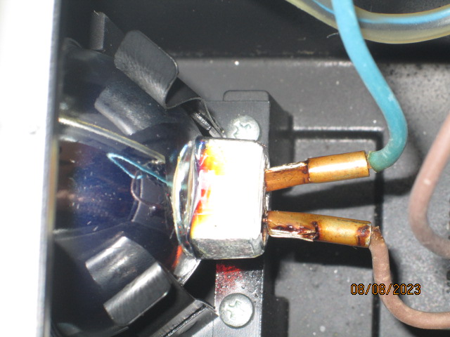

Whilst I had the opportunity I replaced the wires from the small screw terminal block to the socket with slightly longer wires.
The brass tubes were cut halfway across then along one half of the length. A fine jewellers saw was used for the cut.
The slotted end of the tubes were flattened slightly to be a good fit around the lamp pins.
I tinned the lamp connecting pins with solder before making the connections.
Then soldered everything up.
Use some insulating heat shrink tube over the solder joints for safety.
Small brass tubing can be purchased in about 10 inch lengths from model making shops. The sort of place that sell bits and pieces for radio controlled planes, helicopters, cars etc.

Steve906
Mar 2, 2015
100
Leicester England
Its not really a good idea to solder to these bulbs. The lamp holders are supplied with crimped in leads with high temperature insulation.
The lamp can easily get hot enough to melt solder and damage normal insulation !
The following is for my Modular 70 -
The voltage to the lamp is AC (chopped not PWM if the stabiliser is used) and should be measured on an AC meter with floating ground.
I use the Osram xenophot 64627 HLX EFP 12v 100w gz6.35 they say made in Germany on the lamp and box. They also have a warning that the lamp can reach >500 deg C
The holders are listed on amazon UK - search "g6.35 socket" also MR16
It may not be relevant but my transformer outputs 17V AC and 12V AC - the 17v is regulated by the stabiliser to 11.7v chopped AC
The 12V is only used by micro head and/or other accessories unless the stabilser is removed (it was an option on the M70).

BobUK
Oct 13, 2021
586
England, UK
Steve.
I have shortened the quote.
Hello Steve.
Perhaps I have been lucky so far regards melting solder.
I would have thought the temperature of the lamp would be measured in front of the reflected element. Not around the back by the connectors. The front of the lamp would be hotter I think.
I ditched the correct connector due to arcing inside the tubes that the bulb pins go into.
Up to now things have gone well.
Possibly 500c could be reached if the bulbs are used in a slide projector for a long time continuous.
It would be nice to hear other peoples thoughts on this.
