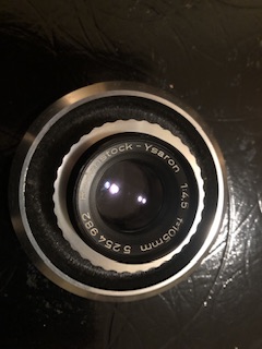

i have just purchased a Durst 609 to print my RB67 shots and I have the following queries which I would really appreciate some assistance with please.
1. my lens is a Rodenstock-Ysaron 105mm f4.5, is this lens suitable for 6x7, my understanding is that it should be.
2. using equipment mentioned above, should I be able to produce a 10x8 print, my initial use says no, I can not raise high enough in focus to cover 10x8,
I can only seem to print to about 5x7 maximum keeping it in focus.

A 105 Ysarex should easily cover 6x7cm.
The 8x10 enlargement problem is usually the cause of the lack of a recessed lens board, but I'm surprised you'd run into this with a lens this long. What kind of lens board do you use? Can you post a photo of the enlarger with lens mounted, clearly showing how it's mounted?

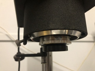

Right, looks like you've got an extension tube fitted on there, which limits focus to very short distances (small enlargements). Can you remove it? It's the black cylindrical attachment. I think you should be able to remove it and mount the lens board proper straight onto the enlarger.
Or maybe the lens cone is part of the original design, but in that case I'm pretty sure (going by photos of this enlarger on the web) that there are shorter cones available that should allow you to focus larger prints with this enlarger.

looking at images of this lens on the net it would seem that this is standard for all examples of this lens.
The lens is just the bit that screws into the lens plate. You have at least 3 components there
1: The lens proper
2: The lens board with the shiny aluminum outer ring
3: The extension tube that mounts the lens board (and lens) onto the enlarger.
In your first photo, you show the lens board + lens mounted:
So this is items 1 + 2. You could unscrew the lens from the board, but there's presently no real need to. It will however demonstrate that they are two different items.
I think your problem is with item #3, which is physically distinct from the rest of the assembly. If this tube is too long, the distance between the film and the lens will always be too long (regardless of focus adjustment) and you will be limited to very small enlargements. Id extreme cases, even at 1:1 enlargement proper focus is not possible, and only reductions can be made (print is smaller than negative).
Just to make sure - you do know how to operate the focus adjustment on your enlarger, do you? I assume when setting up for a larger print size, you have:
1: Raised the head
2: Adjusted the focus to get a sharp image
Steps 1 & 2 need to be done iteratively to obtain the exact desired enlargement at precisely accurate focus (with the exception of 'autofocus' enlargers, but this isn't one).
If somehow you missed step 2 (set focus), we might have kept this very brief :wink:

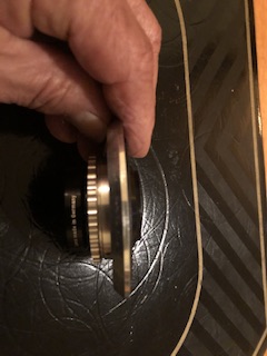

For reference I have posted the shot above showing the tube fully extended, if possible could a Durst 609 owner check and compare their own to it, cd cover for scale
Many thanks

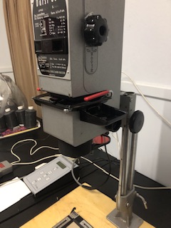

The Durst 609 from memory has a double extension column. One of the pictures from the OP shows this assembly in the LOW position. The column locking lever should be loosened and the "front" column lifted to the top and locked there. That gets the enlarger head to maximum height and hopefully maximum enlargement.

Maris.....That is the winner and indeed the fix, I had come to exactly the same realisation basically the same time you were posting, and of course seeing your post confirmed it, so simple and it has totally fixed my issues.
My sincere thanks to all who posted above, it was all really appreciated.

No, the cone stayed, just raising it did the trick which makes complete sense, I had thought of it earlier but something stopped me trying to utilise the second column, I am old enough to have known better but I think I was having one of those days.
