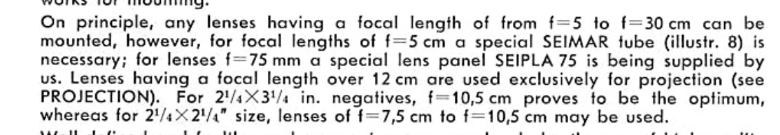

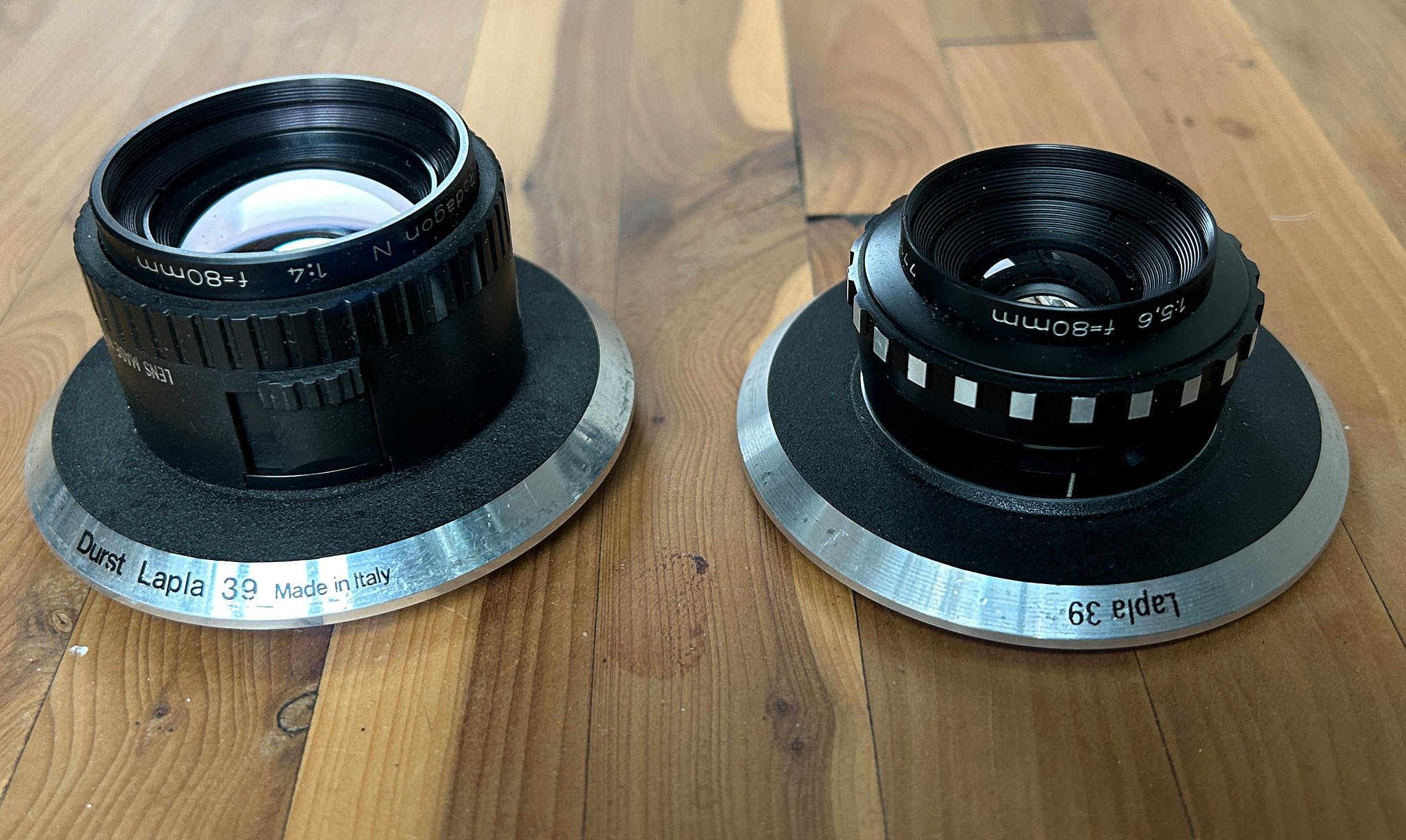

SIXTUB will not fit on the 609. The reversible boards used on the 606 are also not really compatible.
Here is what the 609 manual recommends:
Personally, I would stick with a 6-element 80mm lens. Note that the LAPLA will work for smaller enlargements, but to get the full range you may need the deeper recess of the SEIPLA.
