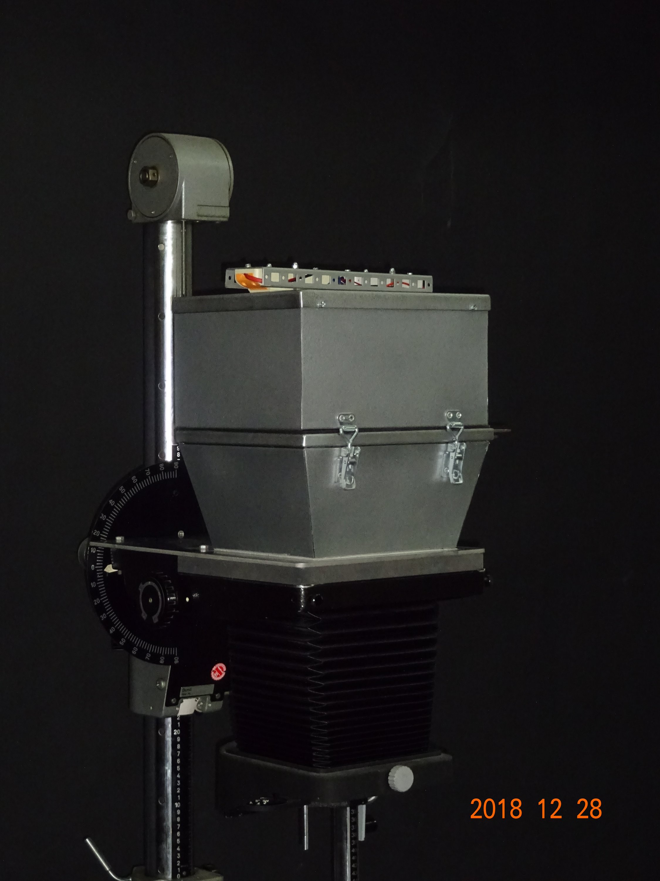

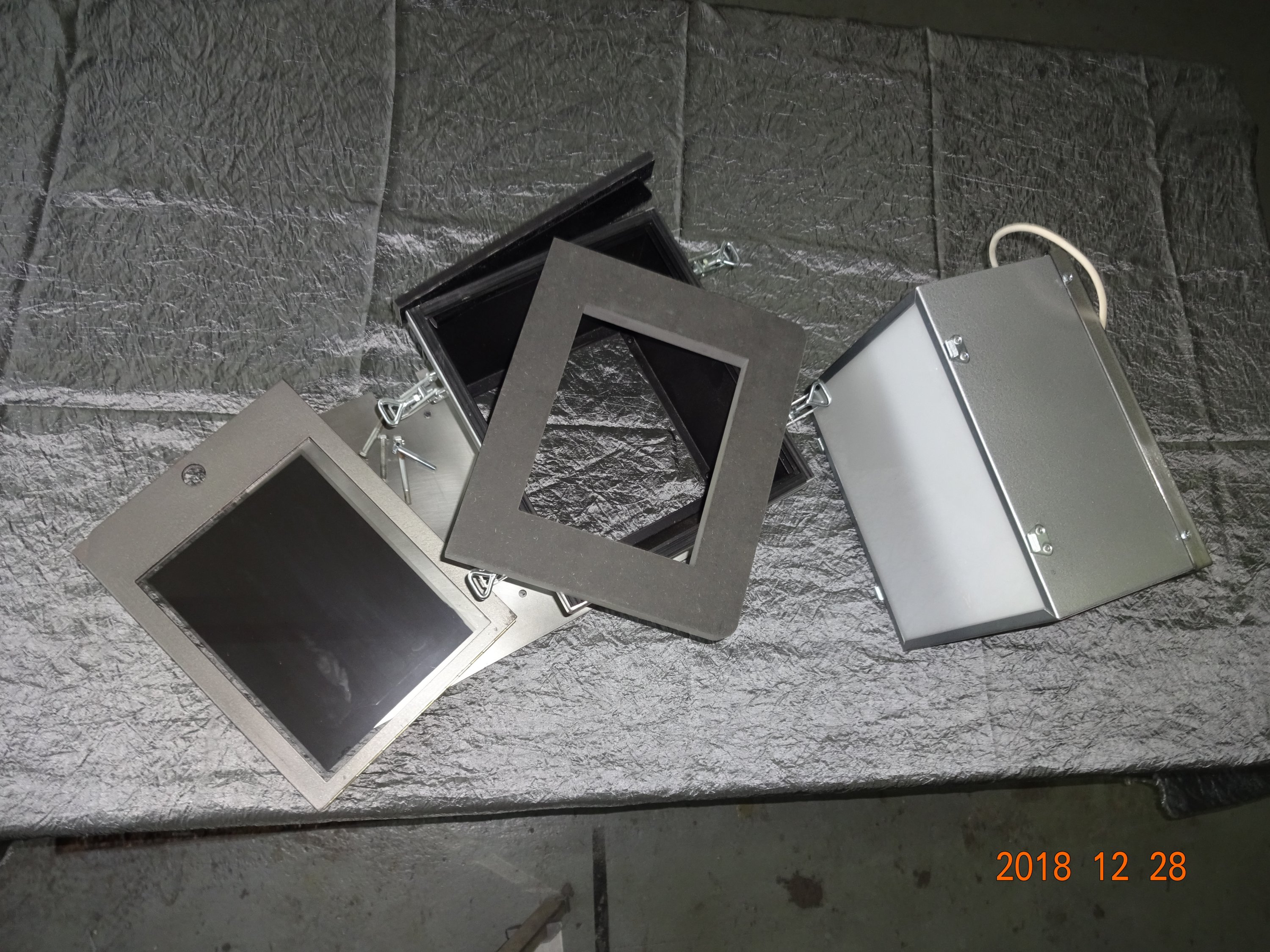

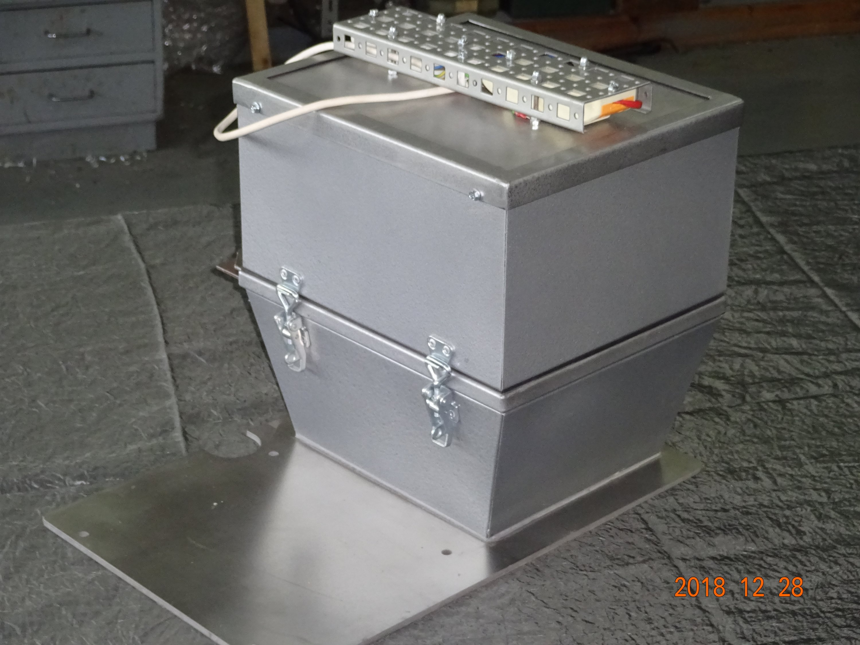

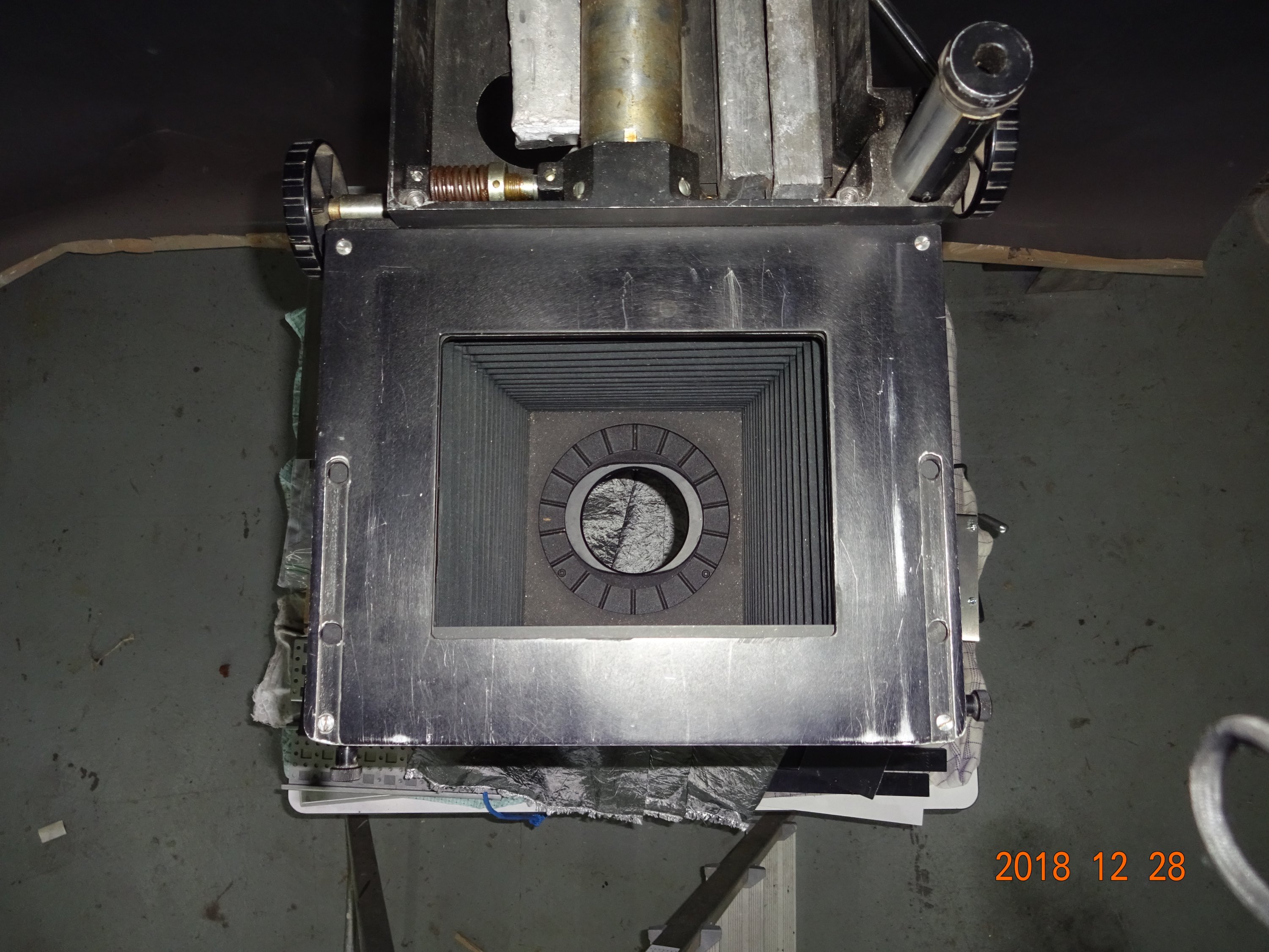

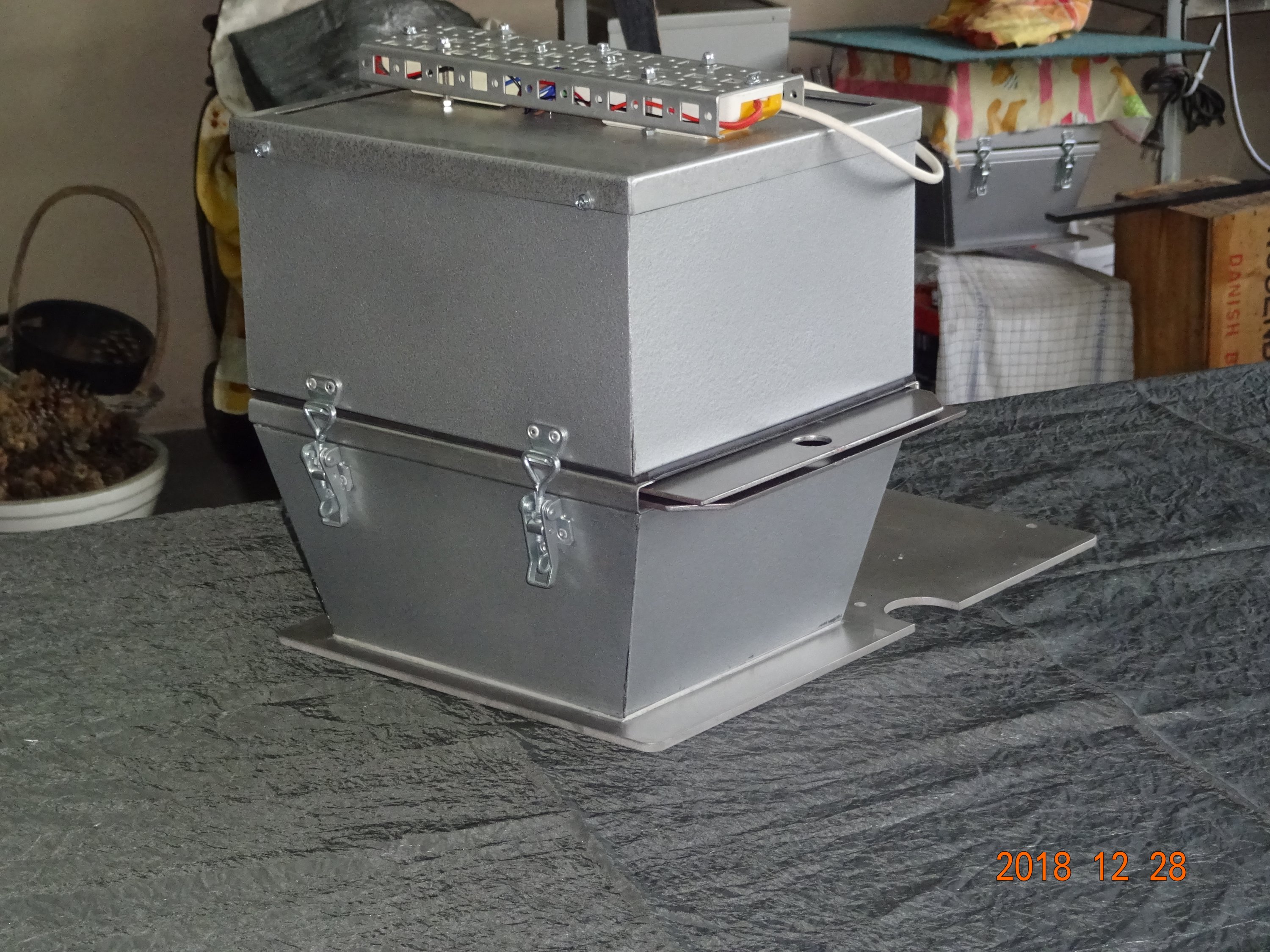

18x24 ( 8x10") conversion durst 138S / G139
all parts needed for the set up are included !
1 x light head with 53 pcs 3 w leds with 2 x led 240V drivers atatched
1 x pyramidal stub (?) on stainless mounting plate
1 x negative holder for up to 8x10 neg.,double glass book type
1 x adapter plate to replace original 5x7 neg. holder
1 x light seal to replace 8x10 filmholder
(when you use original 5x7 holder for smaller formats)
4 x bolts for assembling
spare bulbs,
conversion is made for 240mm lens,
that makes vertical enlargemants over 1 x 1 meter on the board
emitting light same as the very bright Durst BWL 300 head.
but no need for a noisy cooling fan.
all parts of lazer cut steel and stainless material,
finished in grey hammerite paint
you need a screwdriver and a 10mm spanner , a hack saw for small adjustment
and 1 hour for first time assembly
thereafter it only takes few minutes ( 4 x 10mm bolts !) to change back to original enlargerhead if desired.
if you have any questions, please ask me.
asking price 400 euro incl shipping to most parts of Europe.
DSC00078.JPG DSC00079.JPG DSC00081.JPG DSC00082.JPG DSC00067.JPG DSC00067.JPG
klaus lundsgaard
nibe
denmark
