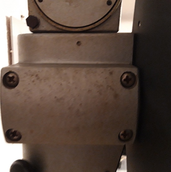

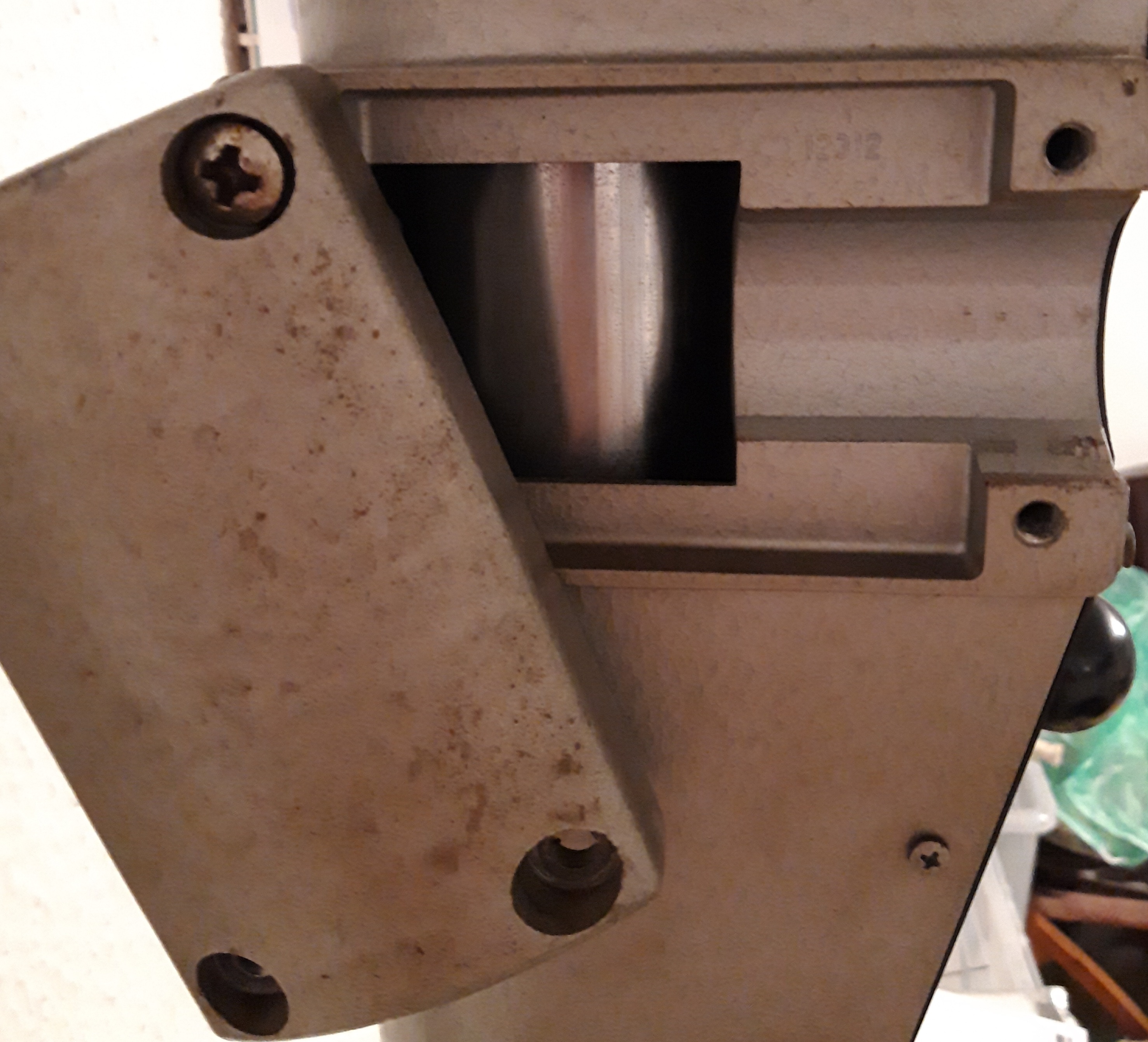

I try to dismantle my Durst 138. It is the first time and I could not find on internet instructions about how to do this.
I allready removed the big, gray case of the head (where the condensers and the bulb goes). But now I want to detache the rest of the head from the upper coloumn. I am not sure wich screws shoul I un-screw: some of the first picture (inside the base of the head...) or the 4 screws of the second picture (I am affraid I release the wrong screws and then ....it's bad ..!)
Please, excuse my english.
Your help will be higly appreciated.
Thanks !
Valentin
P.S. I would like to remove the bellows as well and the entire mechanics that slide the bellows up and down..

I have no intention to deal with that spring at all. I just thout there would be a way to take the mount off without touching the spring and its mechanics.
I just took a look on ebay where some sellers offer for sale only the upper coloumn without the headmount. I looked closer and I think they released the 4 screws from my second picture.
But I'm still wandering if this could be the solution....
Thank you for posting!
Valentin

A couch, actually... and I need to dismantle the enlarger to put the parts in plastic boxes (of cours, not the colomns and base). Please, take a look at my second picture: do you think that if I unscrew the 4 screws, with the head at the highest position, the spring will react? Thank you for your post!

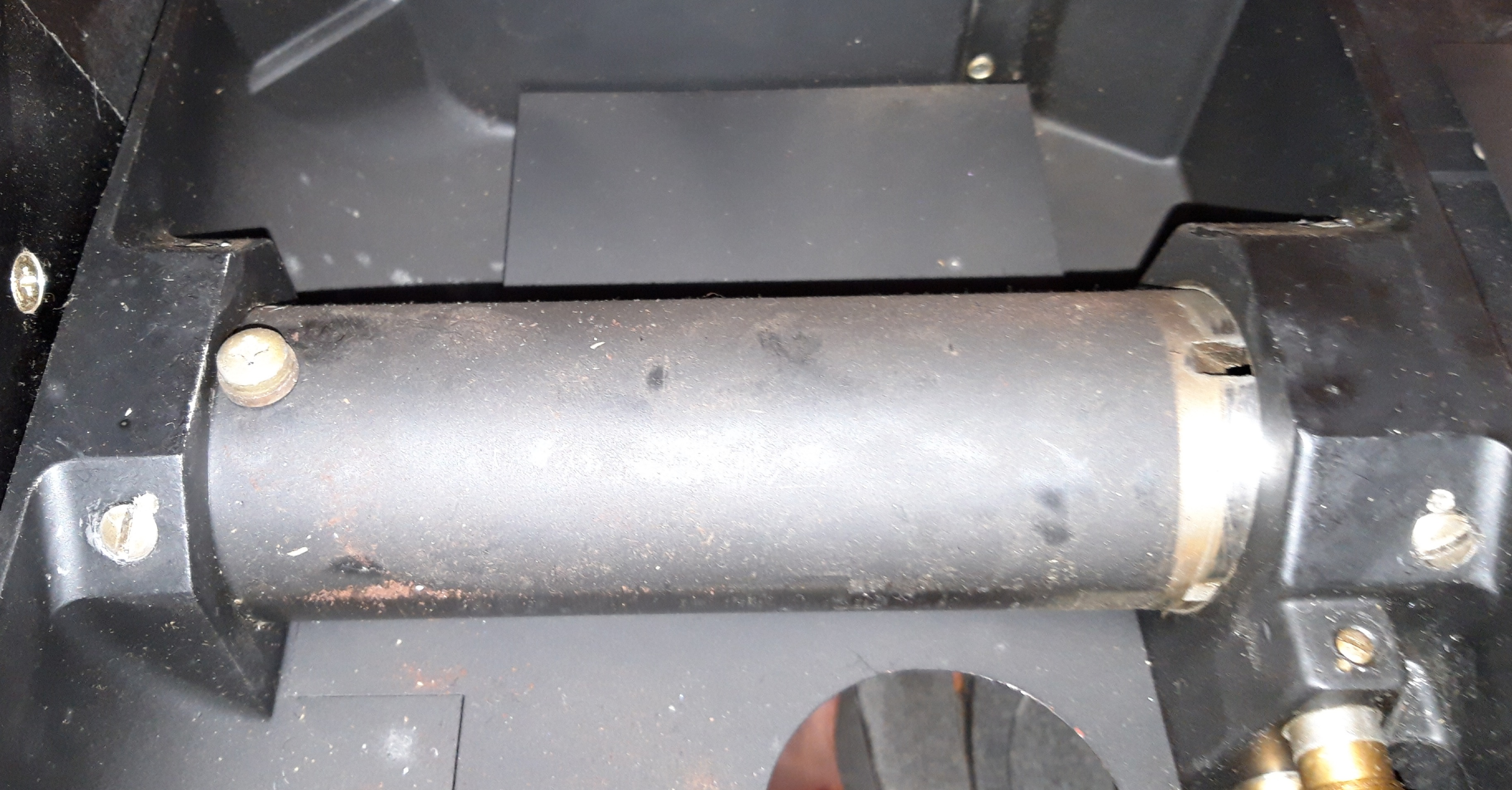

Hello, again! I dismanteled the head. The 4 screws I was asking about in my first post have nothing to do with the spring: thei are there just to hold the heads plate.
It's enough to loosen them a little bit and the head plate comes out nice and easy.
Thanks everyone for your answers!
Just take care: I saw that some models have 2 screws instead of 4, like mine has.
