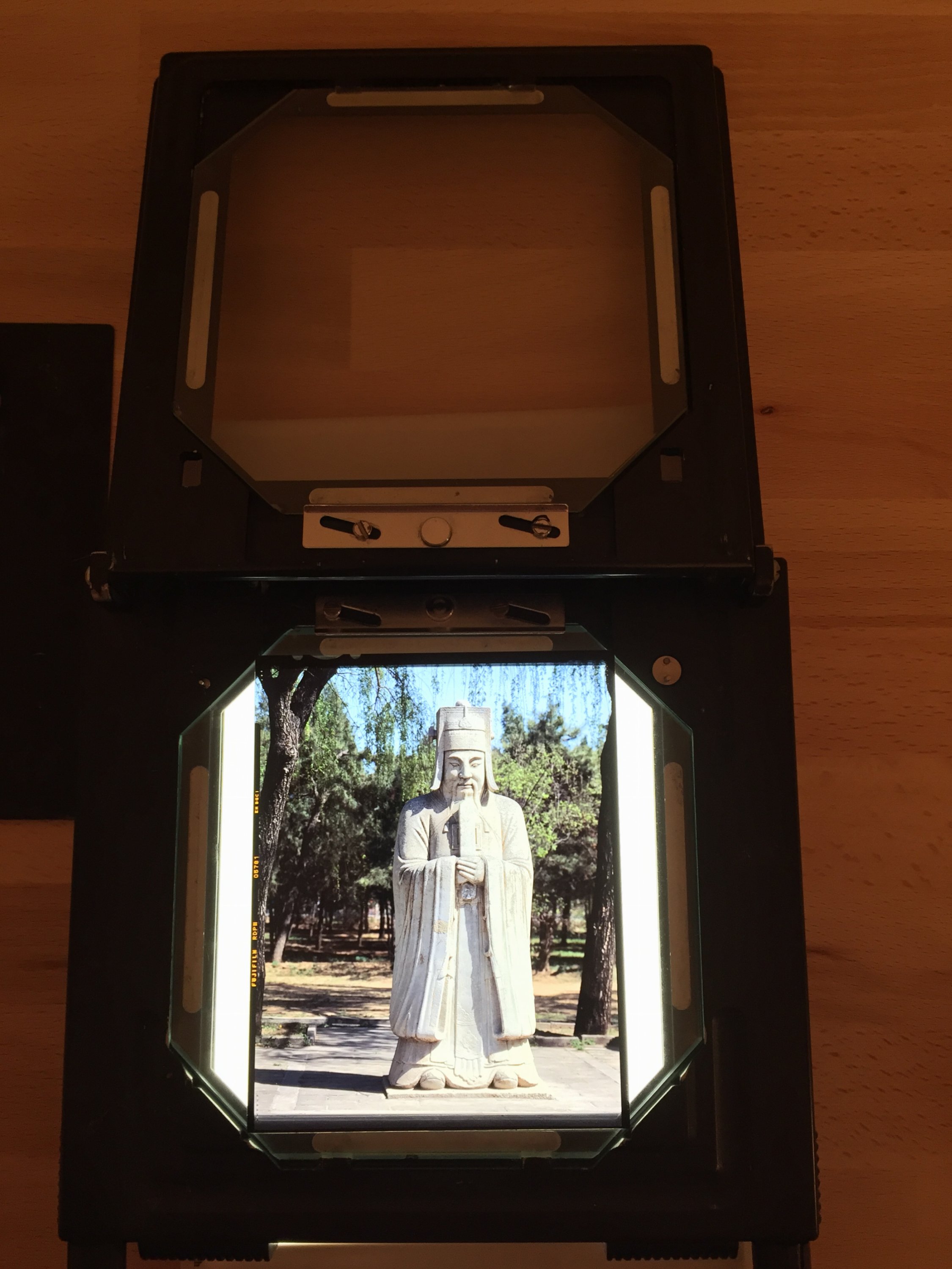

Here is the Femoneg glass holder I have, with a 4x5 slide. As you can see, the slide doesn't fit corner to corner.
https://www.dropbox.com/s/dcu8kcgqmsclhy4/IMG_4491.JPG?dl=0

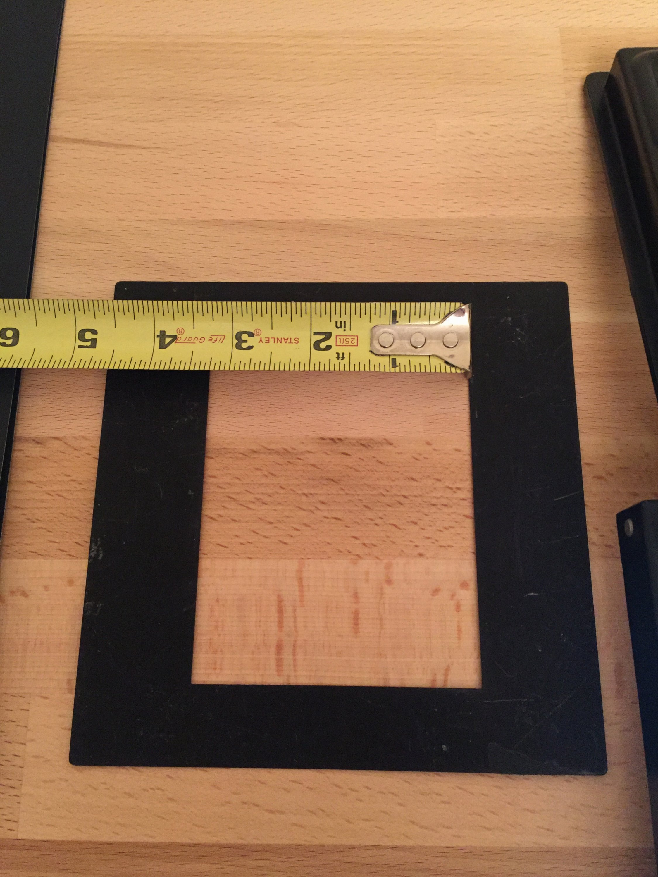

Here is the largest mask I have for the slot:
https://www.dropbox.com/s/ast5p2kaej8o4bk/IMG_4493.JPG?dl=0
It isn't large enough for 4x5.
So how is the slot used? The femoneg has edge masks that can be dialed to mask different slides or image areas, so I'm not sure what the slot mask adds.

Ok, now I got it to work. Here is the Femoneg:
I have two L1200 enlargers in my darkroom, one has this mask, the other doesn't. To be honest, I don't see what function it performs and wonder if it is really necessary. I don't notice any difference with or without.
I would try without the lower mask as it doesn't look big enough at only 3 1/2 inches wide.
if you want detailed info about femoneg and/or lower mask purpose / sizes available I would phone Northern photo in UK and ask to speak to terry. He knows all there is to know about Durst enlargers.
http://www.northernphoto.co.uk/
If you were just using glass in femoneg and no format mask, especially with smaller negs, then that lower mask would stop a lot of extraneous light (read flare/fogging).
But yes, if you are using correct neg masks in femoneg then I don't suppose its necessary.
Regarding the Femoneg itself, not the mask: Is this a Femoneg for 4x5? If so I'm surprised, since it doesn't seem to give a 4x5 negative full coverage. It at least clips the corners, and perhaps a bit of one of the long edges.
Edit: The part number on the Femoneg is BA 30.200.
-chuck
I thought all femonegs were 4x5. I have just assumed this.
There are tiny little corner cutouts in the femoneg which a 4x5 neg just fits into. If the corners just fit into the corner cutouts then its a 4x5 femoneg.
Phone Terry at Northernphoto and you will find out everything you need/want to know.
If you are wanting to print the whole neg right upto the corners then you may be disappointed. But again, phone northernphoto.
-chuck
Yes, the standard Femoneg and Femomask 45 clip the corners of a full 4x5 negative! How annoying. There is a Femoneg AM and matching masks that go deeper into the corner (i.e. there is less material in the corners of the structure, so the full negative can be printed.) When I'm printing 4x5 full frame I use a Femoneg AM and the matching Femogla and Femogla AN, then mask down the part outside of the film using the built in adjustable blades in the Femoneg AM. I got brand new glass to match the Femoneg AM from Focal Point ( http://www.fpointinc.com/glass.htm ) - they only had the standard glass listed but I gave him the dimensions for the larger glass and he now stocks it as a standard product.
