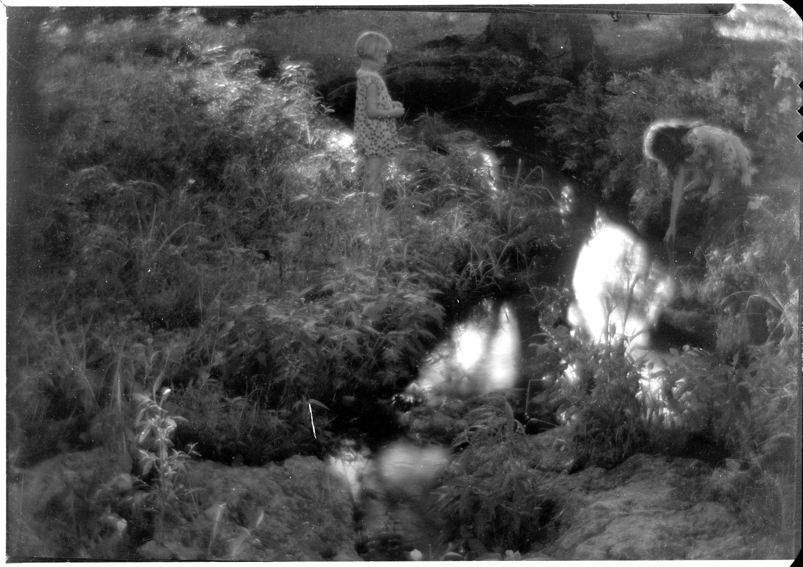

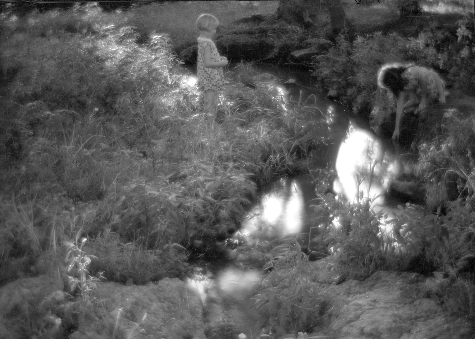

It took me a long time to get around to this, but I wanted to come back to this thread, report on my initial steps, and thank everyone for the guidance. I ordered a package of the dental duplication film--it came in 5x12, so I can trim one sheet down to a 5x7, a 4x5, and a small leftover strip.
My first trial negative is attached. The original (the cleaner and slightly lighter attachment) is a 5x7 taken by my great-grandfather sometime in the 1930s. I followed Jeffrey Glasser's suggestions above, working under a red safelight.
With the enlarger set up approximately as if making an 8x10 print from 35mm, and the lens at f/2.8, I exposed for a minute, then developed for four minutes in HC-110 dilution B; water stop, fix and rinse as usual. (The film has a blue base, and it's quite opaque until it hits the fixer, when it clears almost instantly--it's not so easy to develop by inspection, and I'm not confident I've got the ideal development time.)
The results are better than I expected the first time out. I seem to have a bit of a dust problem, and in one place I scratched the emulsion side, probably while cutting it down to size. To the naked eye the negatives look pretty close, but I'm not sure I've quite dialled in the same contrast; I haven't been able to get the shadows of the duplicate to match the original yet. Research continues.
Thanks to everyone; I had no idea this was feasible, and I'm still pretty blown away by a film that develops as a reversal in ordinary chemistry. I'm not sure--will extending development get me more contrast, or less?

You can make a test negative as you would for a print to see the amount of exposure. Remember the more exposure the lighter the negative and the darker the print. You can burn and dodge areas for desired.
I use the enlarged negatives for platinum/palladium printing and normal developing times have been good for contrast. If need be you can modify contrast when making the print from the negatives
As I had mentioned it takes a few tries to find your groove. Once you do you will like that technique. Your first attempt looks like you’re on your way.
