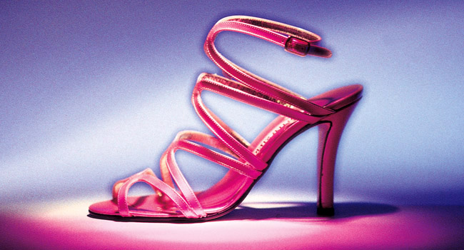

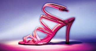

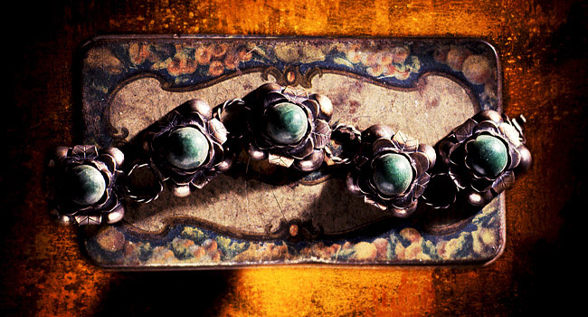

Always a fan of grain, when Photoshop started to become the norm I wanted to develop something all-analog; I settled on 35mm 320T tungsten, pushed three stops, using a multi-exposure process to get random "analog" shadows and blends that went beyond the control and perfection of Photoshop.
I learned a tremendous amount from this project about partnering with your materials (or lenses, light and color) rather than having absolute control, and I learned huge lessons about leaving space in your plans for creative surprises - gifts-from-the-gods kind of thing. But anyway, I wanted a way to show those images to clients in the mounted transparencies and lightbox days.
I asked the lab if they could dupe on 4x5 Velvia or EPP for even more kick from the colors. They said it was impossible and wouldn't work, and they weren't willing to try (and this was a big pro lab in Dallas!). "Impossible" always gets my brain going though...
My enlarger at the time was a lowly Printmaker 35 with the stock Beseler B&W lens. But I replaced the condenser door with a black cardboard sheet which had a $5 hot shoe flash gaff taped to it (daylight, get it?). Using a 4x5 polaroid back (remember 4x5 polaroid??) I was able to calculate exposure and lighting, and I used ND and color gels in the filter slot to control everything. I managed to create a large portfolio of 4x5 and 8x10 transparencies, duped to Velvia, EPP, and even 64T sheet film.
I suppose these days one would have to make do with Fuji's 100c pack polaroid and do some exposure compensation tests (but even in the days of pro polaroid, there was always compensation one had to memorize on set). Here's a few scans:

Yes, this was a pos-to-pos process; E6-style slides to E6-style sheet film, basically a transparency-dupe-enlargement??
@Analoguey - the 35mm film was processed at the lab; these were 3 stop pushes, and bracketed 1/3 stop, so snip tests were done on all of this work. I used 64t polaroid when shooting the 35mm, and then calculated exposure for the push based on the 'roids - I think I had a lot of notes on that. (Jeez - can you imagine a time when there was 64T POLAROID???)
The scans above were Heidelberg drum scans I used for print marketing - all these were 4x5's except the shoe which I duped to 8x10 EPP. It's pretty striking on a light box. I love how that grain has an almost pastel-on-paper texture.

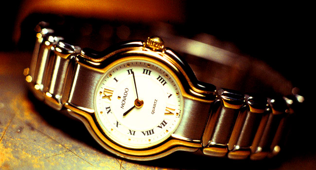

The watch shot was my one go at processing E6 (I processed the dupe, not the original slide), 4x5 in a plastic tank. At the time, I was at the lab once or twice a day it seemed, just didn't seem worth the DIY hassle but wanted to do it once - and I still have the tank & stuff.

I found that Velvia and EPP really preserved detail, color and grain. Shadows were already pretty intense due to the pushing and contrasty, hard light shooting style, but highlights, transitions, shadow detail - the whole thing was a pleasant surprise that my lab said would be an utter failure. I really didn't need to do anything other than stick things in the enlarger and blast the flash.
I was just using a lowly Printmaker 35, but also found I could dupe onto 64T 8x10 sheet film by sticking some CTB gels in the condenser (since the enlarger lamp was much warmer than 3200k). This allowed dodging and burning - which could get pricey when using 8x10 polaroid to setup exposure! But generally, the slides I shot had been very dialed in for shadows and lighting "design" and just needed duping. I did find the 64T had a really lovely softness to the color that's hard to describe. Still very saturated but a different feel than the daylight films.
I do remember Agfachrome 1000 - I believe I art directed a vintage-look accessories book for JCPenney and we used that for several shots. Kind of freaked the marketing folks out that we had grain in full-page images, but it was really a lovely look and fit the theme perfectly.

That's all certainly true... but (as per the attachments above) much of this project's visual theme was grain and color intensity, (along with double and triple exposure techniques to create more organic shadows and glows). I never duped anything where I was trying to hold accurate skin tones or product colors, for instance. I think in hindsight I would have automatically gotten standard lab dupes for images that were more naturalistic, in this case the duping became part of the process and final image.
That said, the dupes are surprisingly consistent with the originals, though the Velvia dupes " go to eleven" as Nigel Tufnel might say (gratuitous Spinal Tap reference).
Here's one with a human being... but the original was 320t, 2 or 3 stop push, Speedotron head with full CTO (with tungsten on the back wall and likely 1/2 second or so exposure to blur the wall). Nowhere near reality, but across a couple years of doing this work, there's a commonality across the images - something I'm generally too ADD to achieve!
