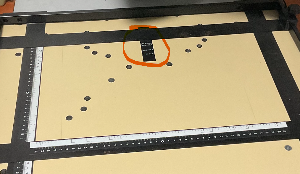

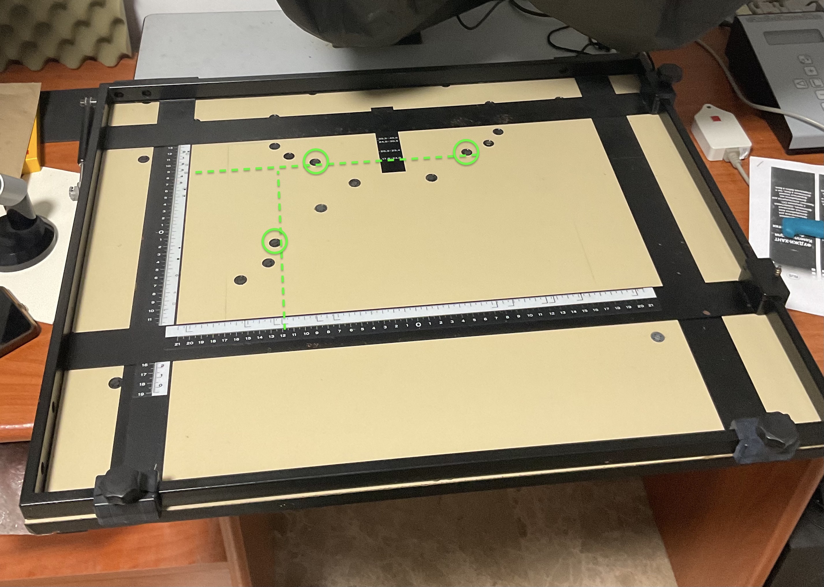

I have the same easel. The first guide for positioning paper of different sizes is circled in orange below. Next, twist the spring-loaded stoppers to release them. They will pop out - two at the top and one on the left side. Finally, adjust the blades to set the borders as desired
