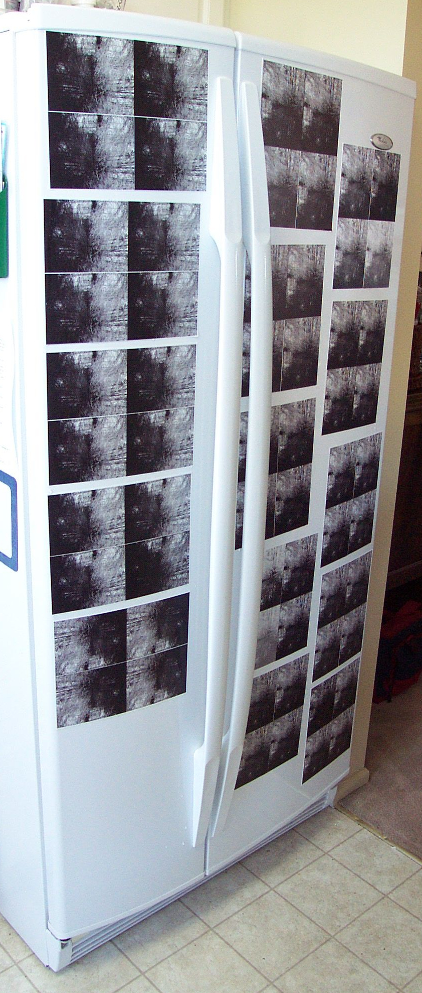

I squeegee RC prints onto a cleaned refrigerator door.
Then after a few minutes I remove them to air dry in a rack - which started life as an LP storage rack.
From a postcard exchange about 15 years ago:
