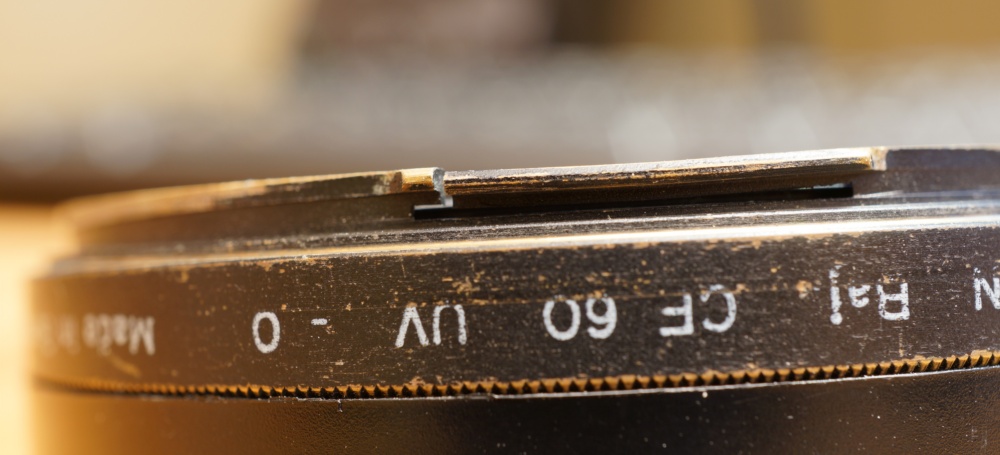

The B60 filter mount does not click or snap into place, it stays on with spring loaded friction, which is supplied by the tabs on the filter. The tabs often get bent out over time so the filter becomes loose. You can bend them back with your finger, or use a tool (like the handle of a screw driver) to press them in a bit more so they are tighter.
attachment.php
you can see the tab has been bent in a bit on this well worn filter that I leave on my CF250.
For filters you want to leave on the lens you can make them fit tight. For B&W or IR filters that you want to leave off while you focus, you can set them loose so they go on easily without jogging the camera.
