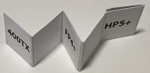

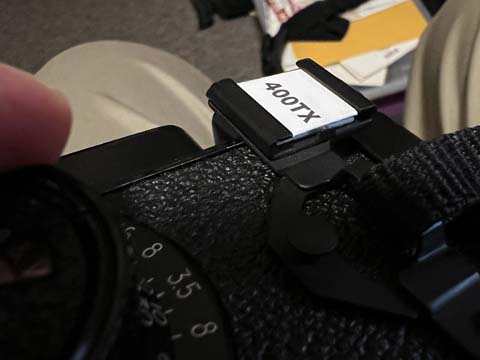

With a laser printer -- or quality inkjet -- one can make a little accordion-folded strip printed on index stock to slide into a cold shoe. Make enough sections to make the folded widget thick enough to stay in place. With a color inkjet the possibilities are unlimited!
(Installed in my Yashica Mat 124G)
Of course, if you actually use the cold shoe, my idea may not be so handy. ☹️
(I hardly ever use it.)
(Leave at least one blank section to switch to when there is no film installed.)
