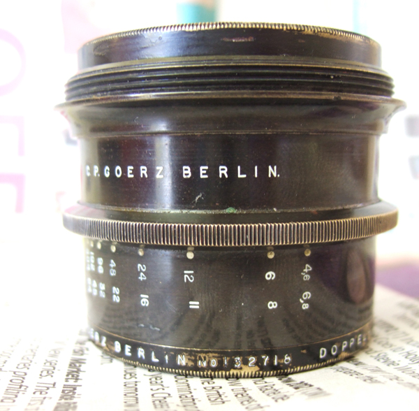

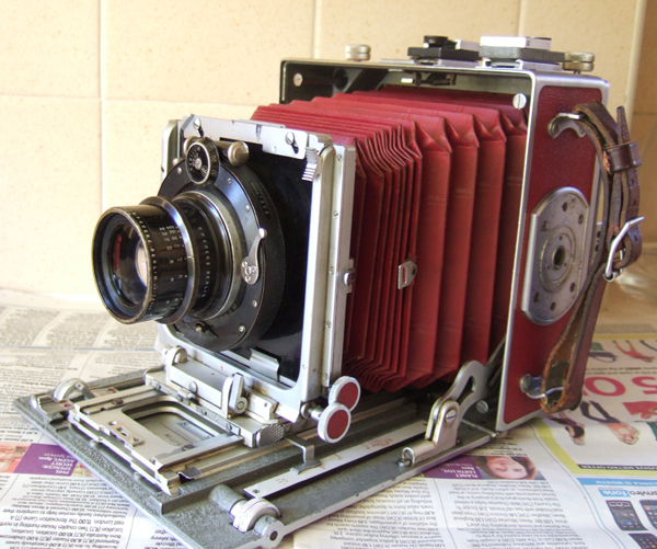

I was lucky enough to be able to get to Photographica in Victoria, London this year where I bought this lens. It is marked 'C P Goerz Berlin No 132718 Doppel Anastigmat DRP No 74437 Series III No 4 f = 240mm'. A nice find particularly as it came mounted in a compound shutter and attached to a MPP lens board. What I have not seen before is the dual aperture scale:
Scale 1 (outermost) reads 6.8, 8, 11, 16, 22, 32, 45 and 64
Scale 2 (innermost) reads 4.6, 6, 12, 24,48,96, 192, and 384
Scale 1 is the one we are now all familiar with and scale two is understandable as a simple arithmetic progression representing a halfing or doubling of transmitted light depending on the direction in which the aperture ring is moved. At first I thought these might be U.S. f stops as seen on many of the early Kodak cameras but the equivalent values are different to those I was able to find in my searches, for example the U.S. equivalent to f 16 is 32, not 24 as here. Then I found a reference to Goerz stops but could find no further information.
So my question is (after a rather long-winded preamble) can anyone confirm whether these are indeed Goerz stops and if so, how are they calculated?

U.S. 16 equals f16, and US numbers either halve or double from there. Example; us32 equals f22, us8 equals f11.

Based in the reference in post #2, the second scale is Georz.
