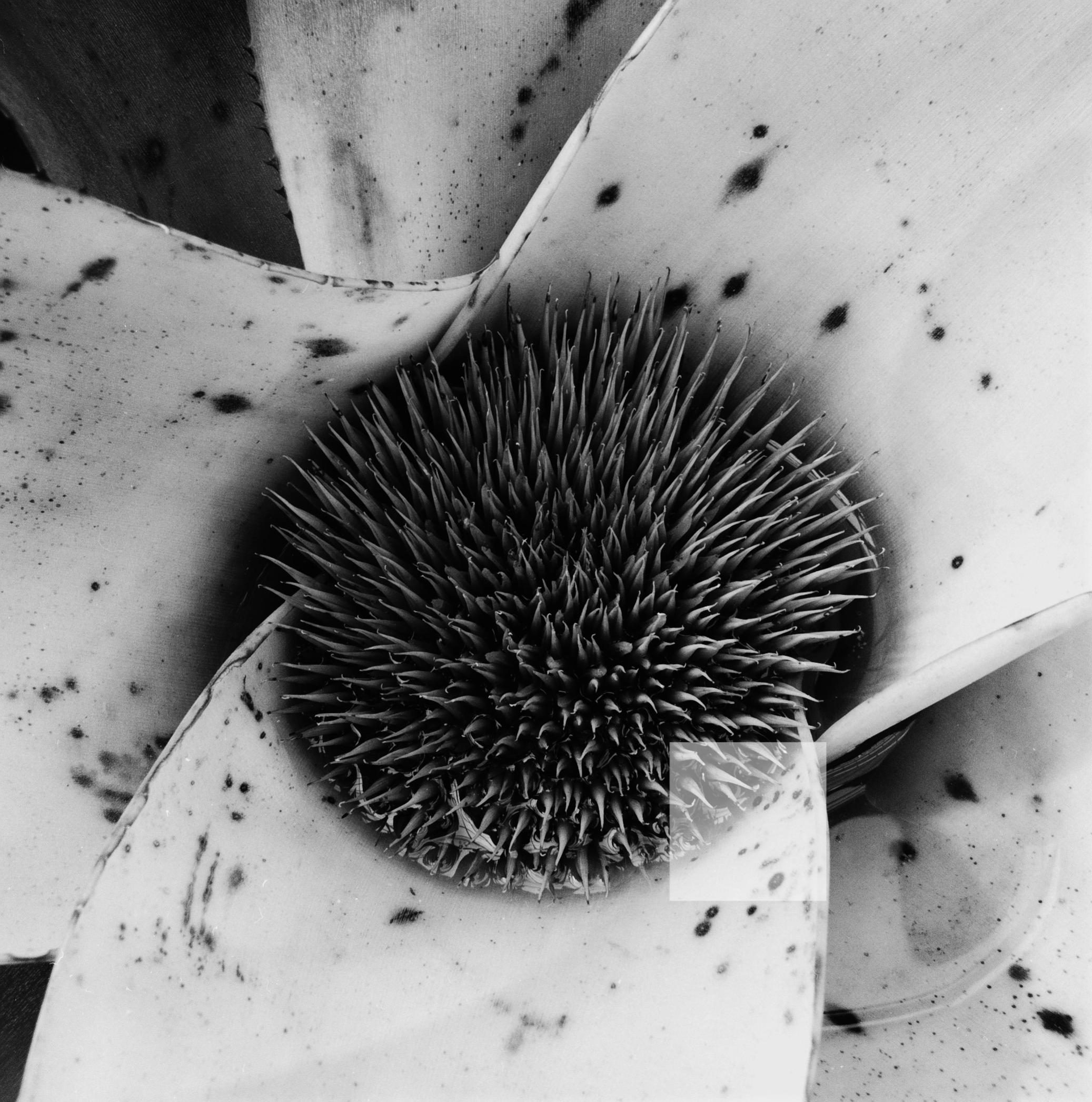

I just thought I would throw these in for the sake of discussion. I use 2 1/4 and 4x5 and mostly print in the darkroom silver-gelatin and pt/pd but I frequently scan my negatives rather than making proof sheets. I do print digitally up to 13x19 with some of the scans. The examples here are an un-altered positive of a 2 1/4 negative and a 1/2 inch section enlarged to 6 inches using my (old) Epson 4870 with Silverfast Ai studio software @ 1200 and the standard film holder that came with it.
