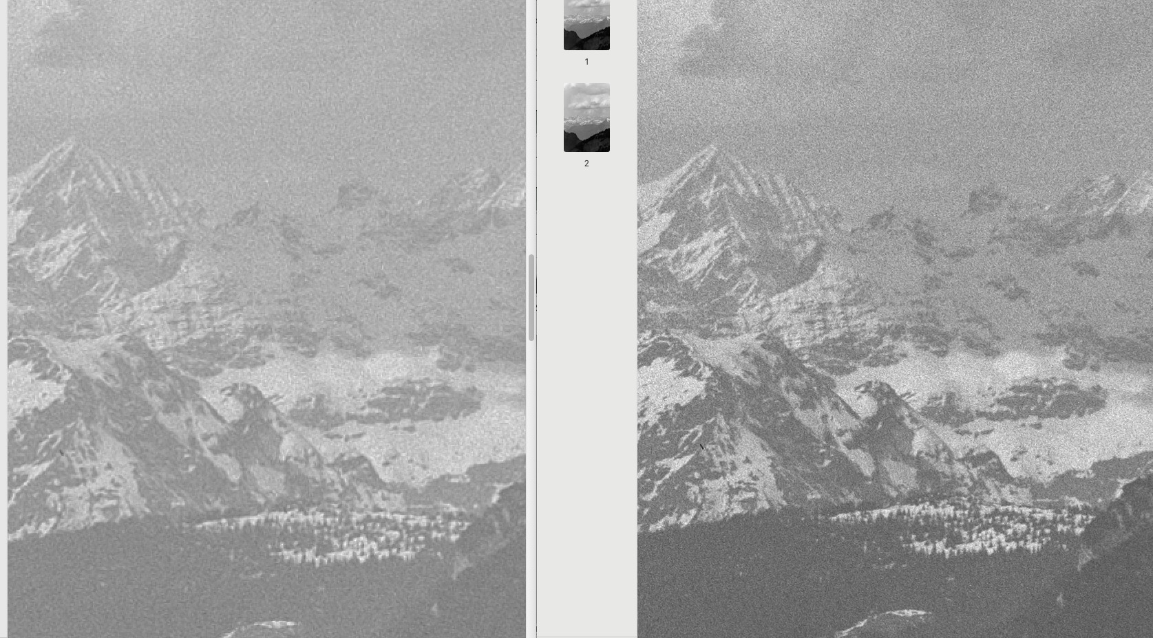

I did a 1:1 Magnification to see how much Detail there is, here is the Result:

I've done DSLR scans of 12 shots and stitched. It works pretty well. There's a lot of info in there.

I will digitize most medium format shots as a single image except a select few I want to get extra detail out of. It does take extra time and care to do the stitching work. Not feasible for 30-shot rolls of 220. But not so onerous for large format.
However, an old Epson flatbed at 2400dpi should get you more detail out of a 4x5 than 3 stitched D700 images. I think to compete with it in detail you'd need about 12. The DSLR will probably get you a better usable brightness range though, which could improve the look of slide film. DSLR digitization really shines on the smaller formats.
