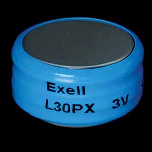

Maybe Donald will concur, but I power my Minolta QT with a common CR2025 3v lithium in a housing like this. I'd think something similar with two 3V lithium coin cells might work.
I think it's longer than that

That's a single 3V lithium cell, so to get 6V you'd need two of those. Those coin cells come in a wide variety of thicknesses, too, -- the first two digits are diameter in mm, last two digits is the thickness in tenths of a. Actually, I had a lithium cell that completely filled the battery compartment in my QT -- quite a bit bigger than a 2025, I think (replaced two alkaline coin cells). Unfortunately, either the cell I was sold was bad, or the electronics in the camera were completely dead (I presumed the latter).
I'd rather see anything originally made for rechargeable batteries use rechargeable batteries down the road, however -- if it had NiCd originally, NiMH is the preferred update. Chargers aren't hard to modify for the connector on the device.

No, not two of those, two of the cells within that, in a simple housing you need to construct.
The Excel is a cardboard tube and heat shrink tubing. Nothing really special.
