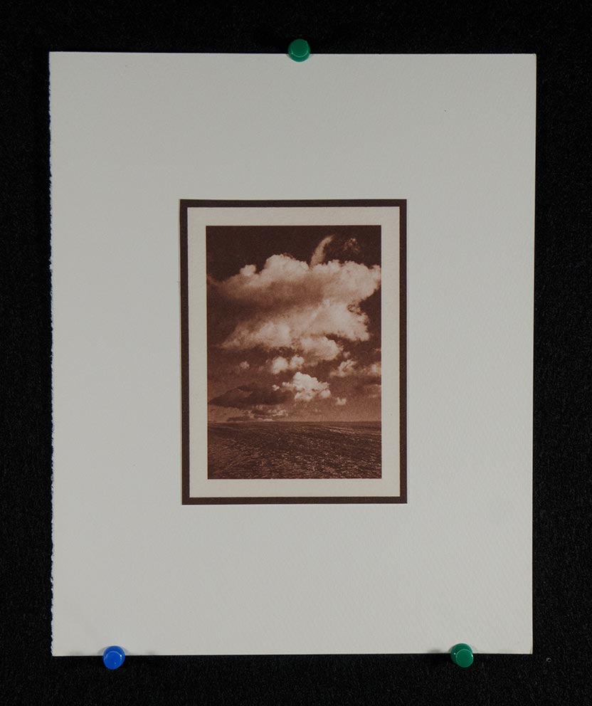

I dunno....I am kind of partial to dry-mounting. I wouldn't be overly concerned about heat doing anything to the gelatin sizing - after all it was a de-facto standard for silver gelatin for all this time. I use this low temperature, supposedly reversible and archival tissue called BufferMount (not sure if this is still around, I have had it with me for at least 20 years.) Mounting temp is 177oF. Just the other day I did a trial run on one of my cuprotpye test prints - I mounted it on a 8x10 piece of 320 gsm watercolor paper. Here is how it looks:
I think this is a better way to store prints if you don't want to mat/frame them and also not have them around loose when you show them to people.

Mr Patel, thanks for the thoughts and the excellent example. I will look into dry mounting a few of the ones I have made. I like the idea of using the heavy 320 gm watercolor paper - I have some WC paper that was gifted to me by an "retired" watercolorist. What I need to find is a dry mount press I never really needed one for my inkjet prints, but these alt process prints are very different. BTW that is a beautiful print - not familiar with cuprotpye process, however I will have to look into it. Right now I am just beginning my exploration of VDB and Kallitype.

Excellent, Niranjan…great info, and I do rather like the “fillet” look with the black border.
Yeah, I thought may be it will give it a 3D look. Cutting it precisely is a delicate operation though. I used a razor blade and I can see it going astray and ruin the print.
:Niranjan.
