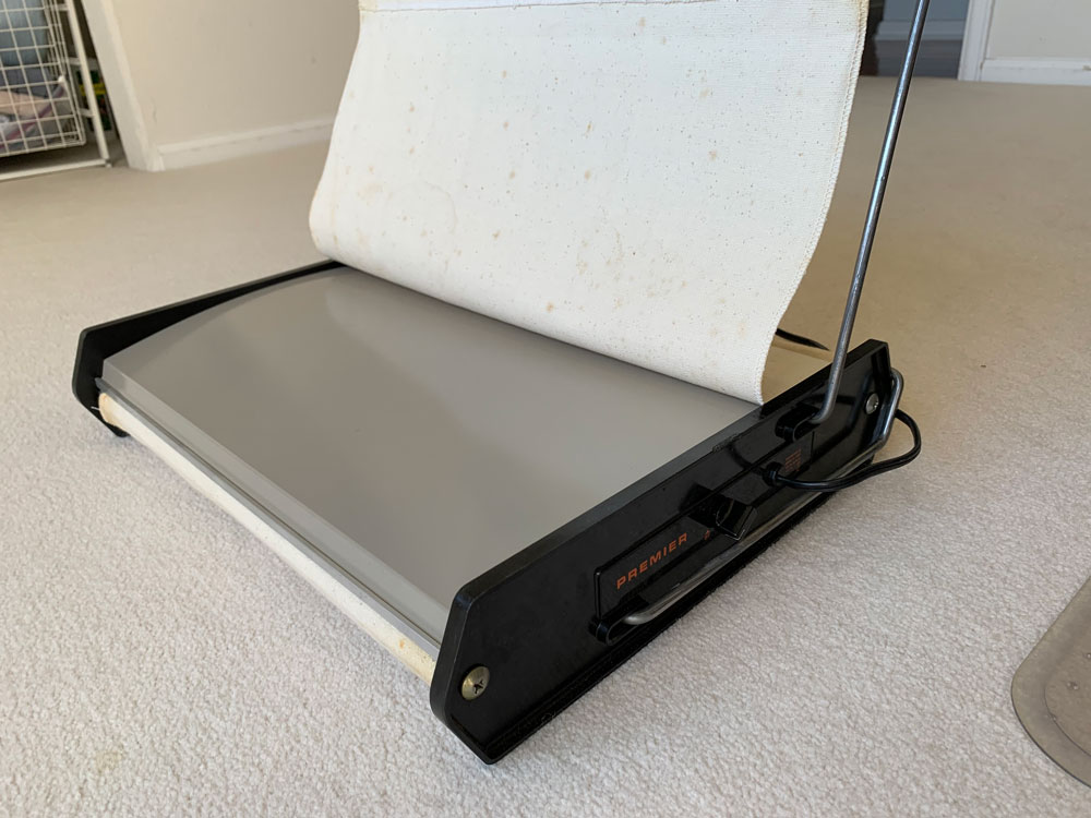

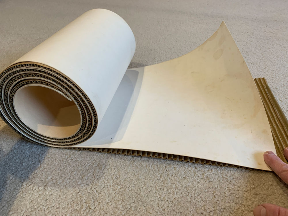

I am preparing to start darkroom printing for the first time since spending a couple nights in a college darkroom in 1975. For now I will be using the new Ilford MGRC for enlarging and Harman Direct Positive Paper (FB) for in-camera 4x5. I have 2 methods for drying available, a Premier canvas-covered heated drier and a Kodak muslin-lined fiberboard rollup style. Any thoughts, tips, comments, etc?

I have a canvas dryer, in the past i used it for high gloss finish, I have stashed away for blotter book, last time I used it was a few years ago when out out side temp dropped to the 40s, not that often in the low desert. My current method is us RC for high gloss, FB I dry on screens which can be stacked for a total of 12 11X14 or 24 8X10, The issue with both the dryer and blotter paper is continmation, the canvas can be washed, but use wash in hot water as you dont want the cloth to shrink. With racks all I do is hose them down after the prints are dry.

RC paper is designed to be air dried. Do not try to use the canvas covered dryer for them!
