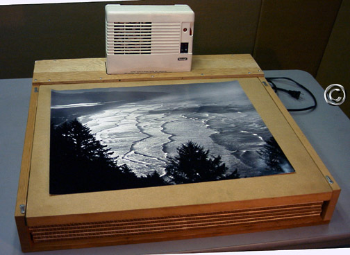

Reinhold
Advertiser
Aug 20, 2003
911
Washougal, Washington
