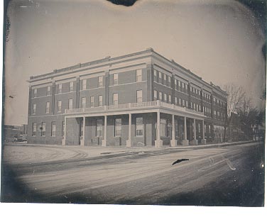

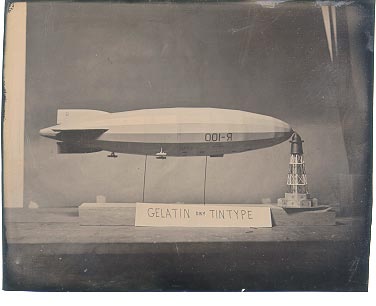

Here are a couple more examples of the dry process for tintypes I have been working on.
I like them. Could you provide some more details on your process? Are you able to coat a plate, take it to the field to make a picture, then return to a darkroom for the chemical process?
Bruce
Yes, the plates are coated and stored untill ready for use. The emulsion was home made, from Kodak AJ-12 instructions. The silver was added all at once rather than over a 10 min. time span as directed. And used Photo gelatin with the addition of
.02 % soluton of sodium thiosulfate as a sensitiser.
Exposure is about 1/2 sec @ f:16. in sun.
Development is with Dektol 1:1, Potassium Thiocyanate 1gm per oz. of developer. (Ammonium Thiocyanate can be used also but produces an ammonia odor as soon as the plate is put in the developer,it also gives the picture a more yellowish warm tone and slightly brighter.)Develop 90sec. - 2 min. I have found the 90 sec. development time better as the plate does not accuire as much fog or sediment deposit. Also, the Developer can be used full strength.
Rinse. fix, wash, dry.
I use 1/6th plates for testing so I can make up a whole bunch and burn'em up to get an idea of what they will do.
