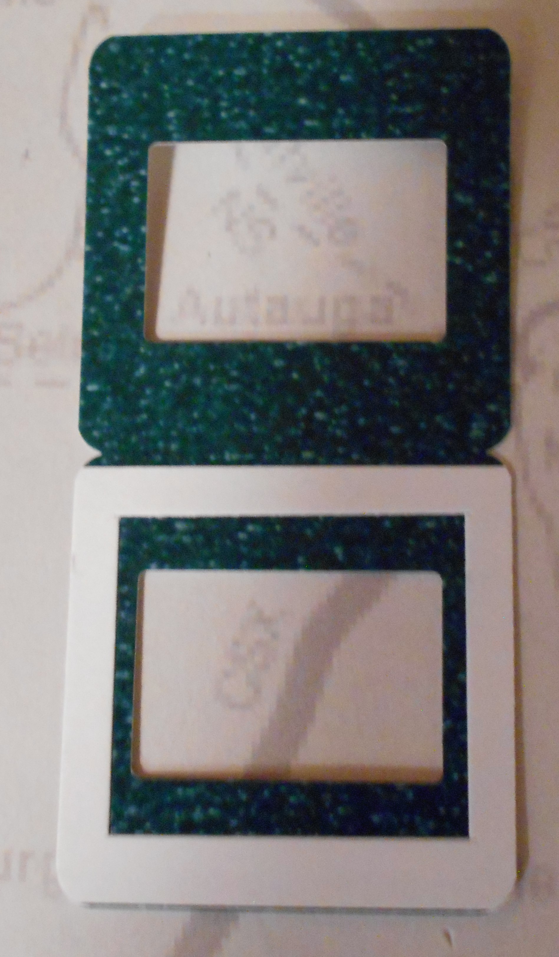

Does anyone know what type of adhesive is used in heat-sealed cardboard slide mounts? Since no one is selling this mounts at the moment, I have been looking into making my own mounts. I am trying to make something like the Pic Mounts that B&H was selling until recently. I have decided that the cardboard portion of the mount is 130 lb cardstock, but I can't figure out what material was used for the "square" that goes on one side of the frame to seal it (it's the white part in the photo). It's got to be some sort of dry mount material that is heat-activated, but the dry mount film used for photographs is heated much longer than the few seconds a slide mounting press uses. The only thing I'm finding on eBay at the moment are highly overpriced old Kodak Ready Mounts.
I reached out to Dwayne's to see if they could tell me what type of adhesive is used. This is what I was told:
"I checked with management and they said, unfortunately we have no idea what type of adhesive is used on the slide mounts. Likewise we do not know any other specifics about the manufacturing as the company we originally purchased from went out of business over a decade ago. We are currently using up the last of our 20 year old stock and do not have replacement options available."
I was under the mistaken impression that Dwayne's was making mounts, but this is not the case - so they're in the same boat as the rest of us and I can understand why they want to retain their remaining stock.
I am going to investigate a material called "heat n bond" that is used by crafters. You can get it at Joann Fabric and Crafts or Michaels. It sounds like it might work, but I need to investigate to find out.

At one time lots of heat sealing adhesive was shellac - iron-on clothing patches, gasket adhesive, iron-on shelf edging, even early drymounting tissue. So that could hypothetically have been used for slide mounts too. But then other heat sealants came into play; so a lot might depends on when the mounts were actually manufactured.
But if you do go with a drymount tissue, realize that projectors can get pretty warm, so you might want to choose a higher temp tissue like old MT5.
