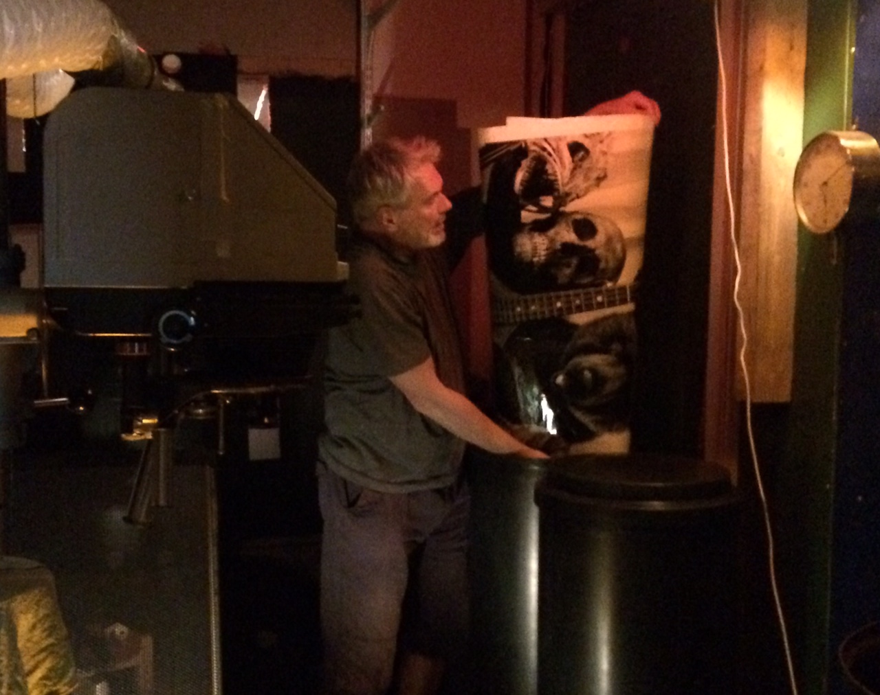

How I did it.
Thank you again for suggestions and comments - how time keeps comming - thought I would follow up in this old thread with my solution so far:
Got cylindrical tanks/drums, 40 inches high, some 16" diameter for developer and fixer and some 20" diameter for rinse etc..
Filled up 120l of developer (a mixed Soup of leftovers and new of many kinds) to a strenght of very approximately half recommended concentration, same with fixer. Stopbath 200l of water. Rinse 200l, hypo 120l and selenium toner 1:40 in 200l with a cylinder in center of tank.
Cut Ilford Multigrade Warmtone FB 36"x56", enlarged 6x9cm negatives 16-18 times. Exposure was trial and error of the day.
Rolled the paper gently up, sank it into dev. cylinder, stood with two long sticks and slowly carefully kept the paper in slow motion curling slowly around and it kept upright (36") all the time, 6-8 minutes. Less motion in further tanks.
Made three pictures in a triptycon in a couple of copies - will try and find out how to add photos in a post, I have also one of me in the darkroom handling a print. Felt like one of the witches at Shakespeare.
This was last autoom - kept dev. and fixer i the tanks with tight lids - dev. weaker but still active -removed some interesting fungi?? (black and white curly growth on fixer). This April I am going to partly renew dev. and fix and make some 34"x48" enlargement on Ilford Art300.
So this is happy time of a retired/pensionist, greetings from Lars
