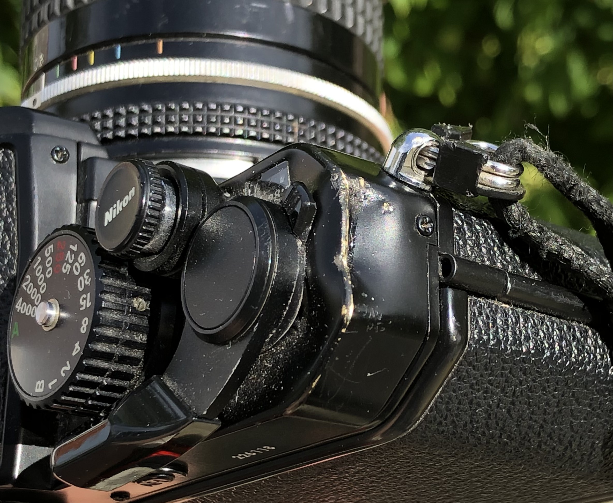

I dropped my FM3a the other day. It landed on the top right corner near the film counter and received a bump in the top cover.
The symptoms are that the film counter and multi-exposure lever are stuck and that the film wind action is no longer smooth. It is however possible to wind the film on, but the lever doesn't swing back as it used to. No other functions appear to have been affected.
I'm based in the Netherlands and will go to Nikon Service in Beverwijk next week. But out of curiosity i thought I'd post a question here to see if someone might know approx. how much the repair might be.

I'm afraid there won't be a replacement for the top cover, but you can try to bend it as much as possible.
That's what it's there for, to absorb knocks and falls 🙂
The parts underneath should have been protected by it and will probably be blocked or bent.
Nikon might say that they don't have any spare parts anymore, but they might not be needed.
I would therefore give this job to someone who deals with it and tries to repair it or has experience with cases like this, which should be a repair shop that looks after mechanical cameras.
But Nikon is definitely the right way to go first.

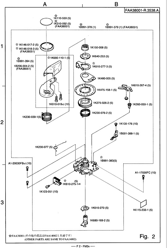

Richard Haw worked on the FM3A:
These are the parts that are under the top cover on the right:

The diffculty is to remove the cover and then reinstall it. When you have the cover remove you should be able to straighten it out good enough to clear whatever caused the binding.

Thank you everybody, I am very grateful for your help with this. My apologies it took a while to reply.
I managed to reshape the top cover so that the frame counter could turn freely, but unfortunately the multi-exposure switch doesn't fit well in the top cover. This means unfortunately that the film wind occasionally won't advance the film. I also noticed the light meter stopped working. So the situation is that the camera works perfectly in manual (minus the occasional film wind problems), but I fear it will cost quite a bit to have it repaired. I might sell it to someone who wants to tinker or just keep it as an occasionally-working manual camera.

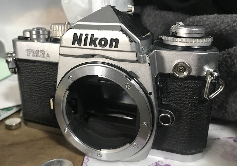

Anyone here may know better but the top cover looks similar to FM2
