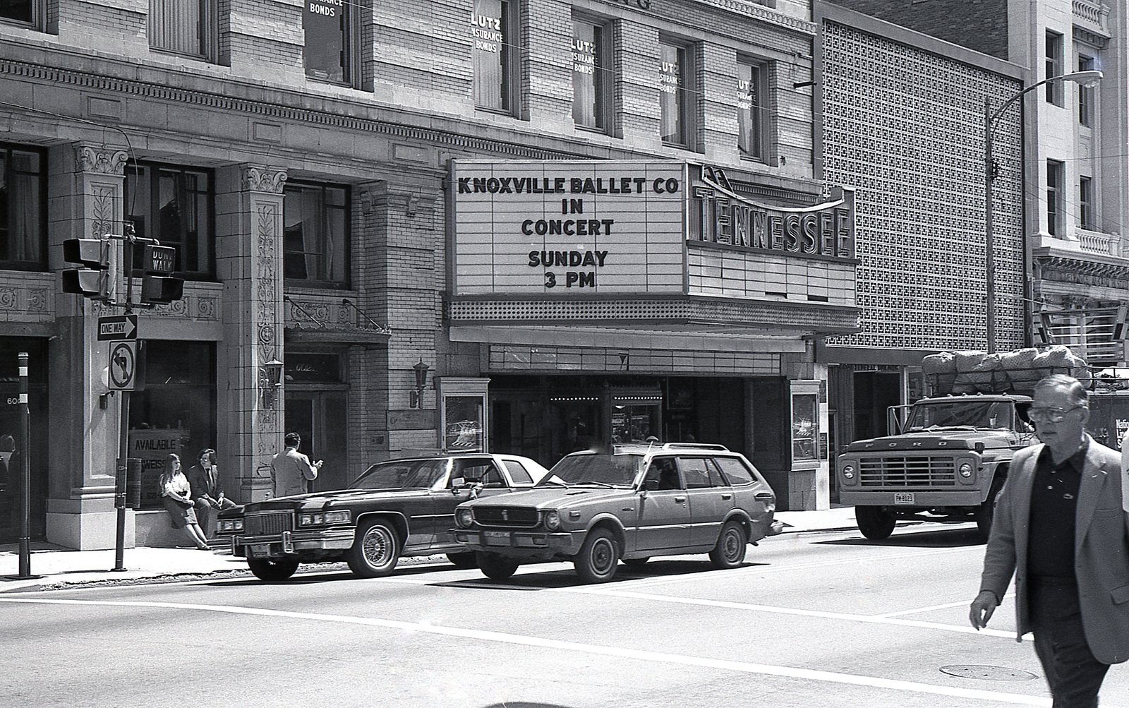

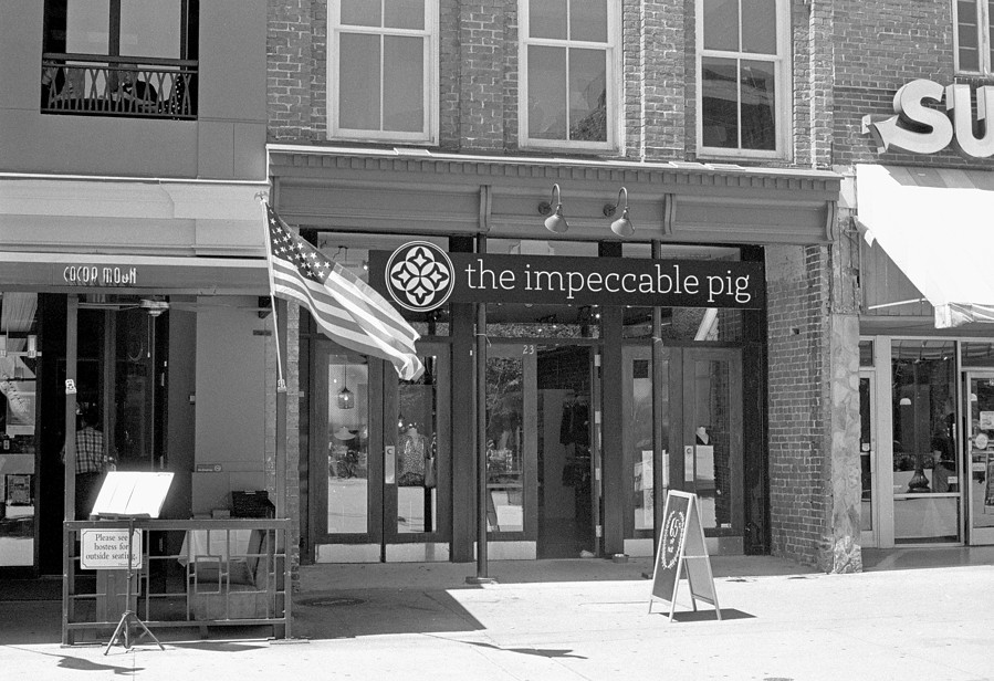

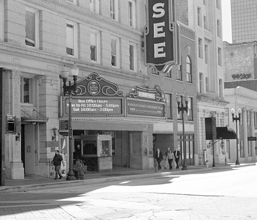

Some shots of the Market Mall area...It wasn't hot at 82 degrees but very bright all day.
Dntwn+009a by David Fincher, on Flickr
90 f2.8 Tele-Elmarit wide open.
Dntwn+011a by David Fincher, on Flickr
...and at f4
Dntwn+012a by David Fincher, on Flickr

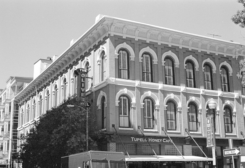

Dntwn+015a by David Fincher, on Flickr
Nothing looks the same downtown. I have more of the street and building on the Tri-X roll coming up.
